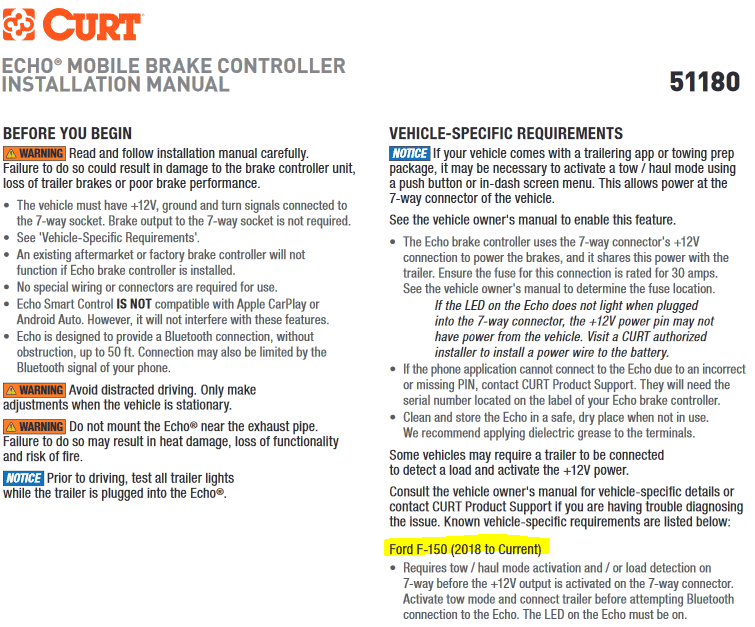

The curt doesn't need the phone to control it. You set it up with the phone and CAN use it to control the brakes if you want, but you don't need to.
There appear to have been some issued on first release with the curt Bluetooth unit, but they've been sorted. I don't tow much and if I ever need a controller I will probably get the curt.
It's not for everyone, but seems like a solid unit for those who just want something simple.
