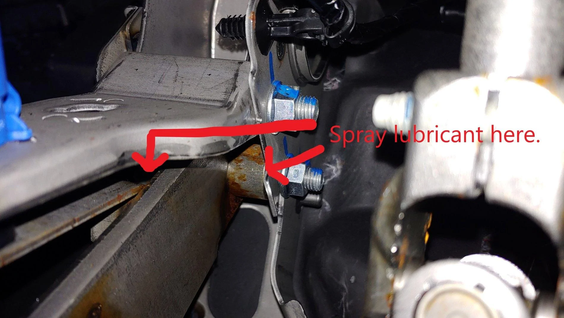

Most likely pivot point are either missing a bushing or needs to be lubed. Possilby it's the booster as well.
You're correct sir. It's the pivot point grommet. At least mine was.

This is a characteristic rubber boot squeak...There are lubricants in aerosol cans that can be sprayed up into the dash panel area around the pedal plunge rod and will likely stop the noise...I doubt a new booster will fix this. Do not use WD40...it is not a lubricant...WD stands for water displacement....A silicon lube is not going to last. You need a polyethylene type to try to see if it is effective. Friend with a Chevy HHR...Steering sounded the same. I took my Ford Polyethylene spray and coated the rubber boot. Noise went away and has not returned several years later. May not fix the noise, but worth a try in my opinion.

sprayed the heck out of the pivot areas both sides , the rod and clip that goes thru the firewall. with plastic and rubber safe silicone. still have it. i guess i will bring this up friday when i go in for the truck losing all battery power out of the blue and then fine 5 minutes later.

in one of these threads phil mentions spraying the rubber boot. it's not clear if he means the outside of it or the inside of it.
there seems to be some white plastic/hard cylinder thing that surrounds the rod that goes thru the firewall into the booster. the boot is covering that white hard cylinder. there seems to be no way to get lube up between the rod and the inner part of that cylinder as there is some sort of metal clip/washer there. that makes some clicking when i mess with it. as far as between the rubber boot and the white hard cylinder thing- i assume that's a bushing- can you safely spray silicone up in there? perhaps the rubber of the boot is rubbing against the bushing that surrounds the rod to make my noise? i don't want to do anything that ford will say caused an issue. i am going tomorrow morning for something else but would rather fix this myself if it's as easy as lubing between the boot and the white cylinder plastic thing it surrounds?

interesting update:
went to the store over lunch. creaking like crazy. is cold out like in upper 30s. headed back and i noticed that pushing the pedal down from the left part of the pedal was quiet. from the normal right side was still creaking. did that a few times, alternated from right side of pedal to left and it went away. if i put my foot on the side of the pedal on the right and pulled a little to the left as i pushed it down it still did it some. finally that went away too. i did have the heat coming out the floor vents over the 30 mins of driving.
perhaps the heat from the heater caused something to expand that's metal and took the noise away? perhaps the lube got just warm enough to find it's way into all the nooks and crannies enough to quiet it?
will know later when i go fetch me a burger for dinner.
