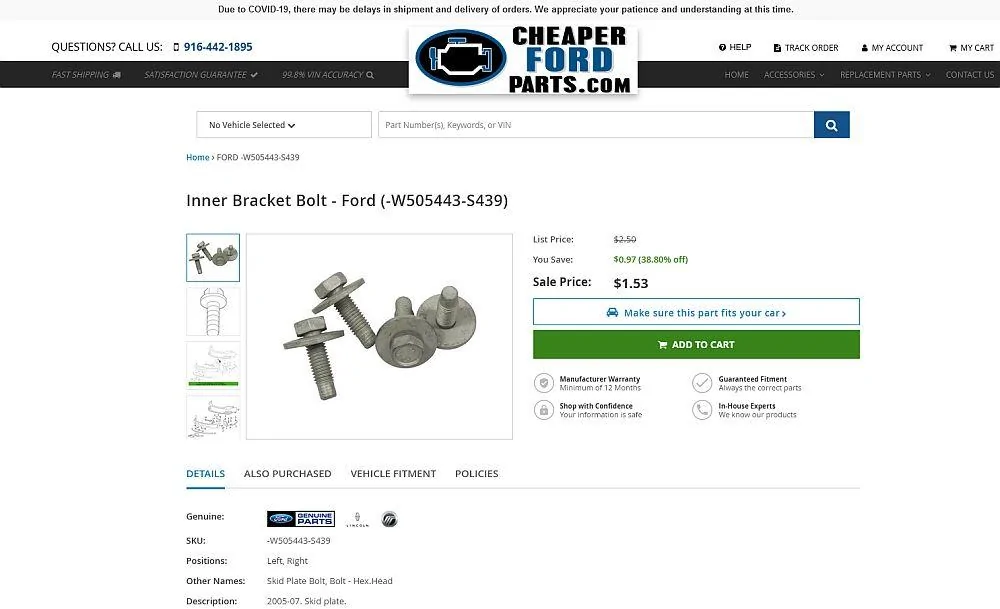

Does anyone know the bolt specs (thread and length) for the W505443-S439 bolts used to mount the FX4 front skid plate?
I'm adding the plate to an FX2, but don't want to buy the expensive Ford equivalents.
I searched, but can't find the actual bolt details anywhere...

Hi JB,
Since these are KEPS, with dog point and plated, I think $1.53 each is not a bad price for OEM fasteners.

Thanks Phil :)
Totally agreed on the bolt price itself; that's quite reasonable. It's mainly the shipping ($15).
Actually, now that I think about it, I have a collection of various grade 8 metric hex bolts (including zinc plated), and i could just test them out until i find the right thread/diam...
The one question of using different bolts would be the torque, as the KEPS bolt spec is already known at 22 lb-ft.

For anyone else interested, it looks like M10x1.5, and longer than ~approx 30 mm.

Hi BJ,
22 ft-lbs is probably a good number...It is enough to flex the captive KEPS washer and should work well for you with lock washer and flat washer... Not a super critical fastener, eh?
