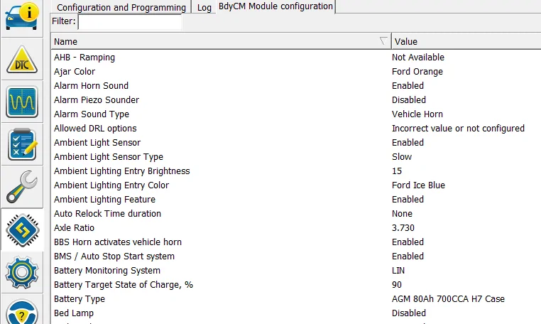

Can some one tell me where to find it in forscan so I can change the % of charge

BCM - Battery Target (State of Charge) %
Click on the line and enter a value then write it

I set my SOC to 95% now that I found it:sunglasses: I had Originally set mine at 85% a but a year ago and battery health was very good for a battery going on 5 years old..
