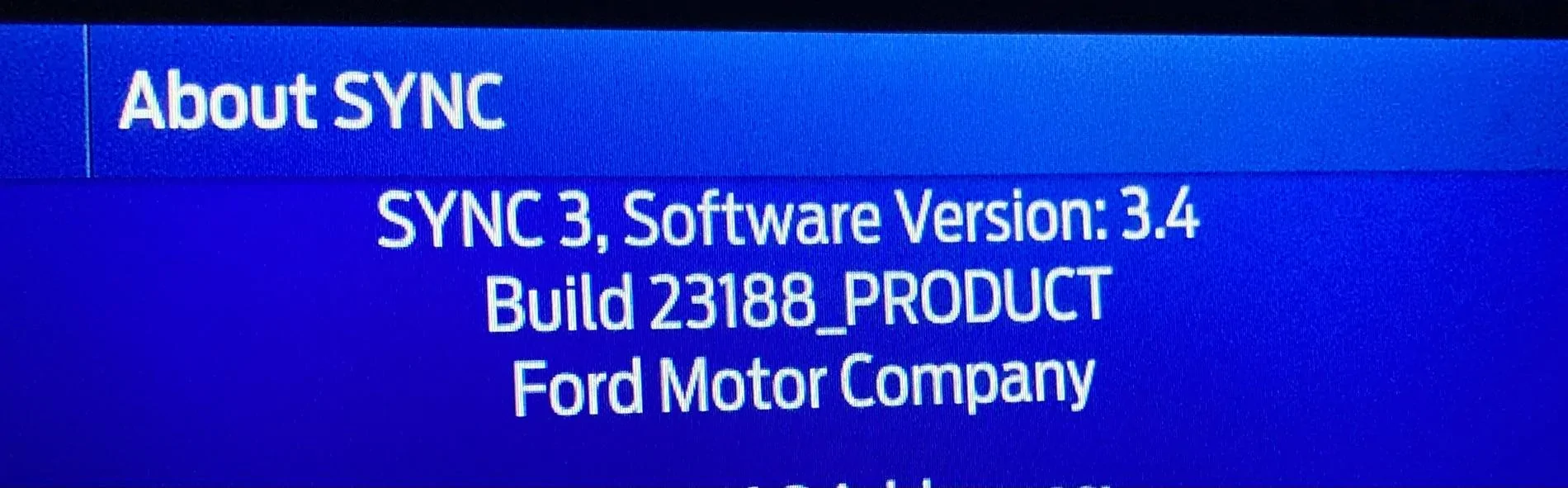

What is the current Sync Version? - should be vs 23188

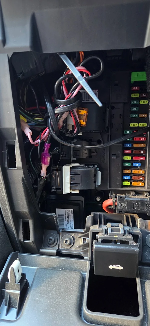

The only codes popping up is the P0128 which seems related to the thermostat open. I only picked that up with a MIL lamp in the last 2 weeks or so.
This is the dealer installed anti-theft: https://4yournewcar.com/security.html and I found the install guide here: https://www.directeddealers.com/manuals/ig/failsafe/n103t.pdf . Looks to be tied to ignition in the diagram, but it is functioning in my truck as a shifter lockout.
It prevents the shifter from releasing from park until the keypad code is entered. Once it is set to 'valet mode' which it was when I bought it, it stays out of the way every restart.
Now even when going to valet mode it will lock me out next time I start the truck. The manual bypass is to remove the truck shifter vinyl boot and press the plastic tab down - found this out the hard way when I first changed the battery and the thing refused to shift.

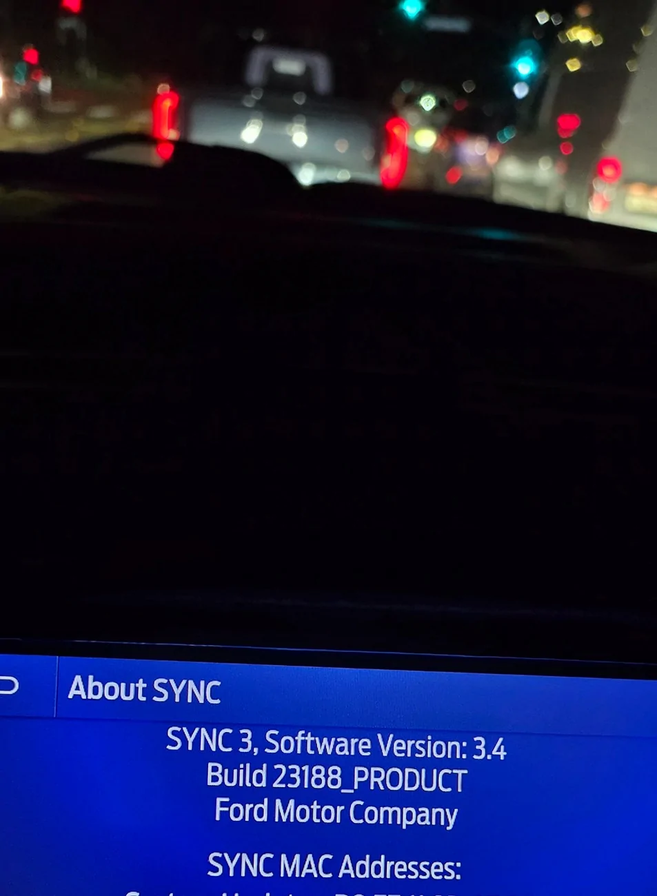

On the Sync side, it only tells me it's 3.4, even though the final revision is supposed to be 3.4.23188.

So, your screen only shows 3.4 and not the Build 23188?
Have you ever updated Sync (in the past) since you have a 2019 - you may have an early build.
It appears that you have a Sync system that got stuck (midstream) in an update and never completed. FYI - there is a recall for this (update) to 23188 from any previous version as they were problematic - If you are not displaying this screen - this is a problem
My build looks correct. Wish the Master Reset actually allowed me to reset and try again.

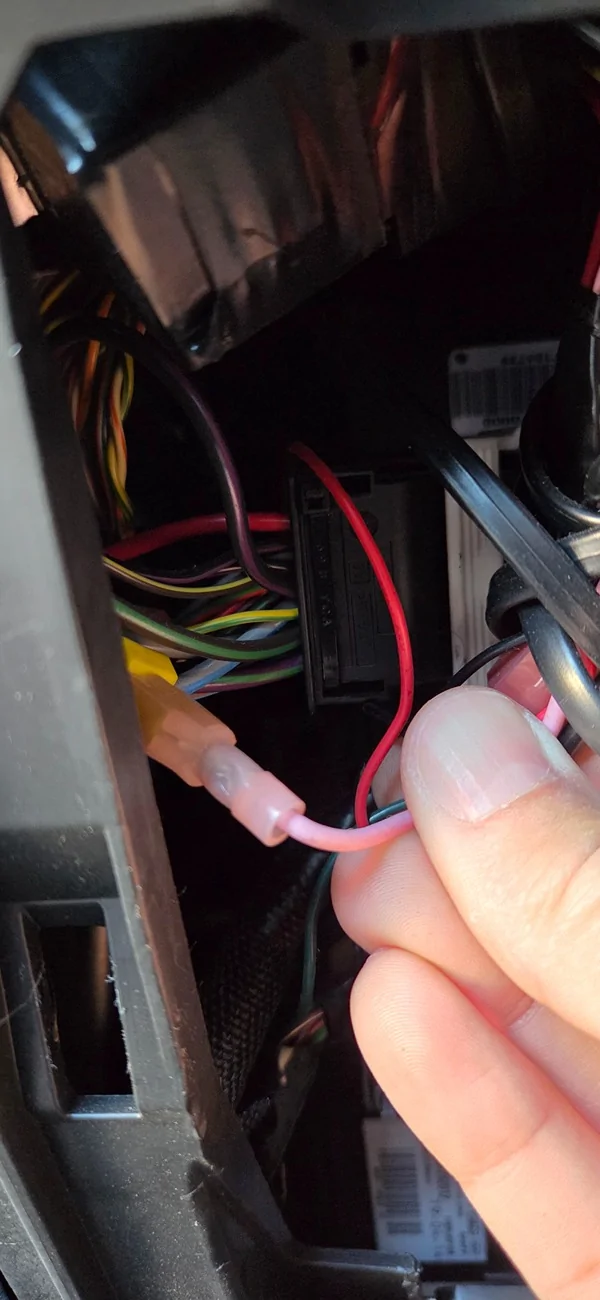

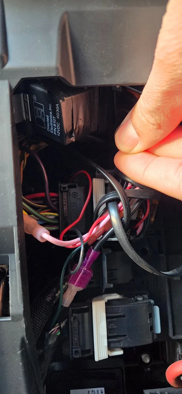

I would disconnect the - Security Module, I think it's keeping the Can Bus awake (HS-Can 3) the module is not letting the modules enter sleep mode
Security module:
The security module is preventing the CAN network from entering its normal sleep state, so it never sees a clean ignition-off/shutdown transition and therefore does not commit the valet mode status to memory.
APIM:
Because the CAN network never reaches a proper sleep transition, the APIM never completes its shutdown cycle where settings are written to non-volatile memory, causing radio presets, last station tuned, Bluetooth pairings, and other settings to be lost.
Even though the install instructions call out hook to constant power and ignition power and knowing that (Dealers) will rarely splice or tap into wires - they are most likely using an adapter off the back of the (OBD-Port) the Ranger does not use typical (Ignition) feed power, it uses Can Bus data for ignition state and I am thinking the security module (is not seeing that transition) state change to (Ignition off) and it thinks the ignition is still (in the run position) and this is corrupting the can bus data messaging

You might try removing the security device from the truck and see if the APIM (Sync) begins working normally.
The issue truly revolves around how the security device is actually wired into the truck and where the device picks up (Hot Battery) and (Switched Ignition) power, I have a hunch they are tapping into the (Can Bus) for that switched power as this is how the aftermarket modules wake the busses for remote start etc they wake the busses to get the module to power (first)

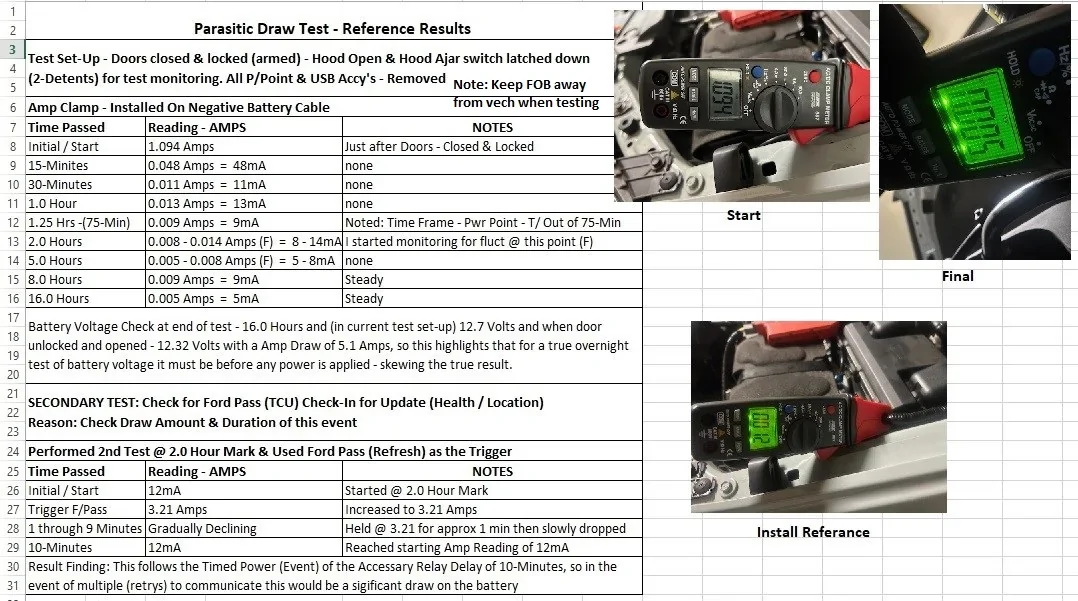

A - Parasitic Draw test may show - active can bus activity using my test results below which is in the Maximizing Battery Life - Thread - this requires an Amp Clamp - Meter
This was performed as a curiosity test of the system draw when the truck enters full sleep mode which is right at 8.0 hours and it resembles a normal system operation.
Pay attention to the - Test Set Up - Note
This is with the Hood Open, so you have to use a screwdriver to place the hood latch in the fully closed position (pushed down 2-detents) - just be sure to pull the handle in the cab and then manually push the latch - to fully open it (before you close the hood) after the tests are complete.
If you have anything higher than these readings suggests that the can bus is staying active as I suspect.
Summary,
Since I cannot 100% confirm my theory without testing the system as of now it's just that a Theory of what is actually happening by your symptoms and a draw test just may show it or reveal it and since the battery was replaced (did not provide reason) for replacement, I assume that you were possibly experiencing low battery issues which possibly originated from the can bus not sleeping issue.
If disconnecting the Security Device either lowers your readings or cures the APIM issues, then it's in the Security Device and then it becomes an issue of (either reprogram it) as it's a programming issue keeping the bus active or the module is internally continually pulsing the can bus for activity - keeping it awake, so it may possibly be resolved with a simple wipe the module back to (factory) and reset the modules programming, either way I highly suspect the issue in with the security device.

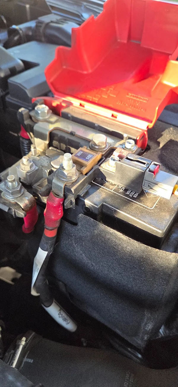

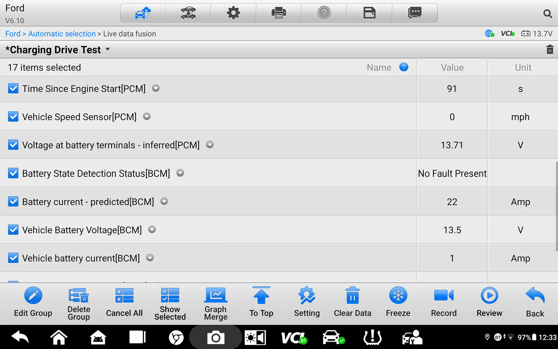

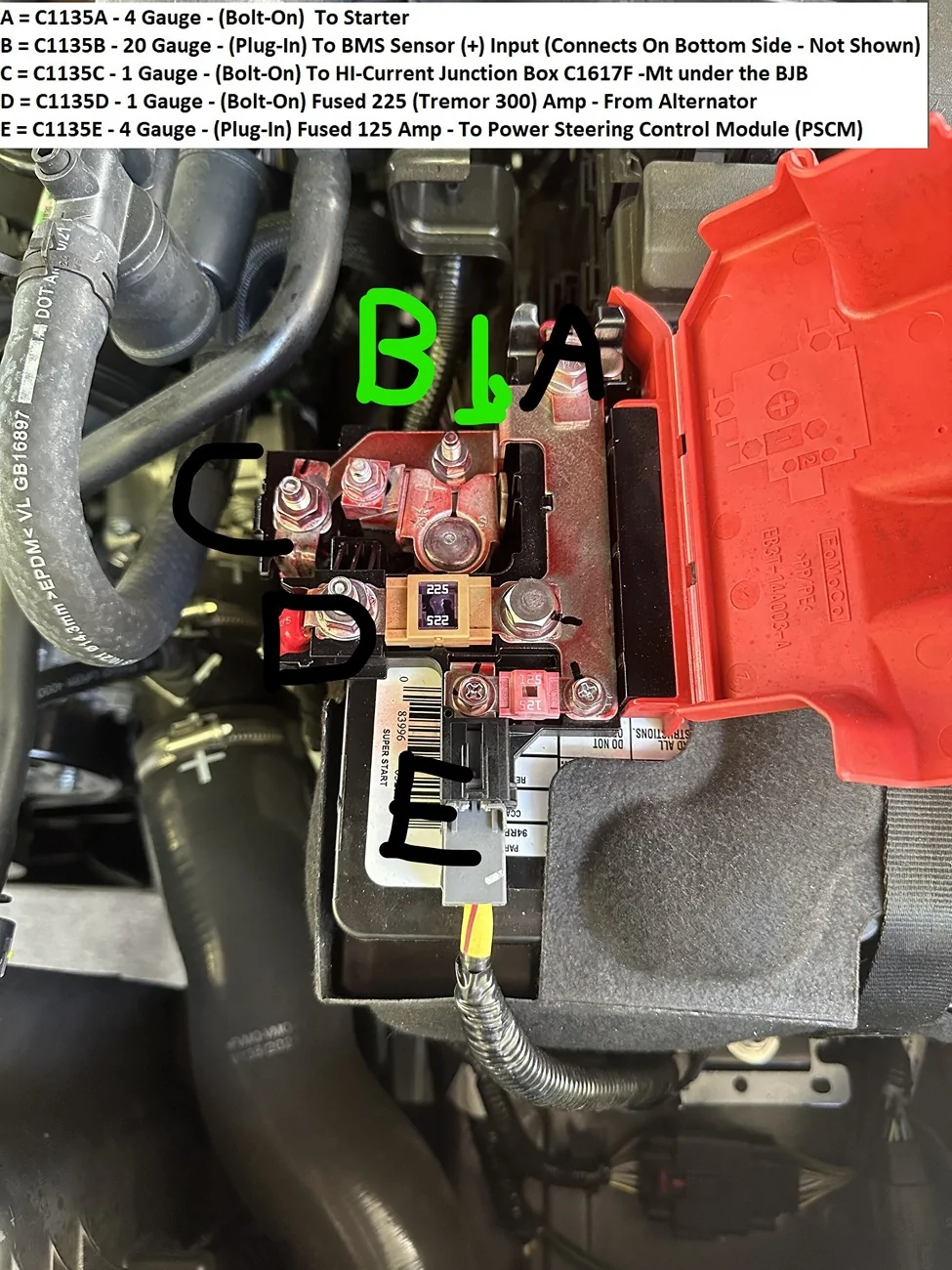

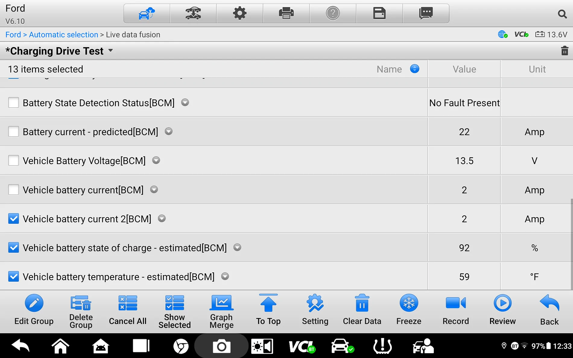

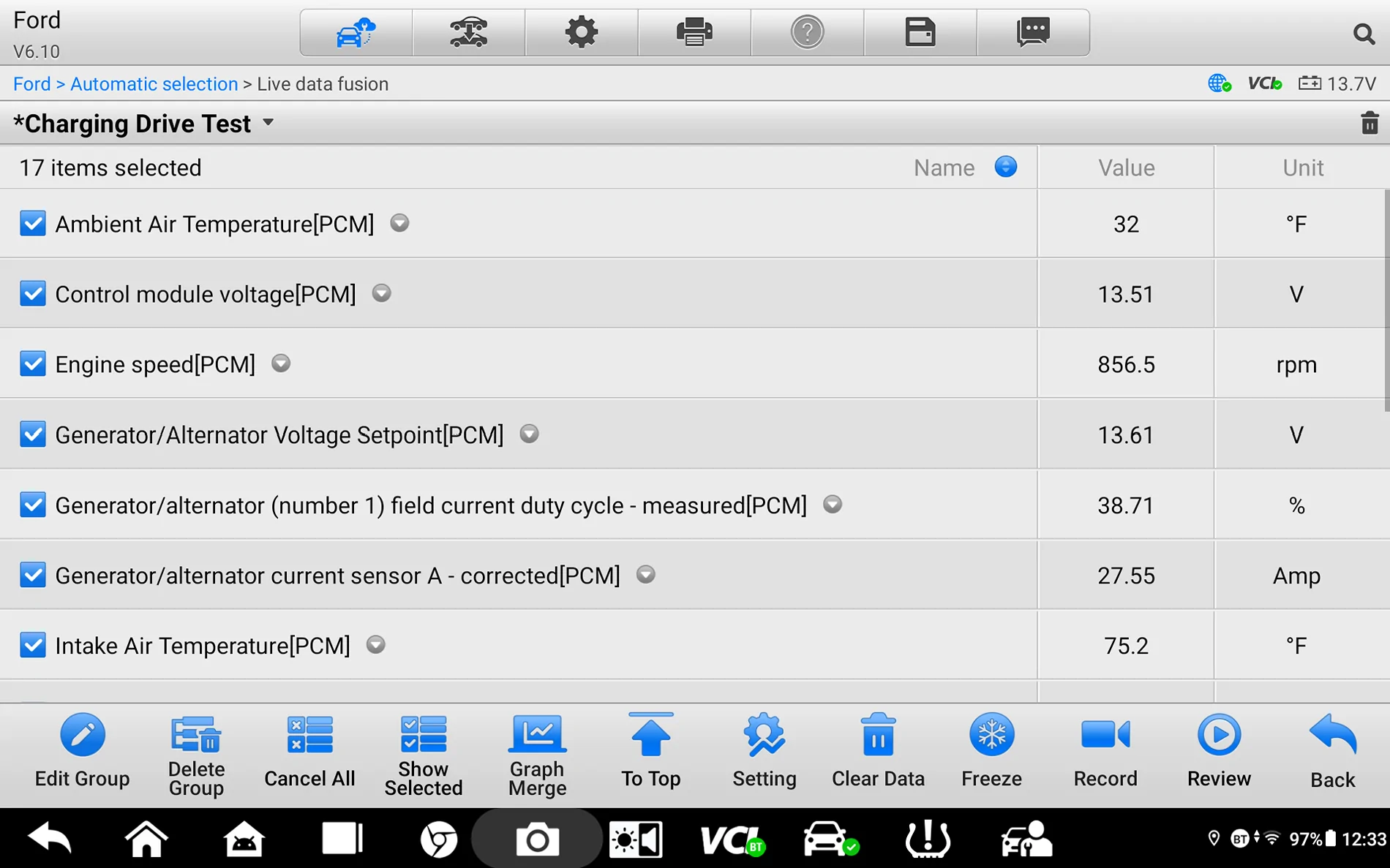

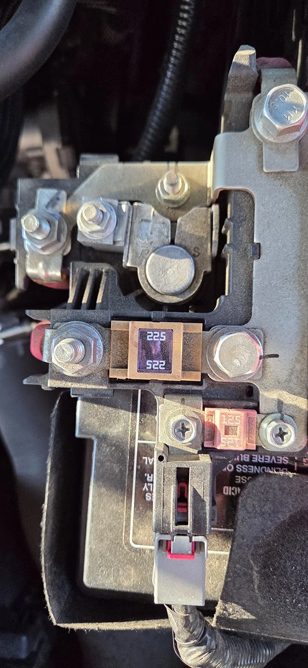

To cover the other possibility and that is the BMS sensor is triggering the issue, use the data below and note what your Estimated SOC is reading and also double check all of your battery terminal connections - ensure the little block on the positive cable is in the proper position and also insure the BMS sensor is properly connected, do not forget about the single (positive) feed wire that runs from the sensor over to the positive terminal of the BMFL.
This is also in the Maximizing Battery Life Thread
Slight: Note - the Battey Current changed when I scrolled down and took the last screenshot- Live Data - so this is why the 2nd and last pic show different values.
As i stated, since I cannot confirm how the security module is wired in for power and I am theorizing they are using the Can Bus, I wanted to back up and reset in case this is just a bad connection that was inadvertently created with the battery swap and the following highlights all of the connections
Ensure all connections are secure and note (Item B) is the positive wire feed from the BMS sensor and note the correct orientation of the small (wedge) block on the positive terminal and pay attention to (Item C) this is the feed down to the Hi-Current junction box that is mounted under the BJB and then another cable runs back up from that to feed the BJB

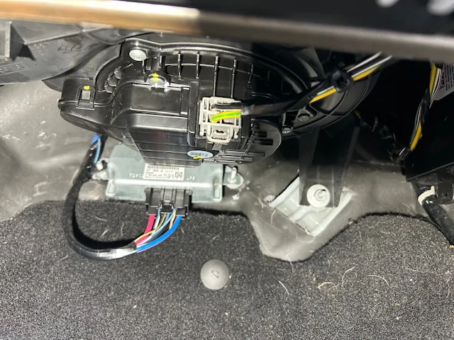

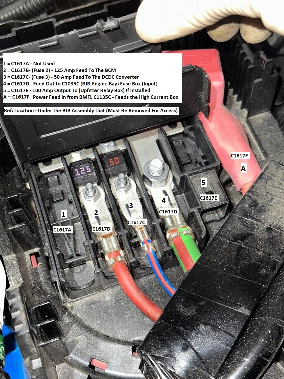

Again, this all depends on how they wired the security module in for power but if we dive deeper into the circuit wiring the power output to the APIM & Gateway Module comes from the DCDC Converter and it may be a possibility that the convertor module may not be producing a power source when the key is off or creating a voltage drop it would not be dumping all power as the APIM is holding (presets) - the GWM is the module that the OBD port is on and using the logic that they may be connected (power source) at this point for constant power might be a clue to your issues.
To refresh, the APIM has constant power (via) the DCDC Converter passthrough and when the (ISP-R) is signaled via the Can Bus it flips the logic switch inside the APIM to physically power it up.
So, it may be worth checking the connection here:
Mounted under the blower motor
This feeds 1/2 of the power feed into the BCM from there it feeds individual fused circuits such as the GWM and APIM - The 50-Amp fuse in the High Current Junction Box - feeds this module
The 125-Amp fuse in the High Current Junction Box feeds the other 1/2 of the power to the BCM
I am highlighting this scenario if the wiring for the security device is tied into this circuit the connection to the device can possibly be creating a (high resistance) in the whole circuit which is creating a downstream side effect on the APIM
So again - isolate that module out of the system and see what the APIM does.
With this inclusion, I have covered all possible scenarios that come to mind for the tie in of both issues you have at the same time, and I keep coming back to the security module as the most likely source if they are wired into the module's output source in any way as this ties in both the Can Bus (staying active) and power feed via the GWM (Gateway Module)

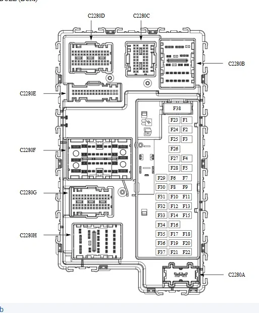

A quick circuit check on the APIM Power Fuse - may reveal something
However, since you have a 2019 - The APIM may be powered from either Fuse 31 or Fuse 32 in the BCM (Fuse Box) early production 2019's used fuse 32
Truck Shut Off:
Open the Driver's Door and Latch the door closed with a screwdriver, this way the door can be open, and the truck thinks its closed and the modules will enter sleep mode
Open the Hood and place the hood latch in the fully closed position (push down 2 detents)
Wait about 1 hour or so (unsure how long the APIM stays partially powered) before entering full sleep mode.
At fuse 31 - using a meter on each leg of the fuse measure from the leg to ground and note the voltage reading
At the battery - meter to positive and negative and record the voltage reading
They should closely match
Alternately - if you have a long enough test lead set
Measure (DC Volts) scale from the Positive Battey Terminal to (each leg) of the fuse
Black Lead (Positive Battey Post) Post & Red Lead to each leg of the fuse = Voltage Drop should be close to (0) volts
I'm using an OBDLink bluetooth device/app and haven't run across the Estimated SOC reading - that might be a Forscan or more advanced OBDII adapter parameter.
I will dig around a bit more. You do bring up a good point whereas at times I will turn off and exit the vehicle and notice the Sync screen does remain on even after closing the vehicle.
Checked the battery this morning, connections all seem to be in alignment.

In the meantime, I traced the module to the fuse box just behind the hood latch. It appears the +12v is tied into the Ford harness there.
Not sure where the 'output' is tied, but its not functioning as an ignition lock but rather prevents the shifter from release from P.

Since I cannot see - exactly where they are tapping for power
I can assume they are Tapping
1. Direct Power
2. Switched Power
3. BOO (Brake on/off) signal wire from the BCM to the Shift Interlock
4. And a relay (in the pic) is the source for the security device control of that BOO signal
There is a bad connection - in that section of wiring or the relay itself is bad and what I THINK is happening is that the relay is hanging up - (sticking)
The security module (sees) constant power on the circuit from the relay as if the brake is applied and when powered down (Truck off) it still thinks the truck is running and does not (write to memory) last state - Valet Mode
Now for the APIM issue
Same thing except this is a Can Bus data transmission - the bus is staying awake as it thinks you are pressing the brake pedal - Brake (on) message along the HS3 Bus, the APIM is on that bus.
When you have the truck running and you press the brake pedal
1. Normal - you should hear a click in the center console and if you place your hand on the shifter, you can feel the interlock (clicking)
2. When the security device is (Armed) it prevents the (Relay-In Pic) from letting power through to the Shift Interlock (in Item #1) until you enter the code - i think it takes away the coil ground
3. When in (Valet) it either bypasses that relay or it provides the ground to the relay coil.
I would unbundle the wiring and inspect it for security and pull and reseat all connectors and possibly replace that coil as I have a suspicion that the issue is in that relay.
If you can identify where they are tapped (power and ground) we can do wire checks if needed.
From the pics it looks like they are tapping into
C2280D - It will be a Blue/Orange wire - this is the BOO signal to the shift interlock
and
C2280F - for power and grounds - hard to tell
The wiring will run from this location - to the security device
As I said - I cannot see exactly where they tapped - but the most logical failure point is the relay
