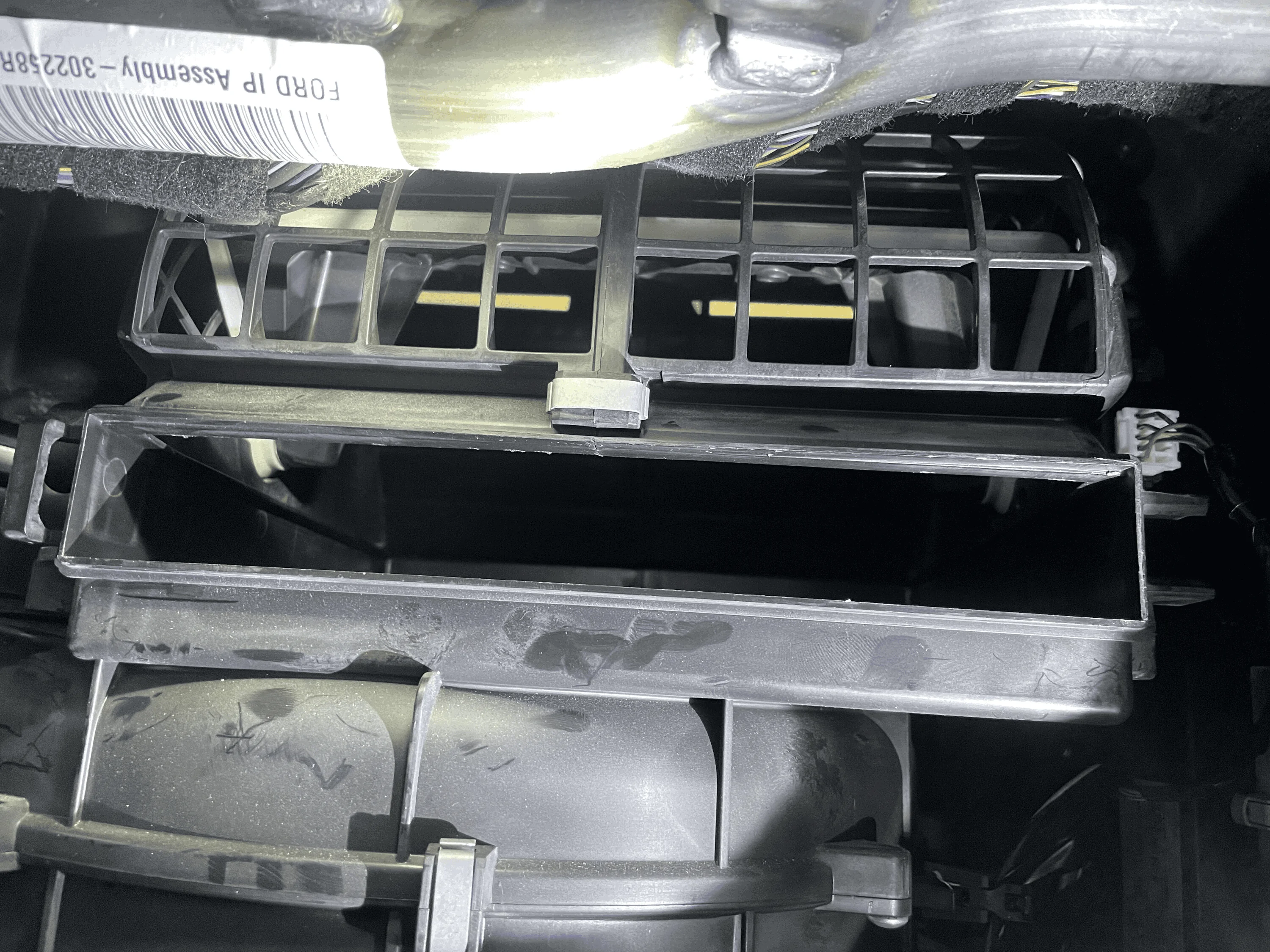

Using below pic as ref - that's daylight you are seeing through the holes, inlet door is open
I believe that this is the 10% air source
But: The only issue is I think this is the Recirculated Air (Inlet) source, but since it spends so little time in (Recert) it should have very little effect on system
Agreed that's the outside intake. That's pretty much covered when in recirc mode. Last weekend I'd also looked more carefully at the blend door sealing, and I think it can be made to seal a bit better. It's actually not as bad as I thought, but at high speeds, even a little can lead to a large amount of pollutants coming in...

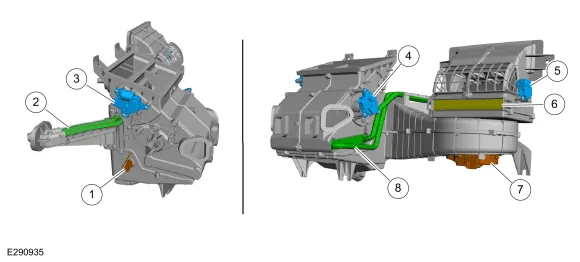

See attached for the Humidity Sensor R&R

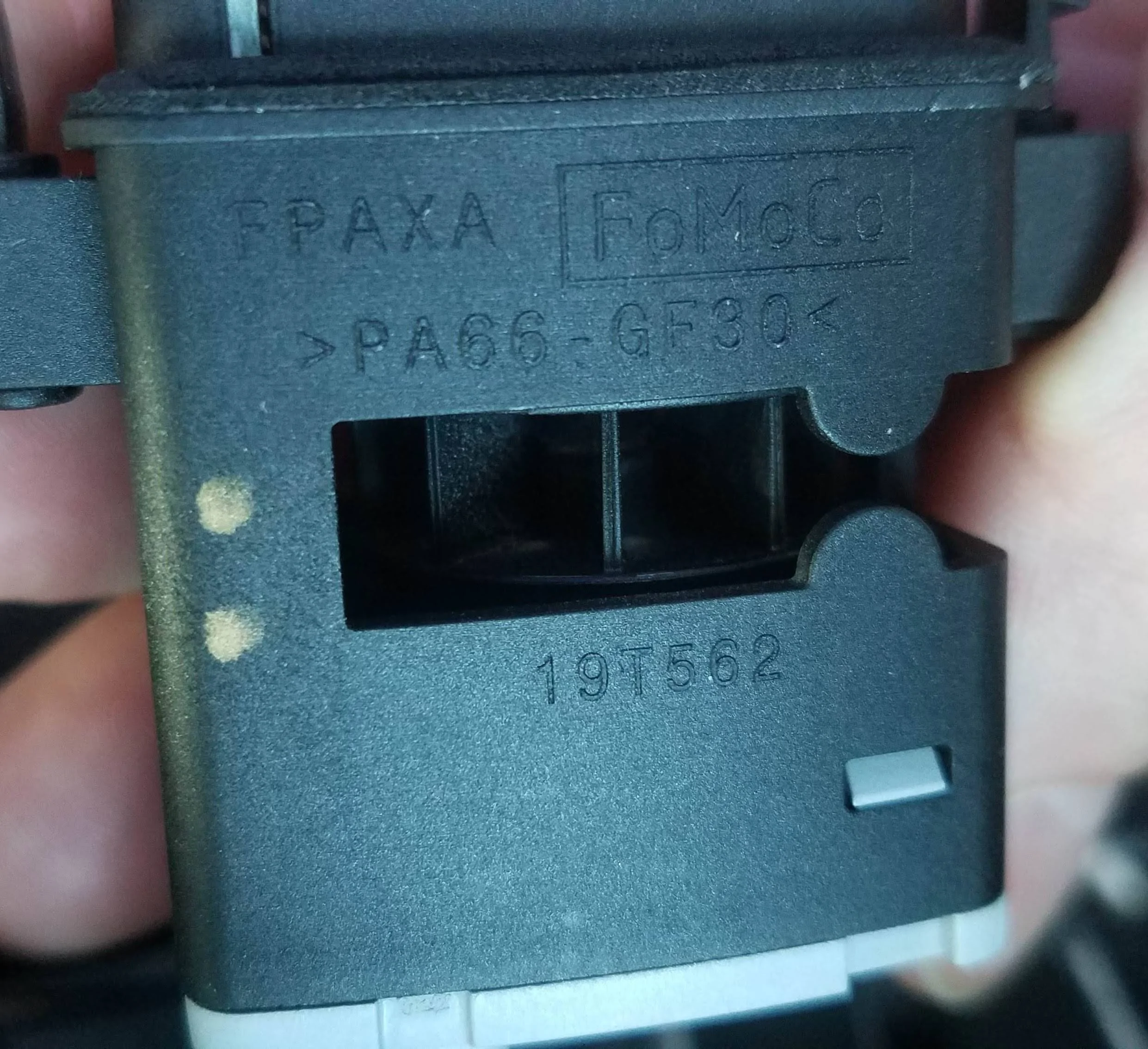

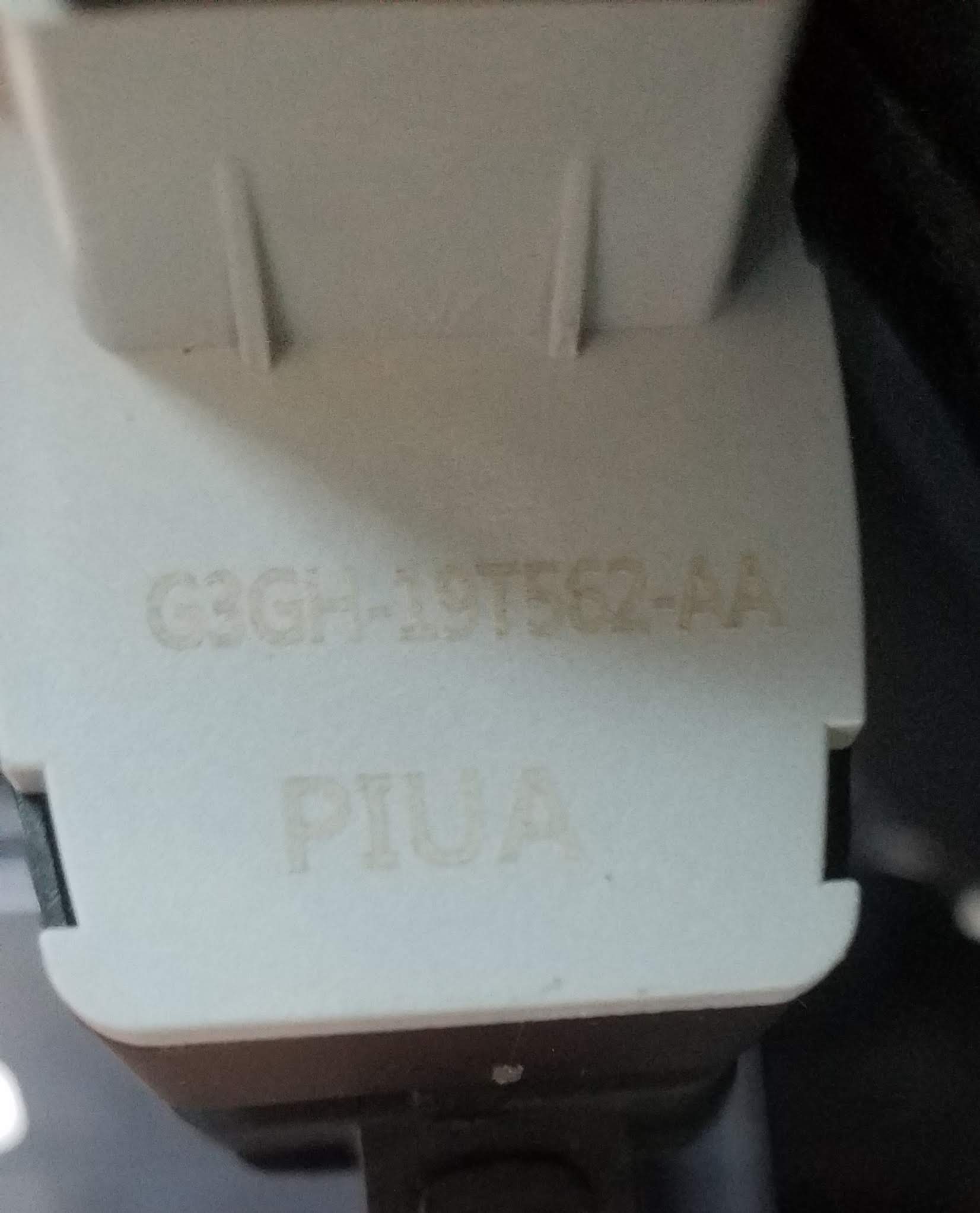

Thanks for the humidity sensor location :) I have the humidity sensor out.
Removal was more awkward than the document showed: the sensor slides BACKWARDS, so it needs to be fished out of some small holes in the dash.
Reinstalling could be challenging.
Notes:

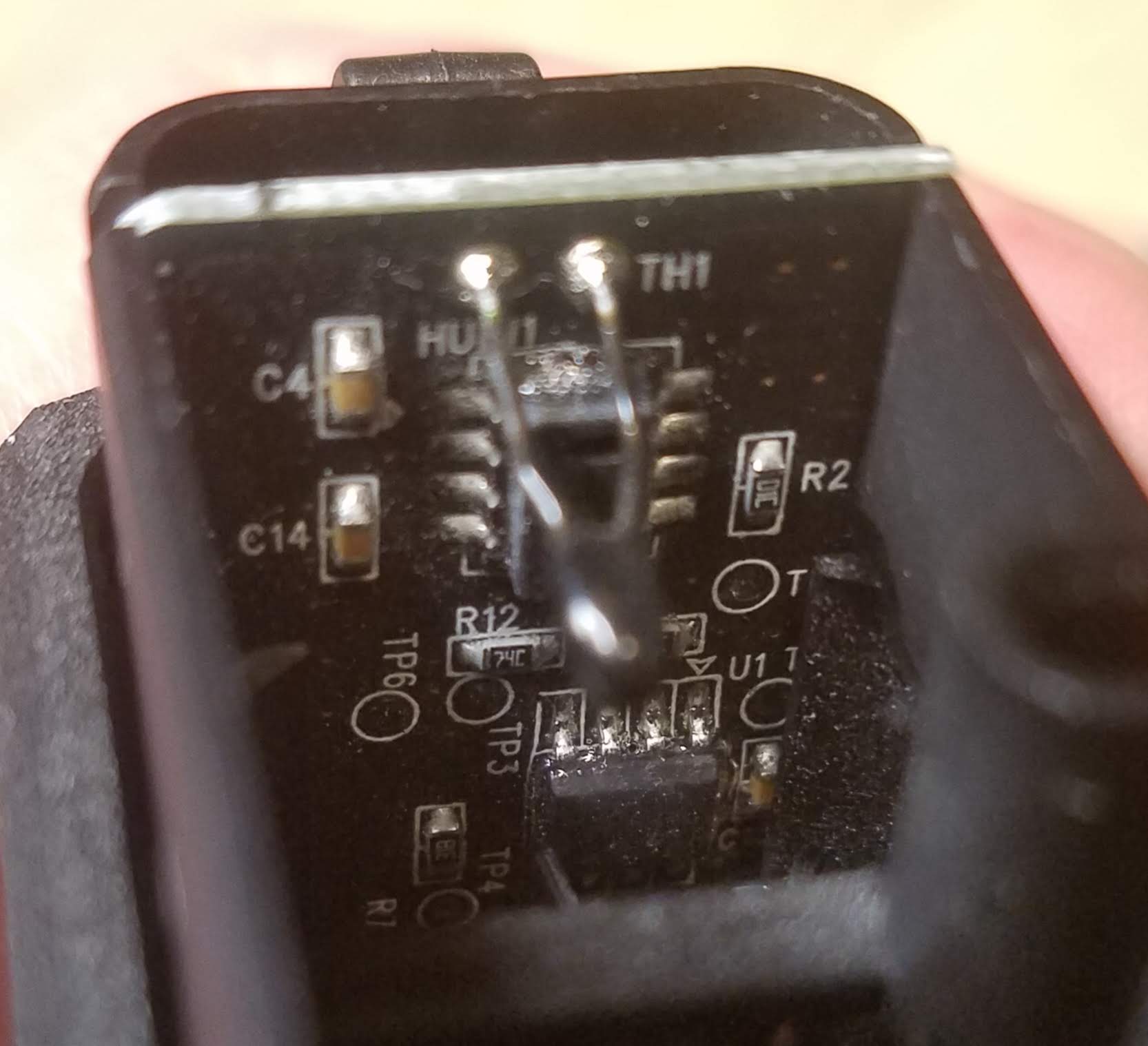

(1)There was so much confusion (on other threads) about what the actual part is. Here's the part number written on it: G3GH-19T562-AA.
The surface-mount humidity sensor is right behind the thermistor:
(2) I took measurements of an operating sensor , while the vehicle was On, using probes that poke through the wire insulation. I have a range of output voltages depending on my breath (higher humidity). It's a reasonable-scale output, so we're not operating at the mV level here.
Based on my measurements, preliminarily, this seems straightforward to modify.
I'll need to make a connecting harness, so need to find the connector and socket.

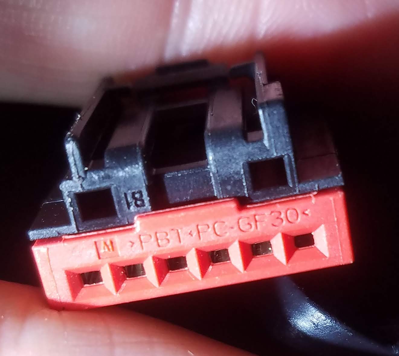

I found a link for the female side; but no male side yet.

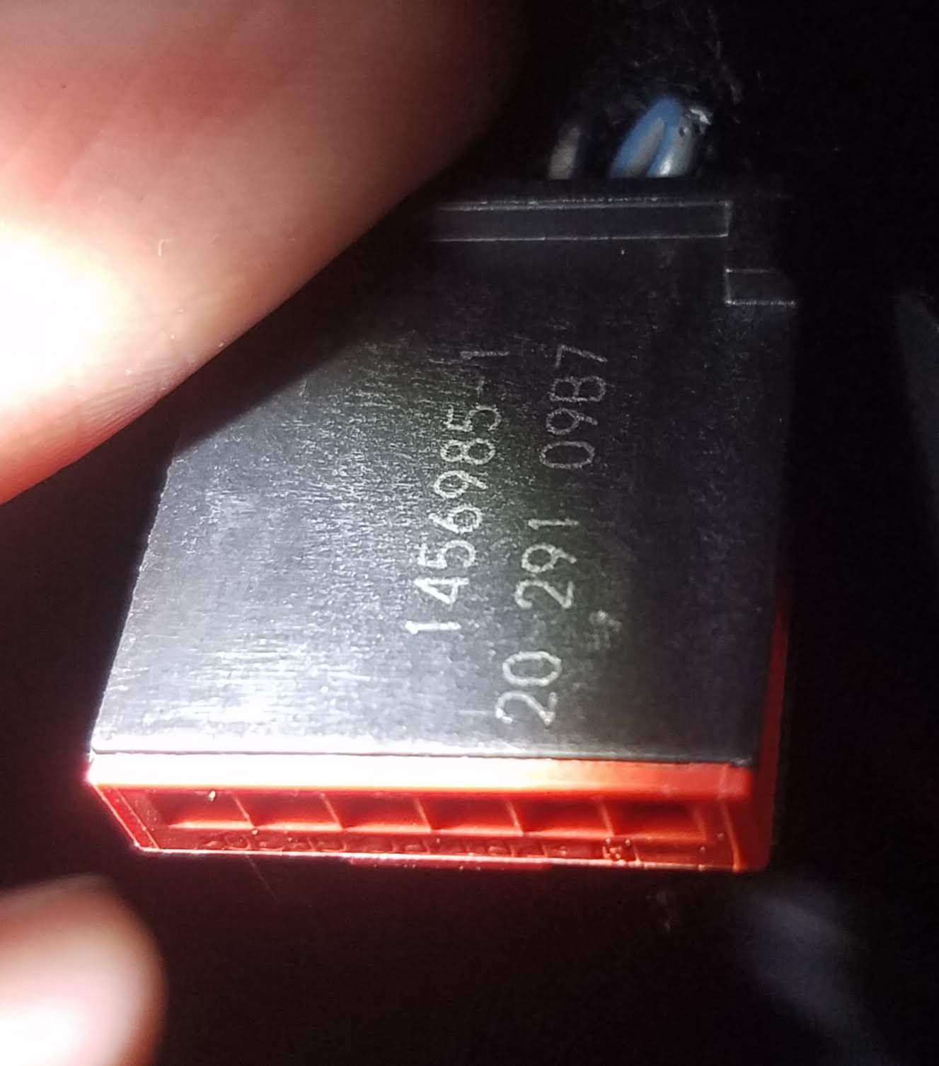

Turns out "1456985-1" (written on the side) is the correct part number for the female side. The texts on the front isn't as useful.
Can anyone help locate the corresponding receptacle? I'm unable to find it online...

Update to my last post item(2). I spoke with a TE rep about the connectors, and unfortunately they do not make a male receptacle side. I guess the designers have to build the receptacle into their devices, eg this sensor.
So, (a) I'll have to think of another route, beyond the non-destructive "just plug in an extra harness" route, or (b) find another mating housing that works solidly and won't unlock, since this is still a 0.1" standard-pitch connector.
For now, I'm proceeding with using a standard 0.1" Molex male connector on the vehicle side, and the TE female connector on the sensor side.
