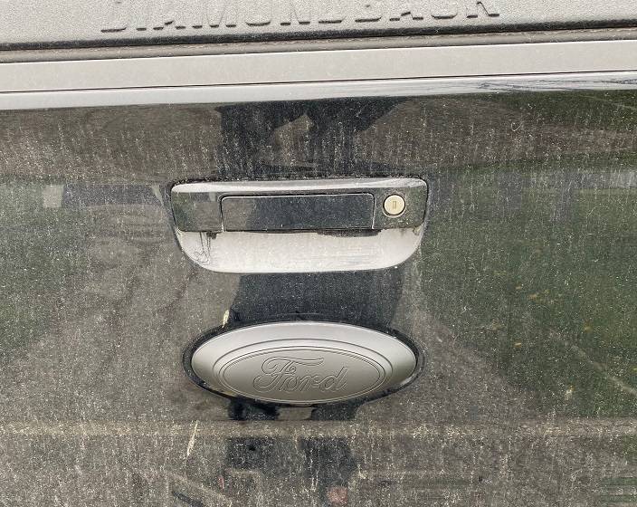

I did my tailgate, came out great! Thanks for the idea!! Like the way your taillights looked, so decided to murder that too, lol. I went tint though. Didnt have the cohones to paint them.

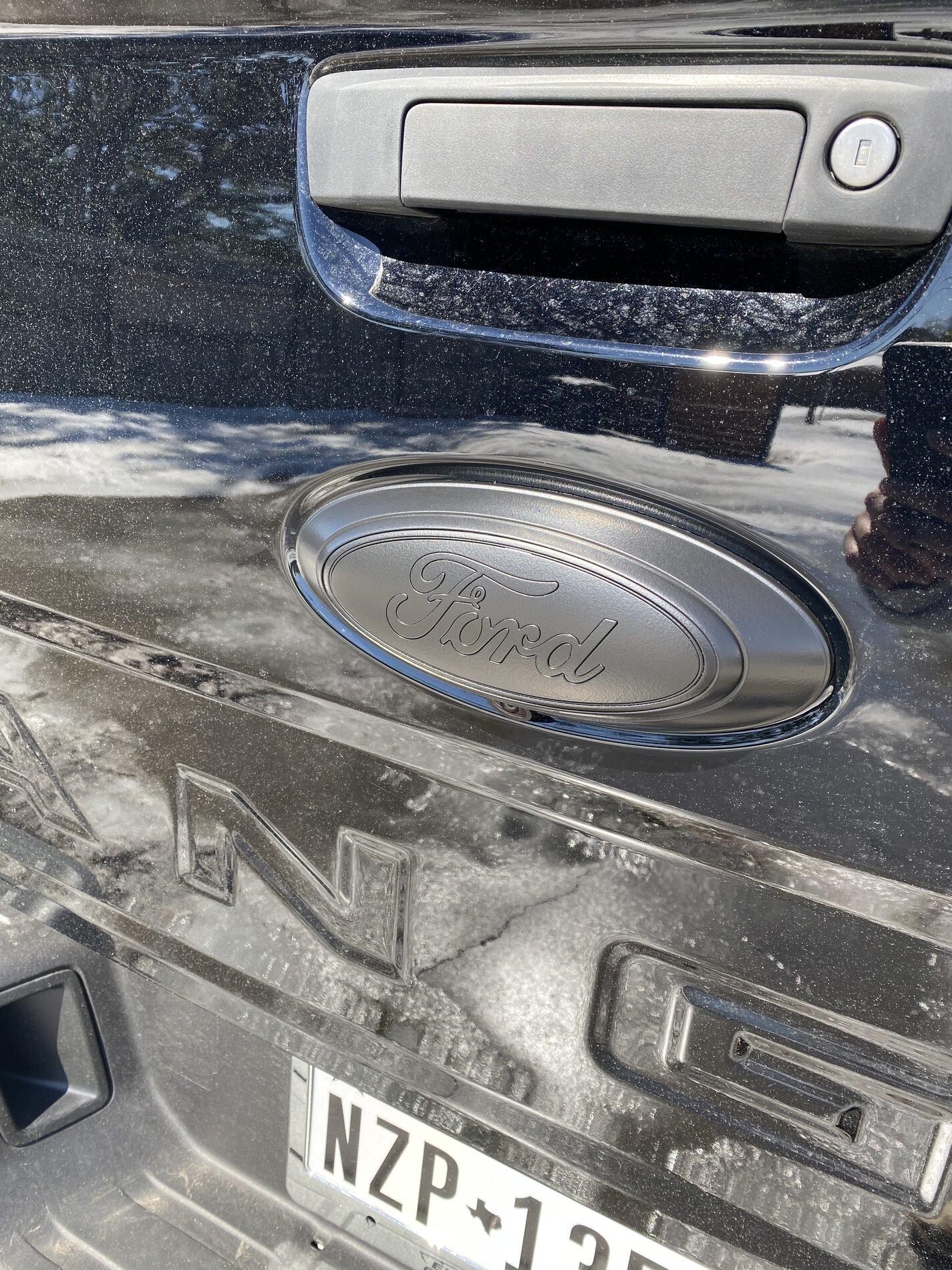

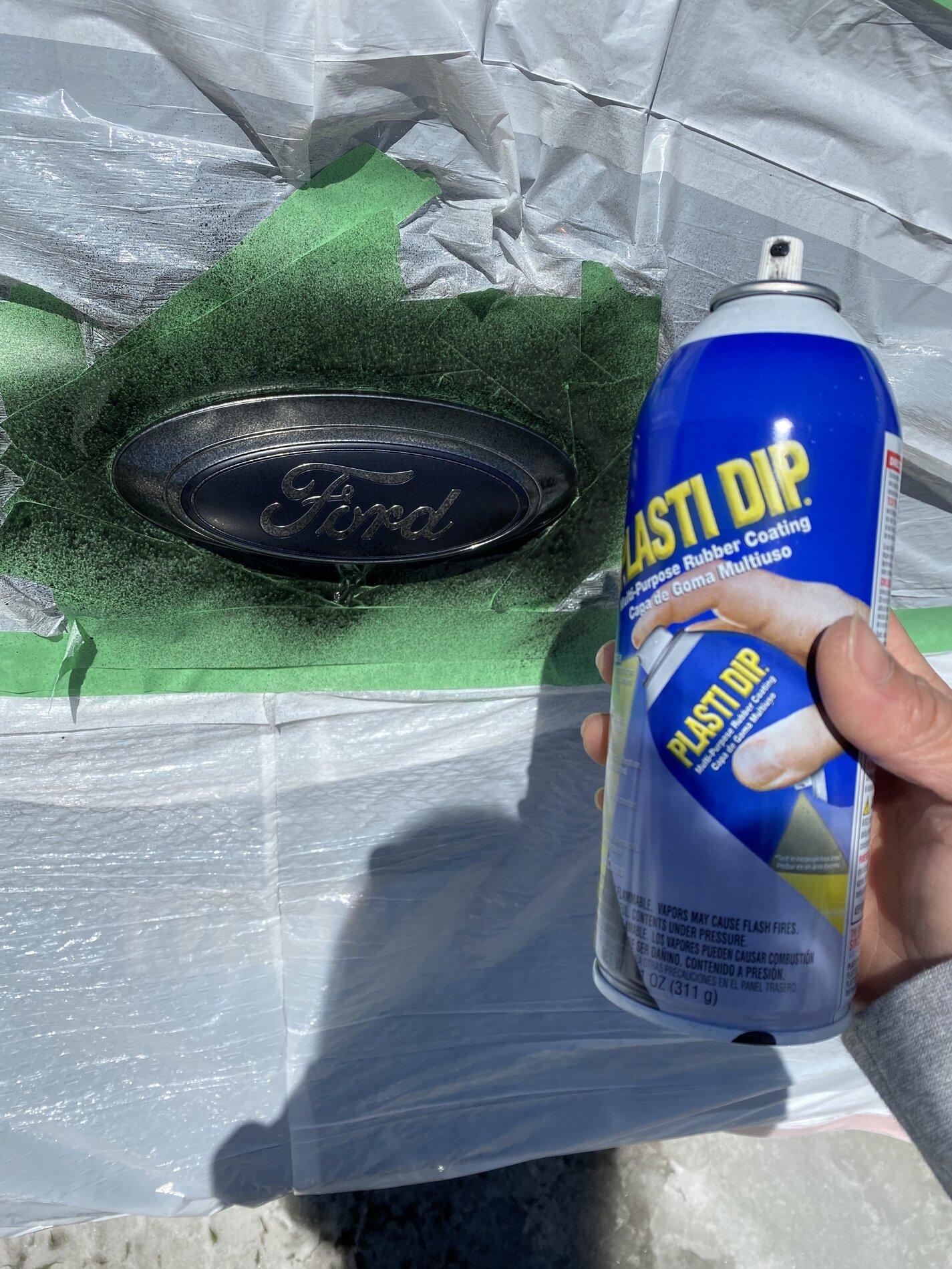

I figure since I have done all this and seem to keep reposting on other threads how to do this and posting pictures I would just put all in one thread so hopefully all can find it. (Maybe pin to the top of forum?).
As I have said in other posts, anyone can plasti-dip this stuff with a little practice and patience. It’s very DIY friendly and you should not waste money paying someone to do it unless you have plenty of disposable income. The steps are easy and worst case, if it looks awful you can peel/rub off(with microfiber towel) and retry. I have used the black and go mango plasti-dip colors which I ordered from https://www.dipyourcar.com or you can find several colors at local hardware/auto parts store.
The basic process is to tape off roughly an inch outside of what you want to plasti-dip and then cover far enough away to avoid over spray. Why you tape off, let cans of plasti-dip sit in a bowl of warm water (helps the spray lay down much smoother! Then, spray a LIGHT coat (at most 50% coverage) and let dry for about 15 mins, then put down WET but NOT heavy coats to fully cover and go at each coat from different angles to get all the sides, etc. MAKE SURE to thouroughly coat the roughly 1in area between what you want plasti-dip and the tape also or peeling will be much more difficult. Let each coat dry for 15 mins or so and after 5 to 7 coats let it dry for 45 mins. After that slowly and methodically peel the tape and the plasti-dip back to the edge of what you ultimately want plasti-dipped. The plasti-dip will naturally break at the edge and leave a pretty clean and precise edge.
Avoid rubbing/washing for a few days to allow to fully cure. After that I have put a pressure washer right up to it and had no issue at all with peeling.
Hope this is helpful and give people the confidence to try. Feel free to DM me or reply to this if you have questions. This stuff is amazing!

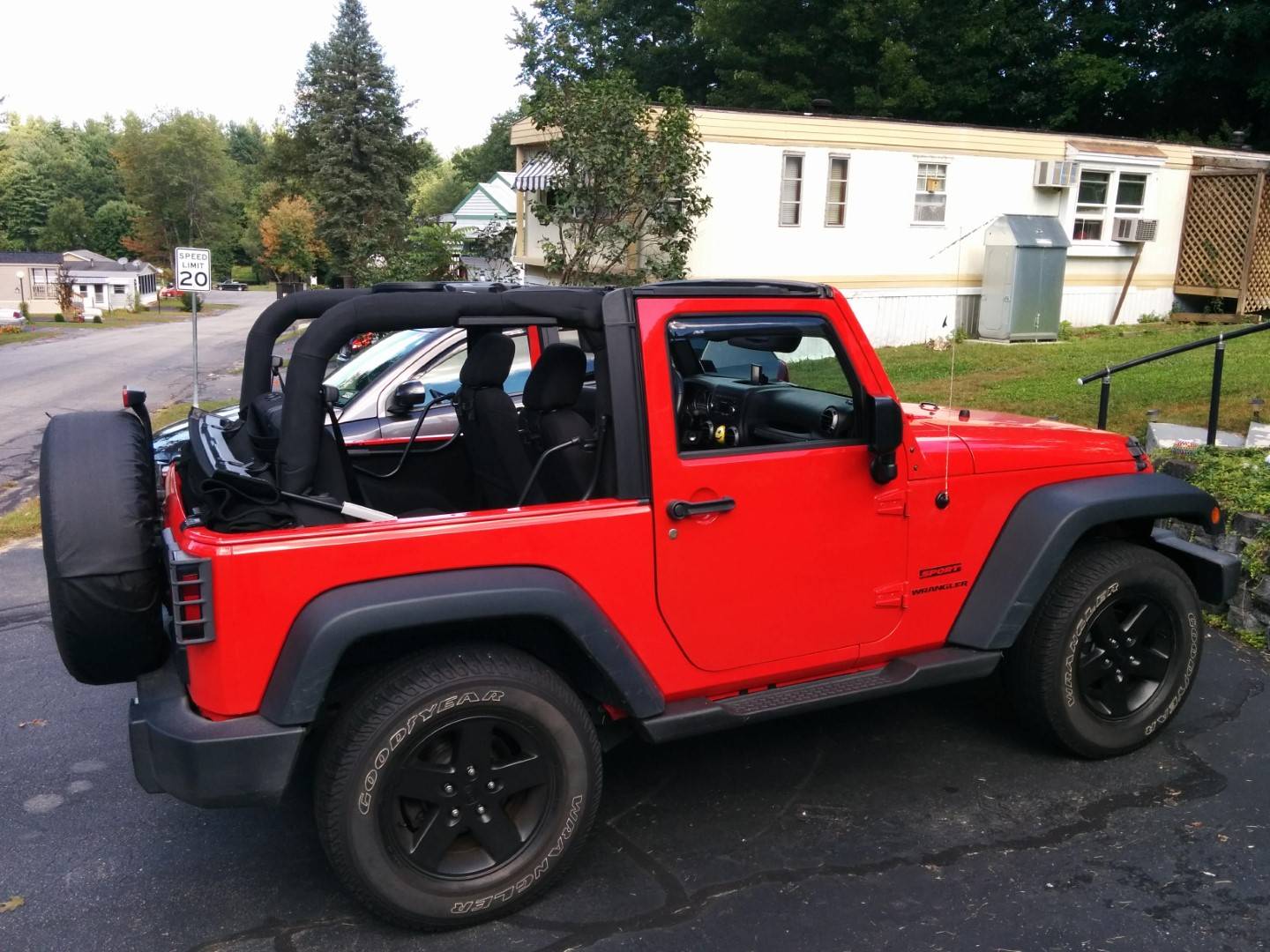

It sticks very well, I did the wheels of my Wrangler when I had it, went through 3 New England winters and still looked new, all I did was wash beforehand, no other prep other than stuffing some newspaper in to keep the rotors from getting covered. When I traded it for the Ranger the dealer thought they were factory black.

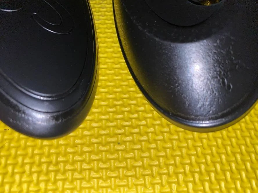

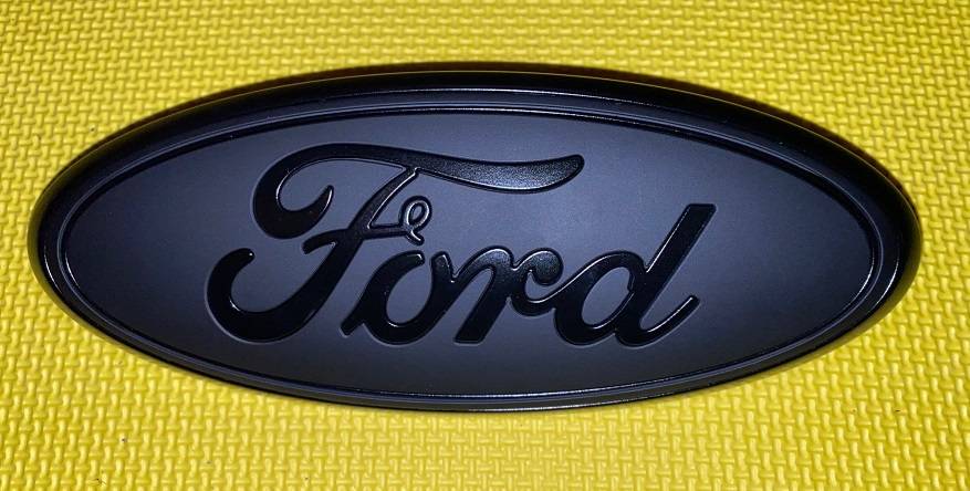

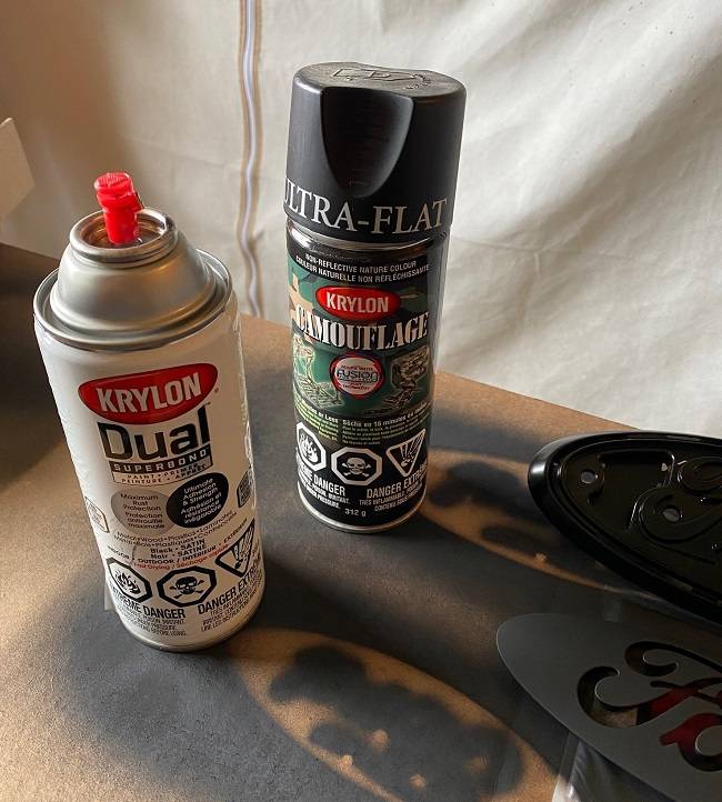

I took the grill and taillight badges off, drilled the plastic rivet-welds and painted the blue flat black Krylon Camo Ultra flat, which is very rubbery like Plasti-dip. Then I used Krylon semi-gloss superbond black for the chrome pieces.
I did 5 layers of paint, but didn't want to over do it and cause chipping when I re-assembled. I hot glued them back together and I was very happy, but wanted to add some protection so I hit them with Plasti-dip clear, which reacted with the gloss and caused some slippage.
The front didn't get clear, so it turned out as I planned, but the rear was bad. I assembled the rear and dipped the whole thing flat black, which hides the mess unless you look really close.
Whether to leave them on the vehicle or not, the front is very easy. Only two 10mm nuts on the back, under the top shroud which is held by plastic plugs. Even if just painting single colour I think it's as fast/easy to remove as tape and clean after, plus it allows a level paint application. YMMV
The rear is a little tougher, and often the plastic clips break. Easily repaired with hot glue or 3M 2way tape, but I'm not sure I'd bother taking it off, unless I was doing 2 tone and really wanted perfect colour separation.
Black package has blacked side badges, and I didn't get an EcoBoost badge. If it were, I'd have just peeled it off as it's only 3M taped on, and then wash reducer of finger rub to remove any extra adhesive. Toss it in the glove box for the next owner in case they want it.

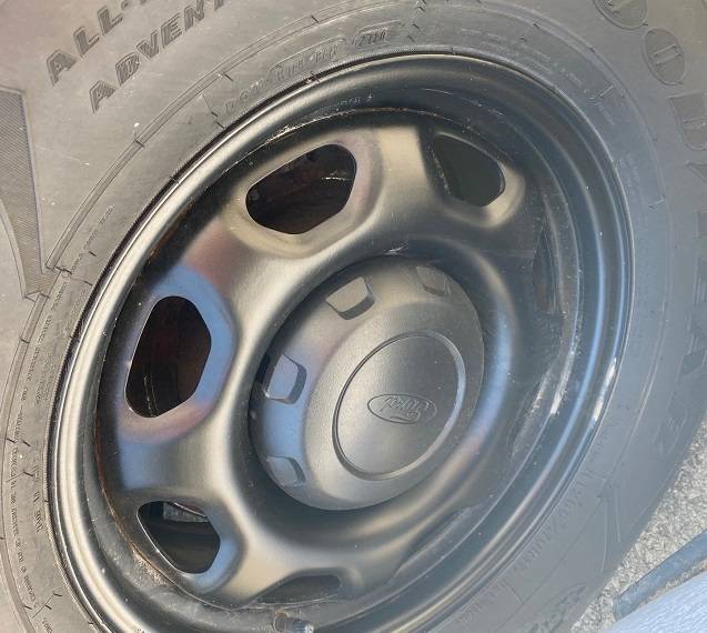

My last truck rims.
Standard silver factory F-150 rims that were well used and rusting. I peeled the rubber and valve, sent them for a sand-blast then for flat black powder coat. Center caps are black plasti-dip.
They only have 3,000 miles on them, and still like new. It's just dirt in the photos.

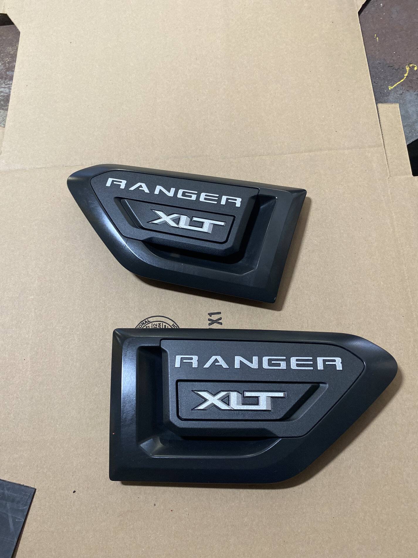

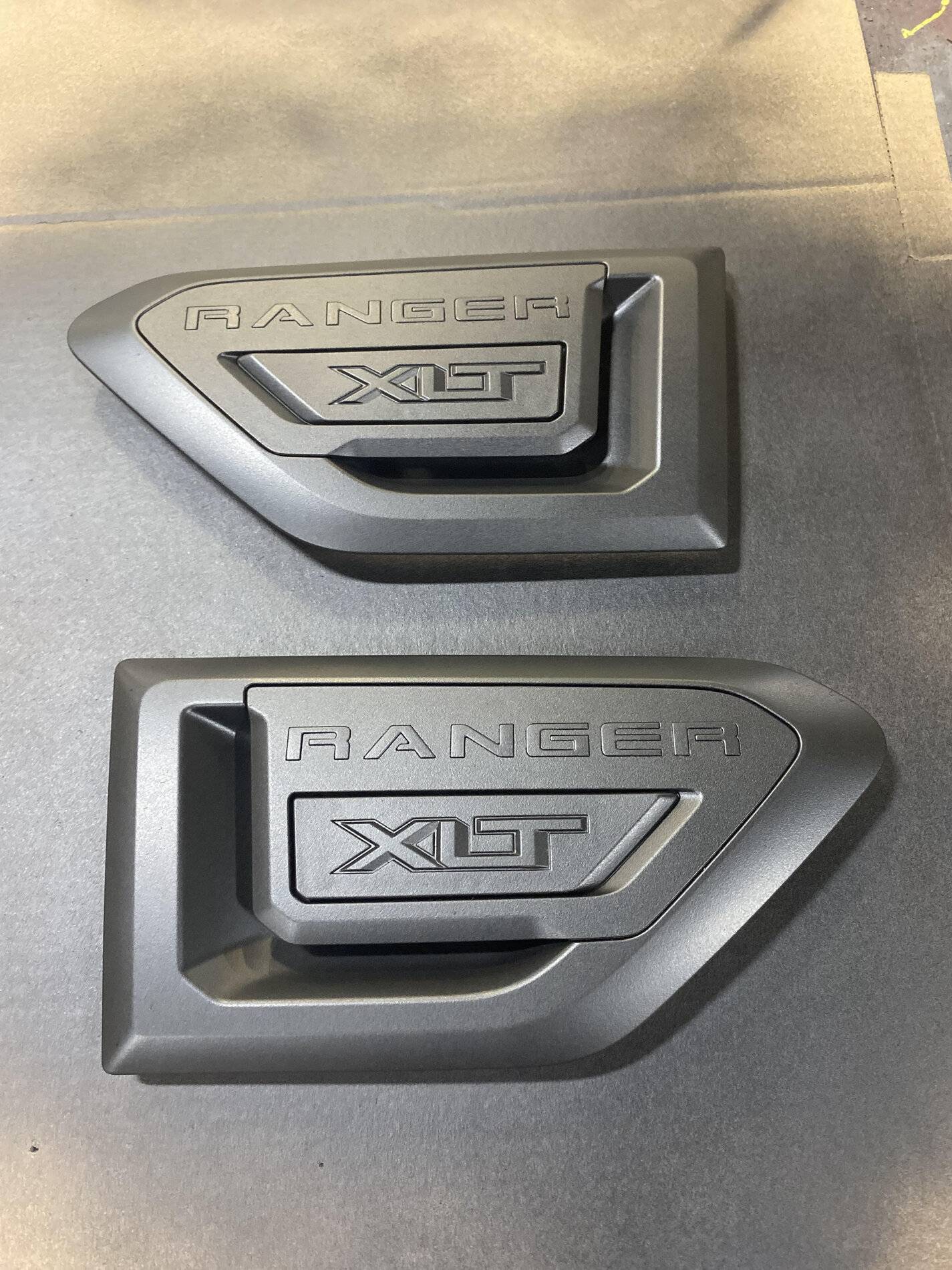

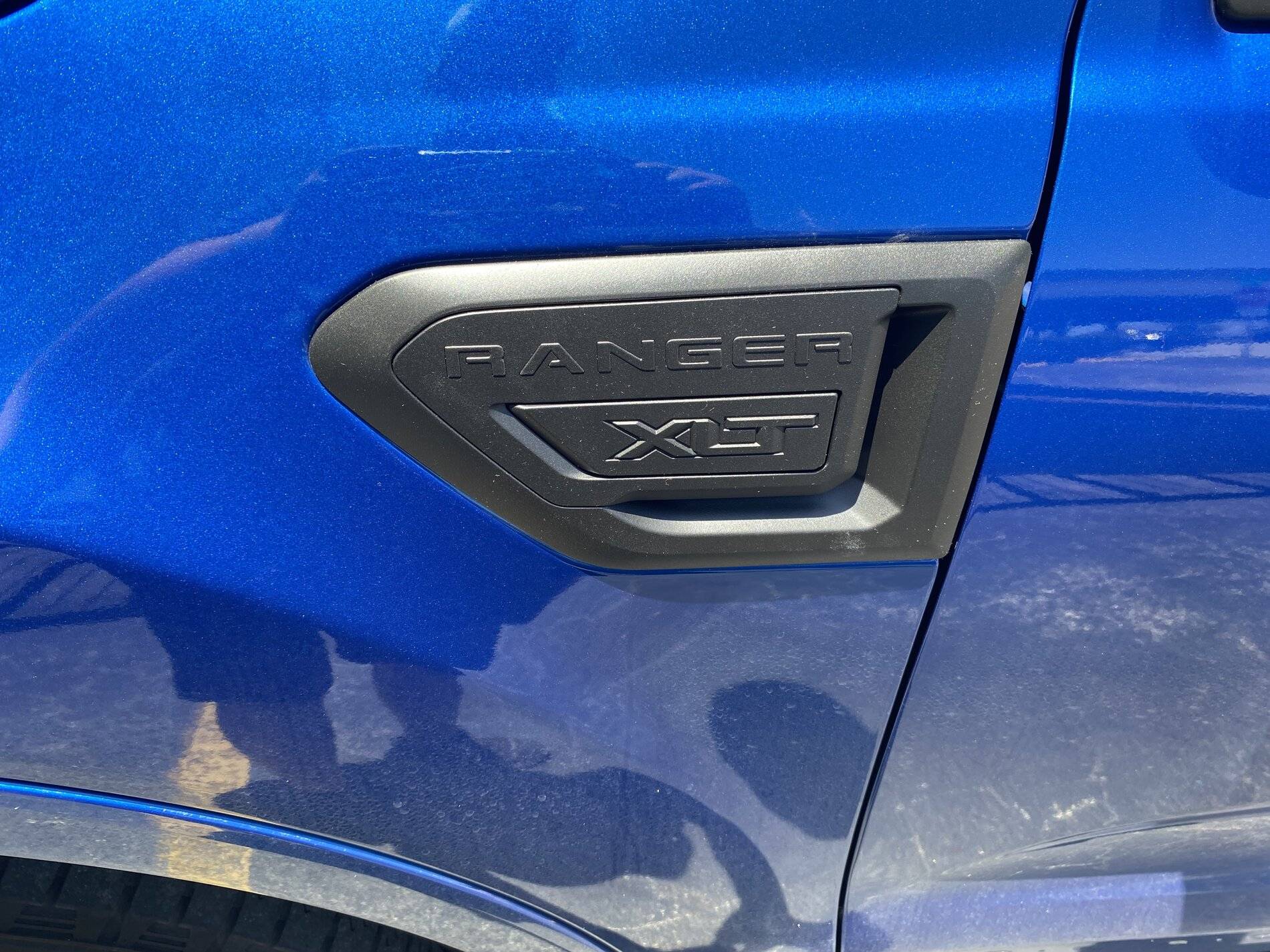

Fender inserts done. Took about 20 seconds to get them out with a trim tool. A quick wipe down with some naptha, let them air dry then I followed D-nguy56's suggestion about passes and # of coats.
After the 5th coat I let them dry for nearly 2 hours before I installed them back in the truck. Gotta say that I LOVE the look.
