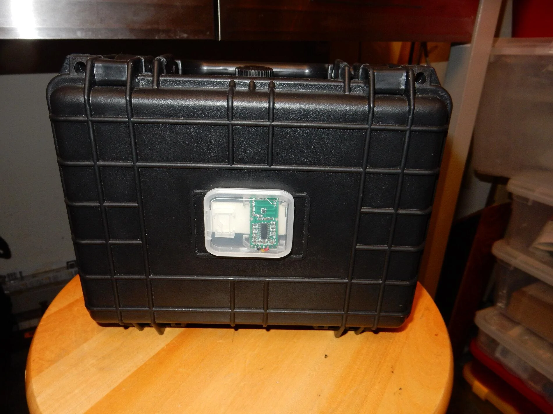

My garage is too small and cluttered to park my Ranger inside so I chose to leave it outside in the elements. The garage door is made of fiber/wood material so I came up with the idea to shoot a Doppler radar microwave beam through the garage door (range ~ 21 feet) to detect any motion around my Ranger. The radar detector RCWL-0516 sensor is only $0.97 $USD on Ebay. I used an Arduino Nano V3 and Arduino Nano breakout board to interface to this doppler radar device board. Using the Arduino Nano, a person could add an output for sound annunciator (buzzer) or, in my case, I also added it to my home Wi-Fi network so my family and friends would be notified of any disturbance to my Lightning Blue Ford Ranger on their mobile devices.
See pictures below

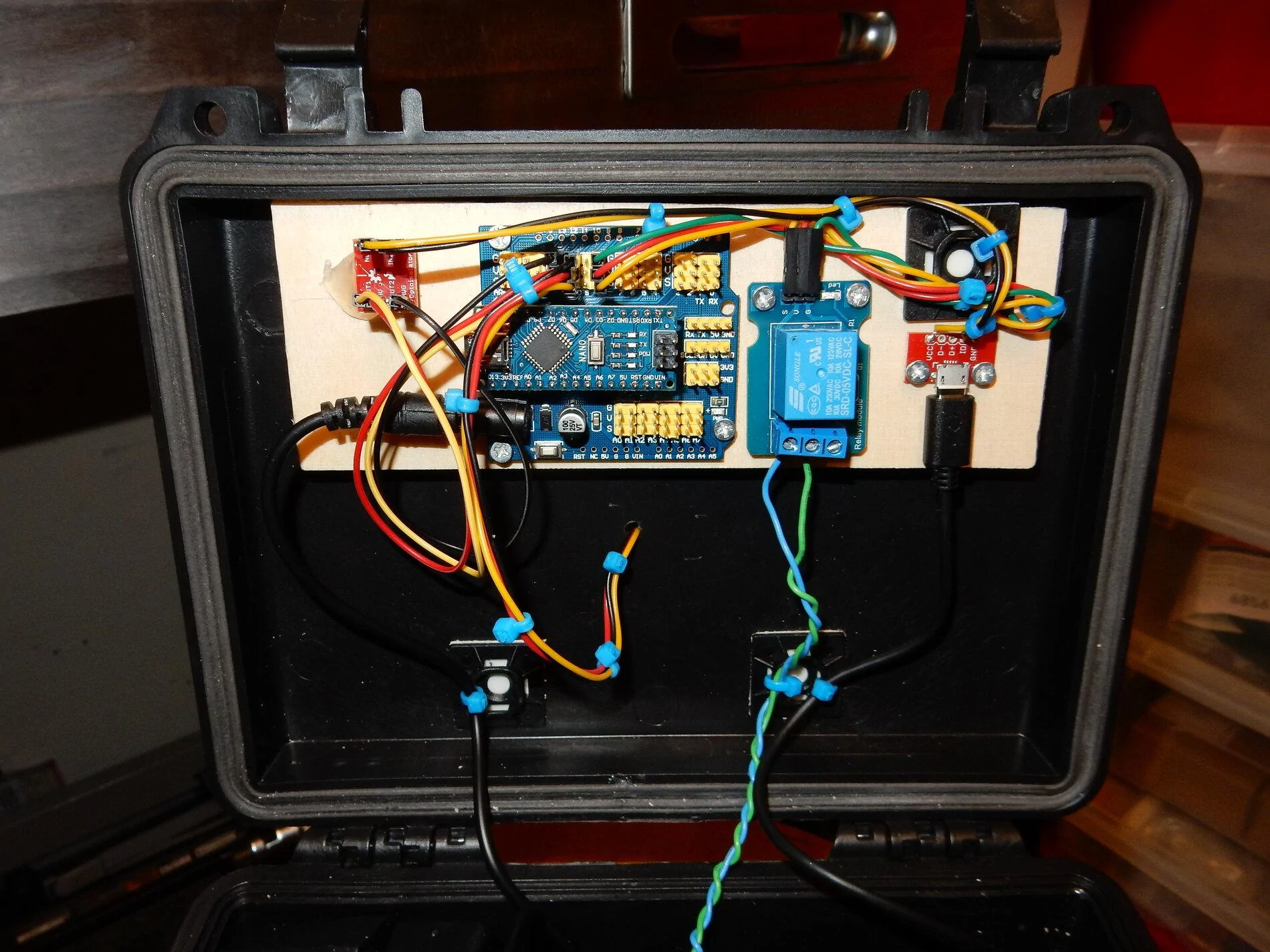

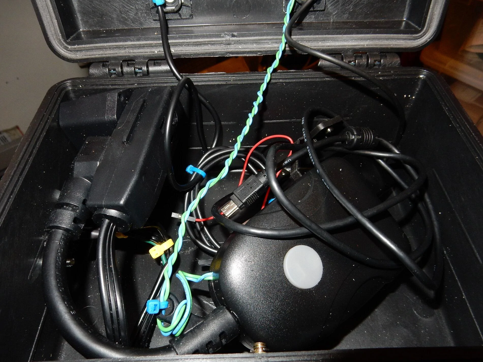

A little more detail but it is somewhat complex ... In the second picture (above), you can see the wiring (two wires) going from the blue relay to the "hacked" smart outlet WiFI plug from Feit Electric (in the third picture - below) When the Doppler Radar Microwave Motion Sensor picks up motion, near the Ranger, the output goes high to the Arduino Nano which reads the WiFi smart on/off status and if it is OFF it will latch the outside outlet smart WiFi plug to the ON state. By using the "FREE" FEIT Electric Android/IOS App you can notify yourself and other family members of the Ranger's security breach on their mobile devices. FEIT Electric provides smart and very in-expensive (2.4 GHz only) WiFi doorbell/cams, WiFi video cams, WiFi outlet plugs and other WiFi smart sensors. All I did was to hack into their smart IoT WiFi network to transmit the status of the Doppler Radar Microwave Motion Sensor.
