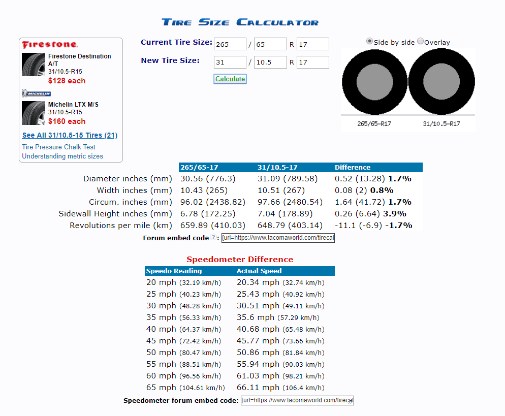

31 10.5 is pretty close shouldn't be a problem only .52" diameter difference.

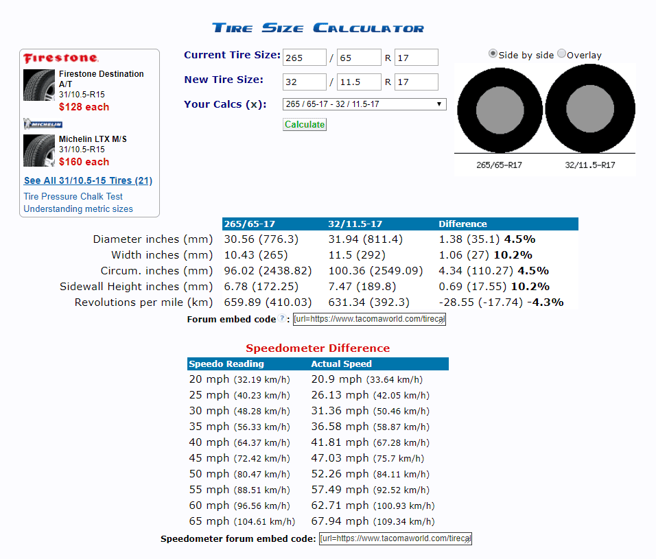

32 x 11.5 Comp 1.38" Difference in Diameter
