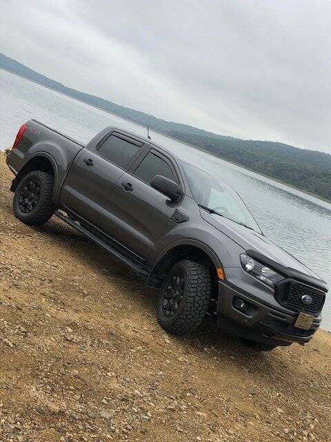

I I went with the cooper Rugged Trek, nice meaty and nice ride. there isn't much road hum.
