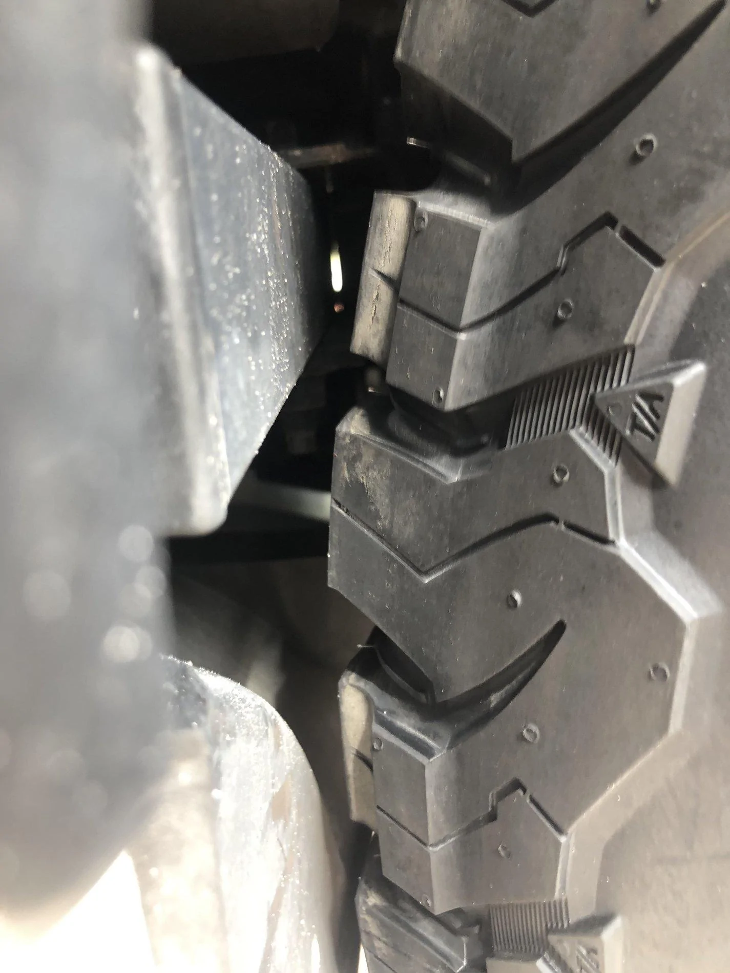

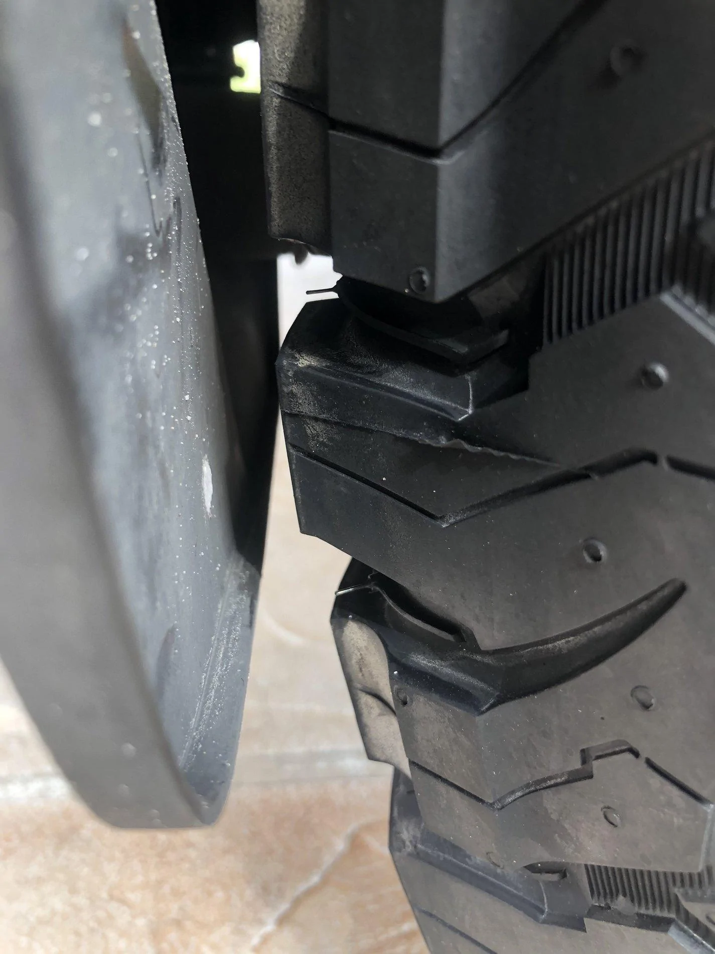

Here are two pics. One, of the clearance between the tire and the air deflector, and the other of the clearance between the tire and the front intrusion beam - both at full lock.
FYI, I found the BDS item on eBay after a search.
