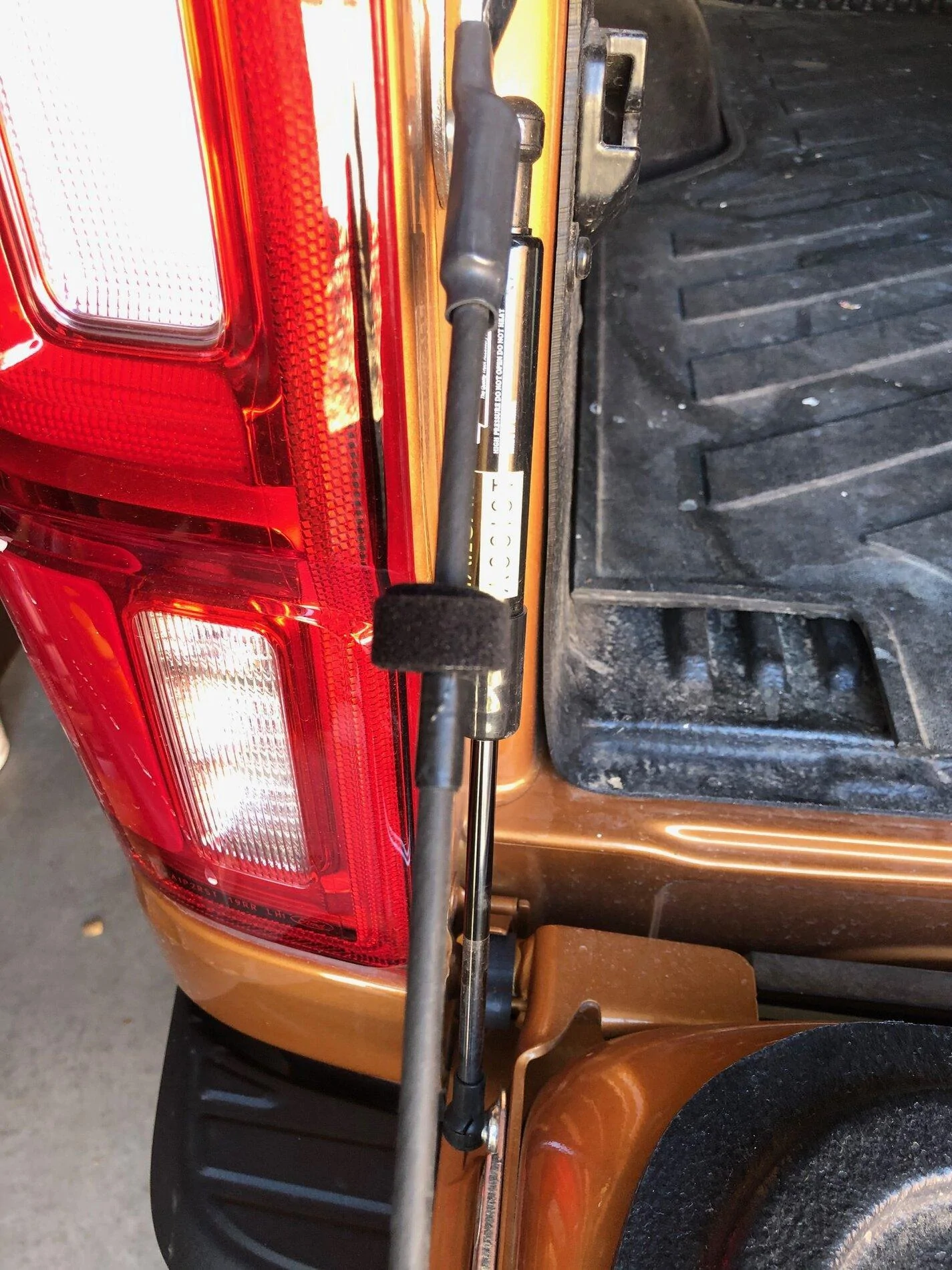

There's a mod for the damper getting pinched. :D Just wrap a piece of thin velcro around the cable and add a little electrical tape at the bottom to keep it from falling down. This way when you shut the tailgate it doesn't get pinched. You could just use electrical tape but I had a velcro tie from a set of HDMI cables so I used that.
Velcro:Tailgate Strap.webp

I saw that, and if I need to add the 'mod' I will. I saw someone else mentioned they just trained the cable to go inside the damper. Mine is already sort of trained that way, so I may be good. I'm also going to add some silicon around the damper bracket on the bottom to soften the sharp edge... someone else used tape, but I'm going to try silicon first. I will report back in that thread my success or failure :)

I tried training mine but it kept binding up. For some reason mine was untrainable. ?

Copy. I just installed mine and have only opened the gate a few times. I checked it today, and it looked to be going inside (to the right) of the damper. I don't fully understand what the velcro mod does, but haven't tried it. I assume it just keeps the cable from getting too close to the damper, or maybe it forces it to the right? Dunno.

Yes it just keeps the cable from getting pinched between the damper and the body. I'm in and out of mine all the time and it was always binding up behind there. I saw another member post this a while back and it worked out great but cant remember who it was now. lol

Cool. Need to find some velcro I guess. :)
