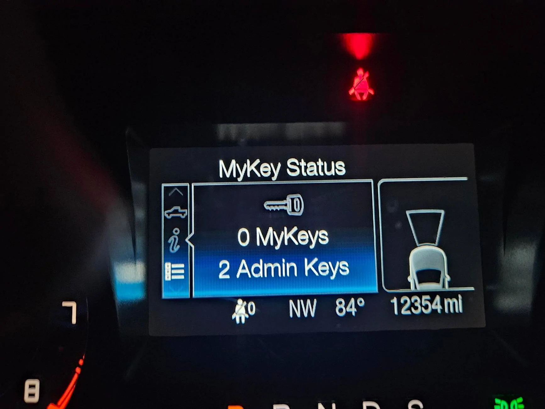

Sorry, I should have mentioned I spent about an hour on google and here before asking. I checked MyKey and neither are programed and I went through every setting that seemed likely.

I checked both of them, they are both Master, not programmed. Also, I am not getting any other messages or warnings. I have had it since new and purchased 5/23. It just started when I got the 3.4 software upgrade.
