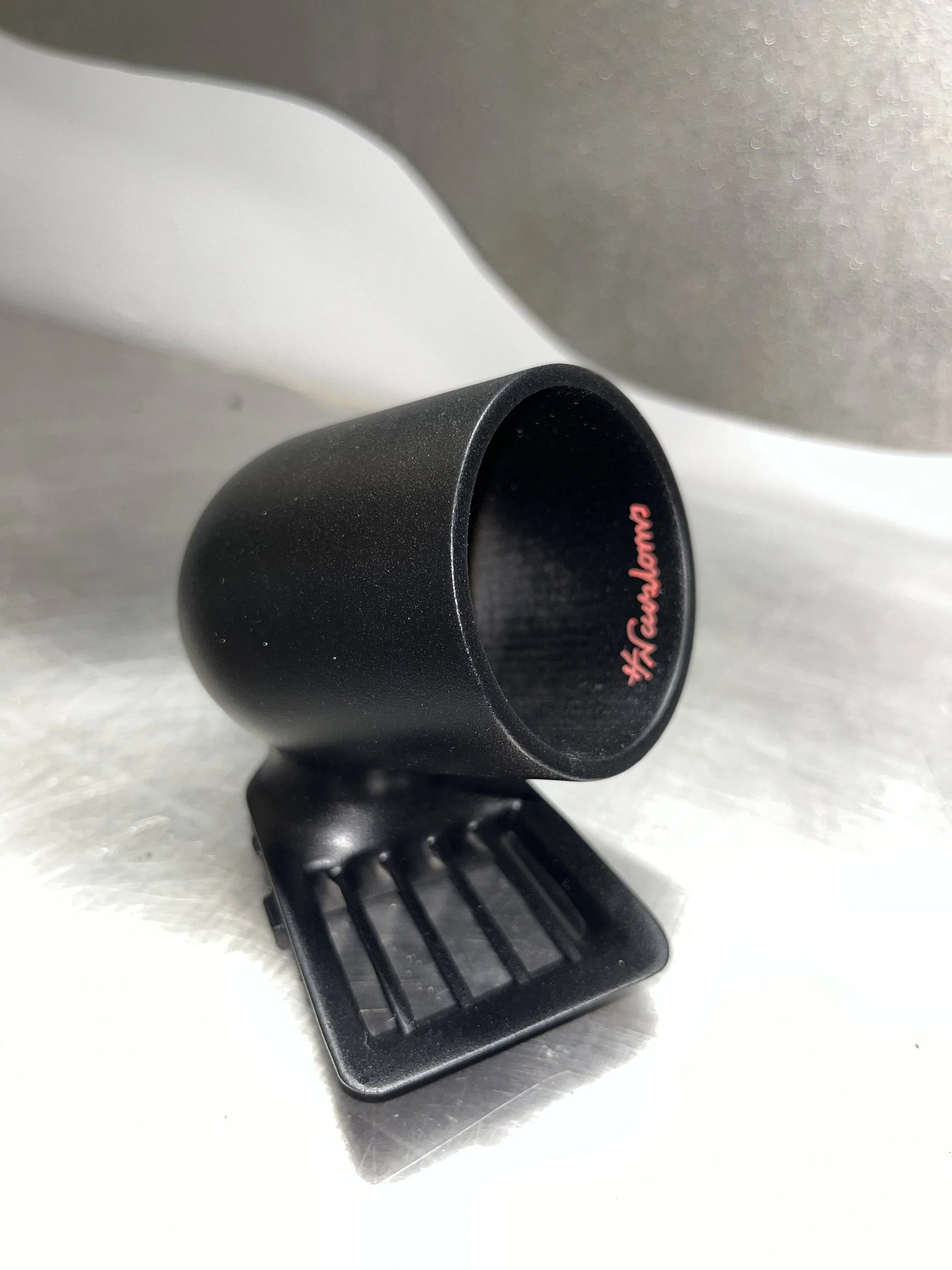

Installed my HN Customs gauge pod mount this afternoon. Fit and finish of this handmade piece is incredible. 10/10 and worth the wait.
Here are some pics of the install. Had to drill a hole in the dash to route the wires to the OBD port. Took my time and it came out great.

Installed my HN Customs gauge pod mount this afternoon. Fit and finish of this hand made piece is incredible. 10/10 and worth the wait to get it.

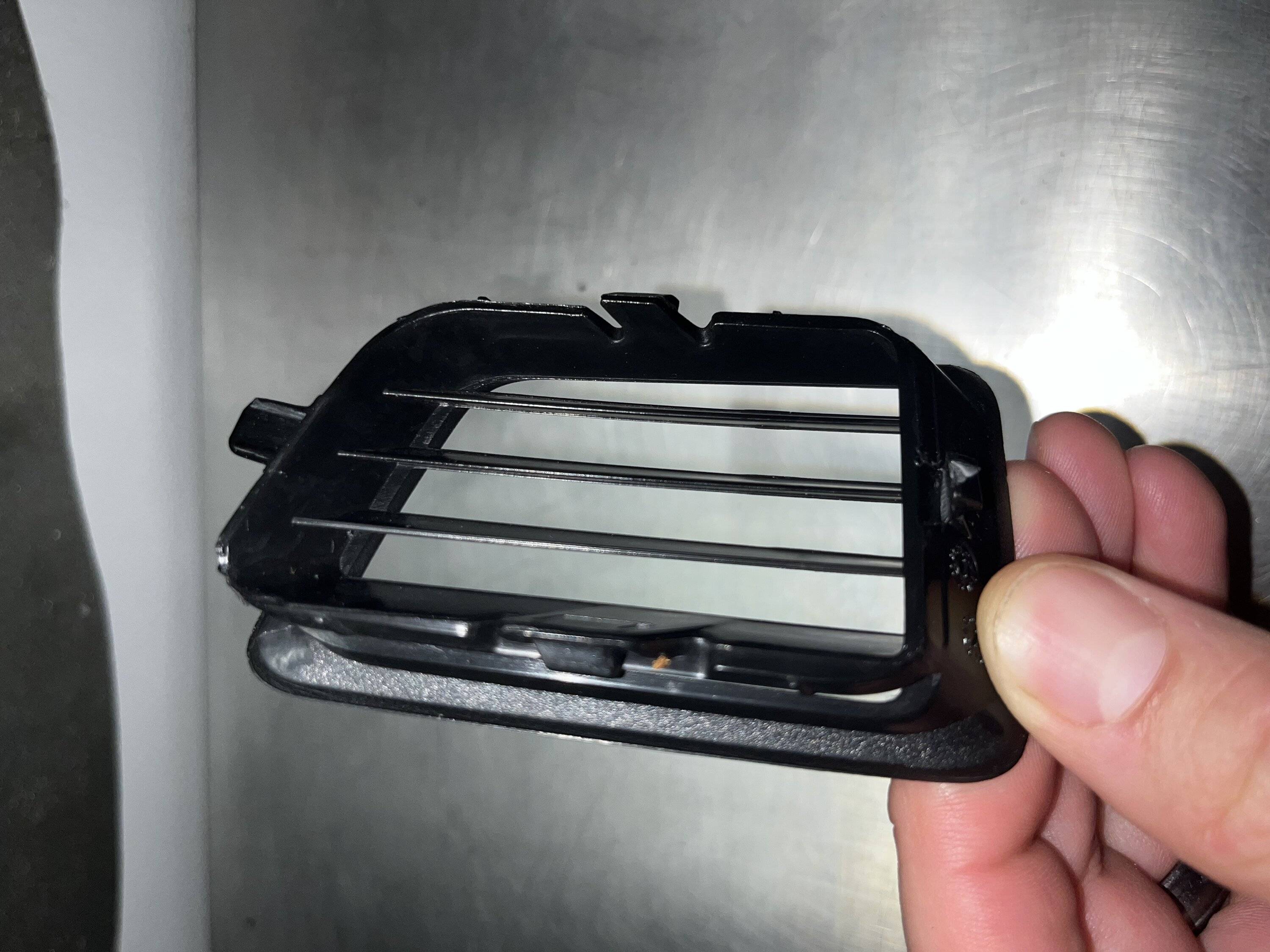

How did the stock venf come out was trying to pop it off wasn't moving at all? Seems like it was part of the dash.
The front of it has a small clip that if you push back and up it will come out. The back of it has a long retainer style clip. I will take a picture tonight and show you.
Awesome thank you!

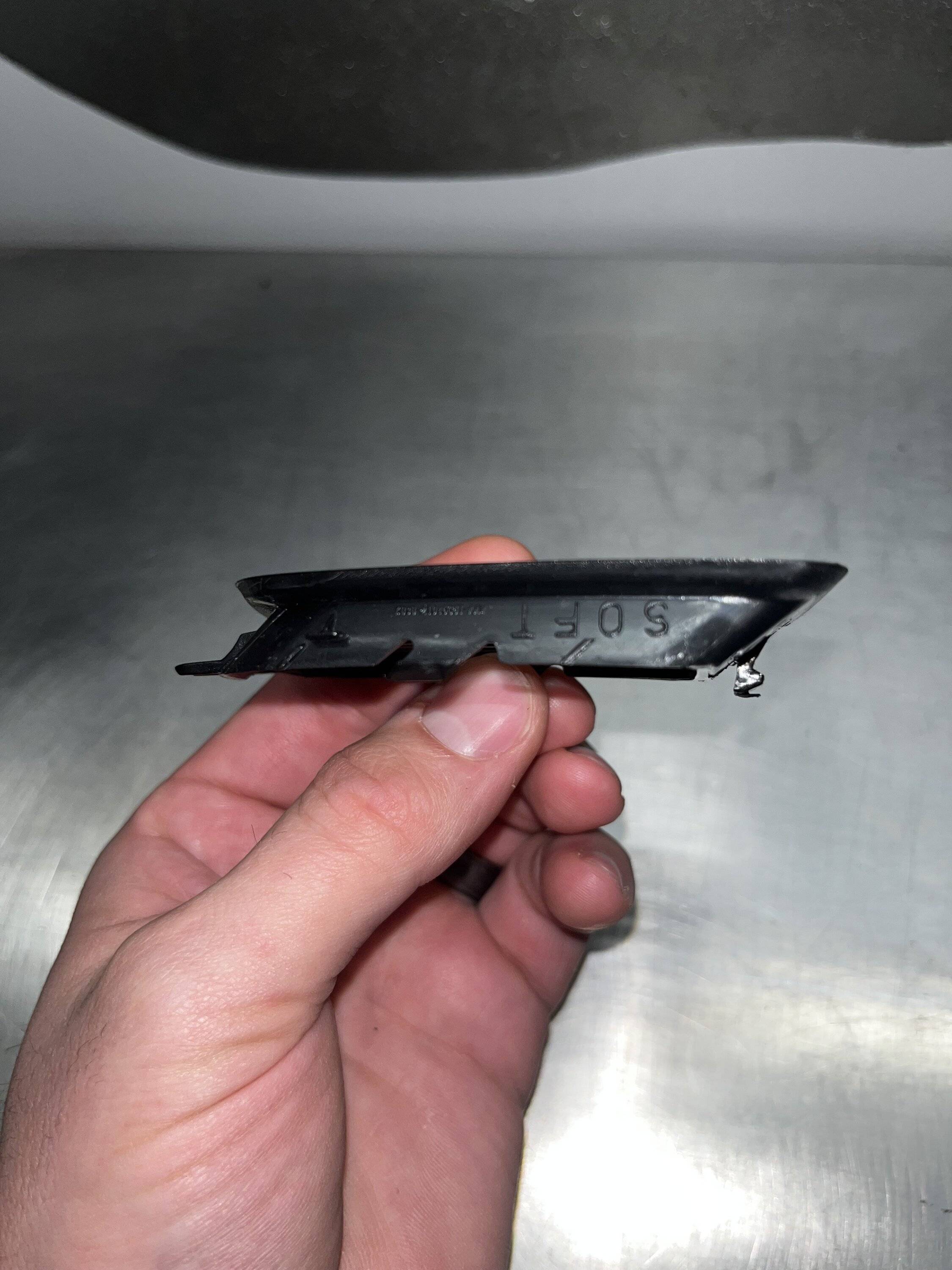

Hi guys.
I am also adding the vent gauge pod to use with the Banks idash gauge. I have a 2022 fx4 xlt and when I tried to pop out the vent piece it seems to have been glued into place and I had to cut and pry it out. What a mess!
went to Ford dealer and they confirmed that the vent is not a replaceable part….you have to buy the entire dash pad!As I looked at your pics it’s obviously a loose piece and it looks like there is a part number molded into it. Wondered if you could supply that number. Would like to buy one just in case I ever sell the vehicle and pull the banks gauge out. Thanks for your help!

That seems strange? Why would they suddenly glue the vent in place?
KB3B-21045651-AAW
