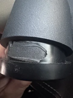

Argh. Hundreds of dollars in custom equipment and freakin' electrical tape to make it fit. I know what happens when it's been exposed to heat and sunshine long enough.
I have had mine for about a year now, I think, and it hasn't changed at all. Still a snug fit.

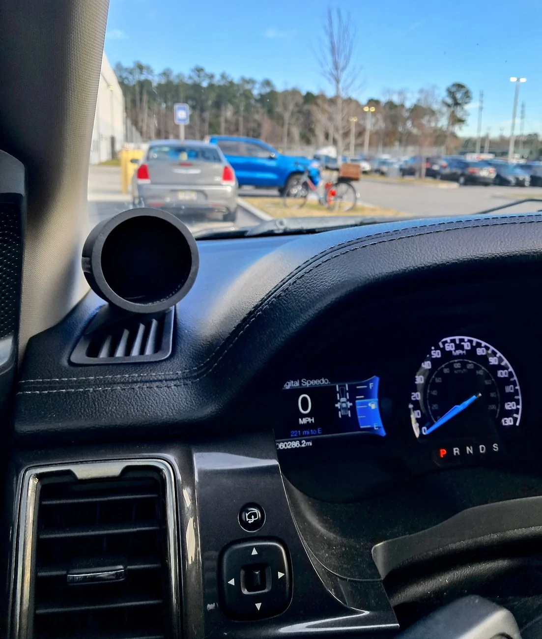

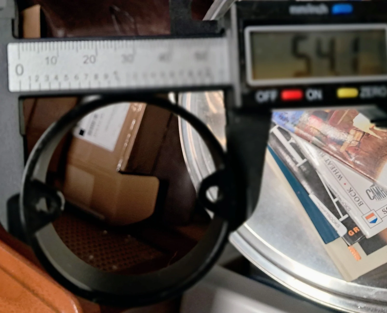

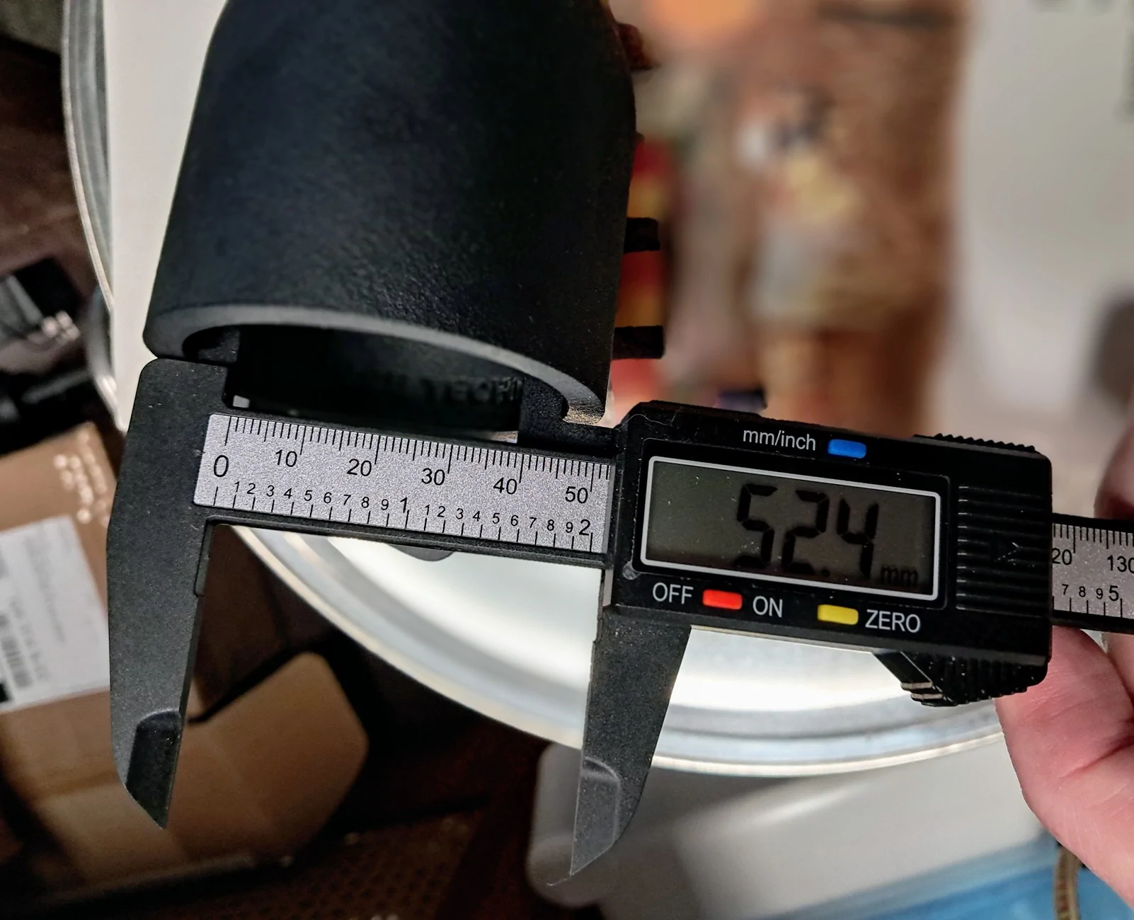

Here's the opening of the Aeroforce in millimeters:

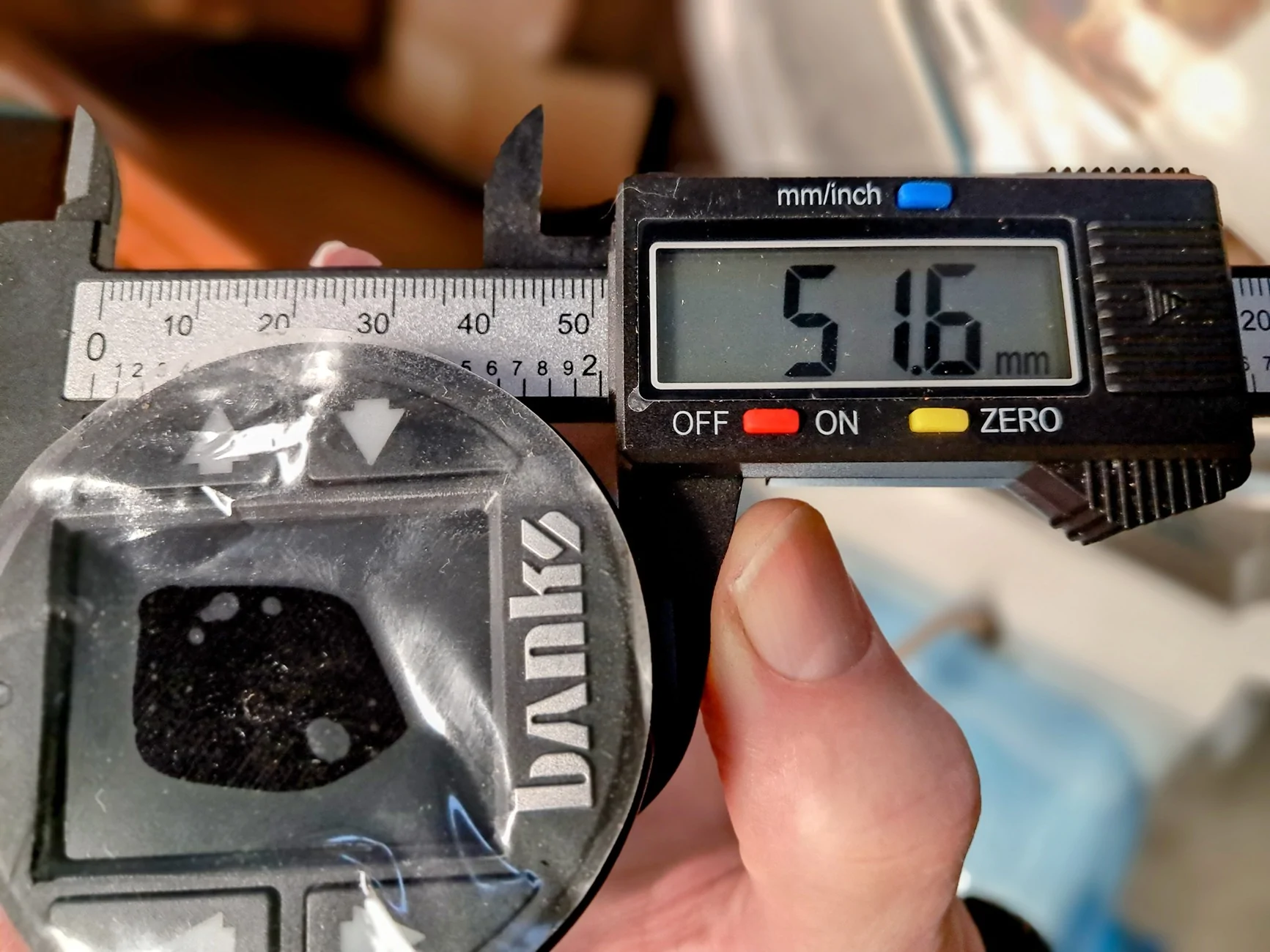

The Banks i-Dash without the adapter ring:
And the adapter ring, which looks like what I'll have to enlarge the Aeroforce to
(I'm not thinking of using a millimeter + of electrical tape, don't want adheisive melting in the summer heat and weeping out)
I just have to figure out a precise way to route it out 1.7 mm in diameter...

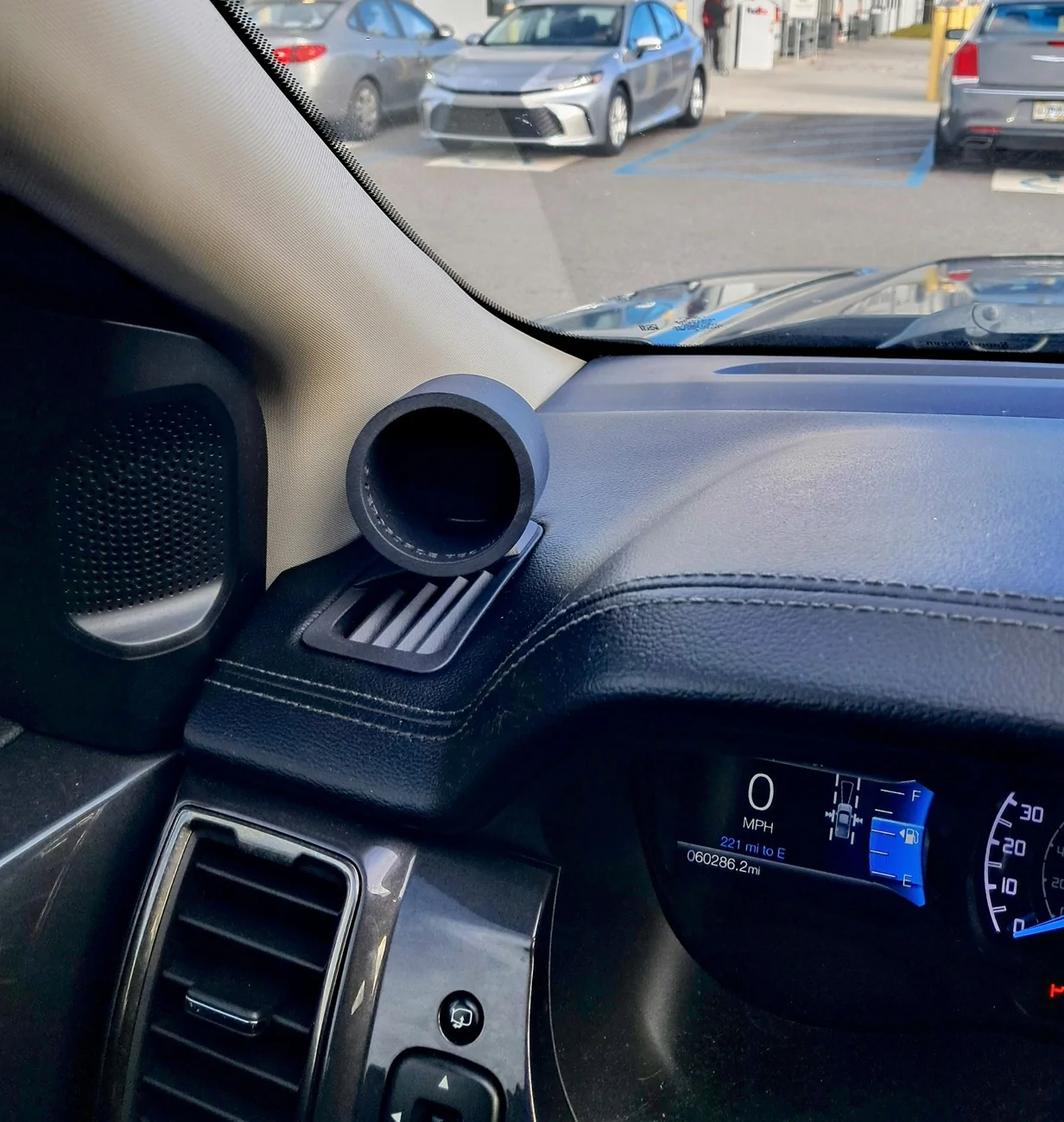

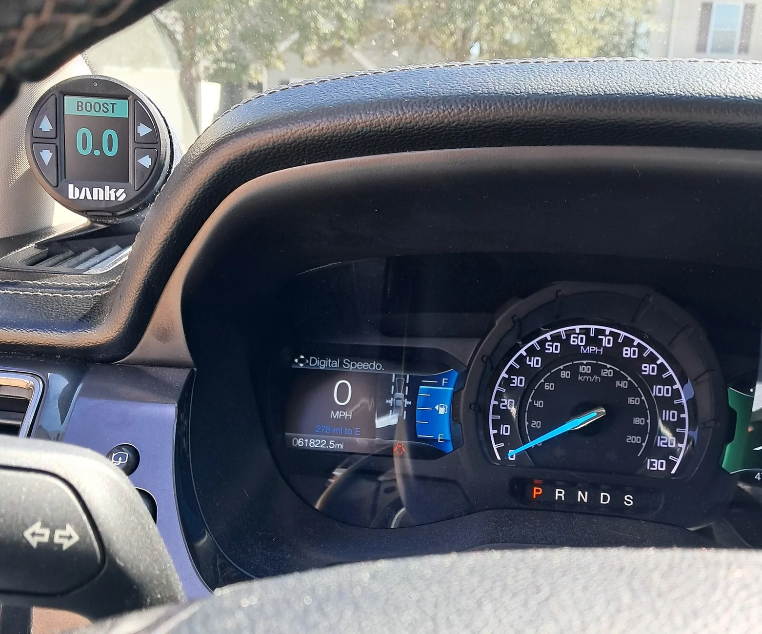

The Aeroforce gauge pod is a top quality accessory- the size an orientation is great.

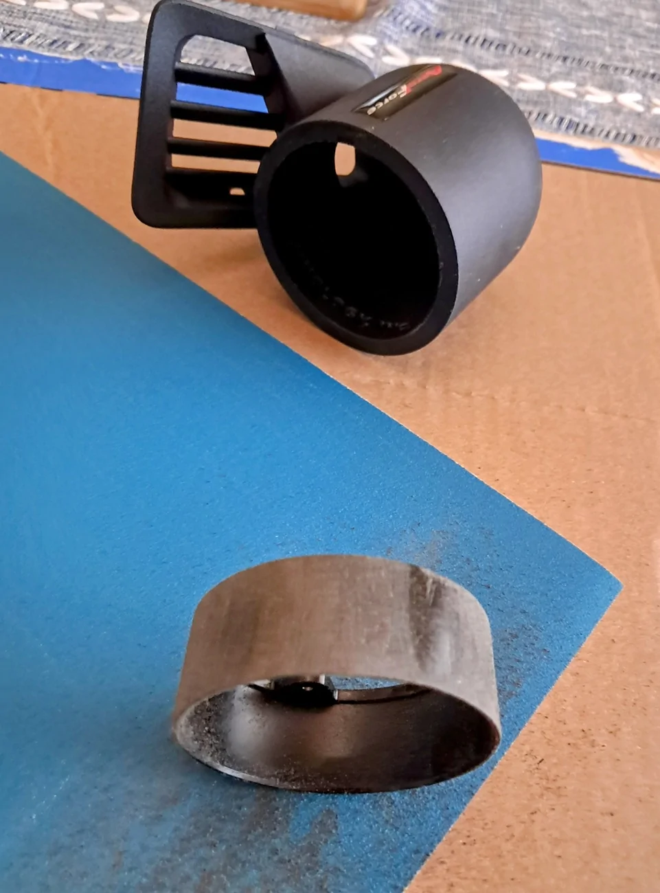

And as I reported before, fitting the Banks i-Dash Pro needed some work. I wound up hand lapping the too big $10 Banks adapter with sandpaper with a little work on the Aeroforce with a file to make it fit.

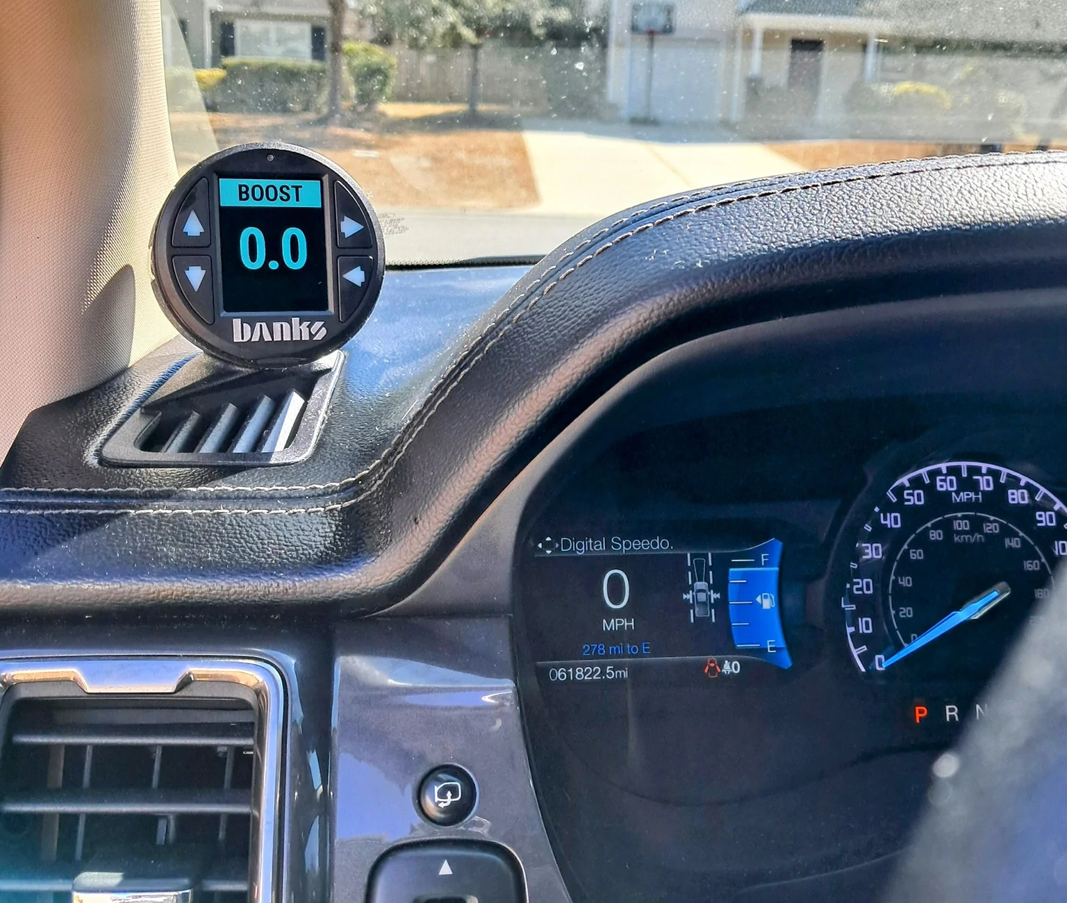

Got it all together and now I'm starting to play with settings.
All I had to do to run the cable to the gauge was pull the trim off the windsheild pillar and I used a pry tool to hold the dash while I slipped it through.
Everything snapped back together.

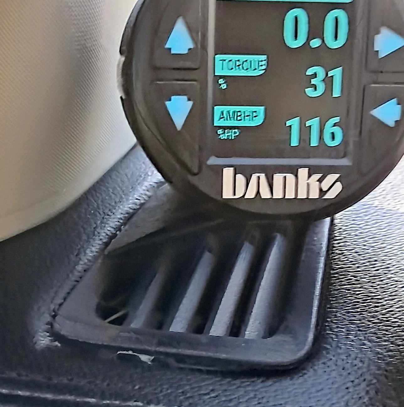

I'm trying the soft putty to set the guage securely and so far not that impressed. Must be a better solution.
Been driving with just the boost guage and liking the data (if I can trust it) and using it to adjust my driving.

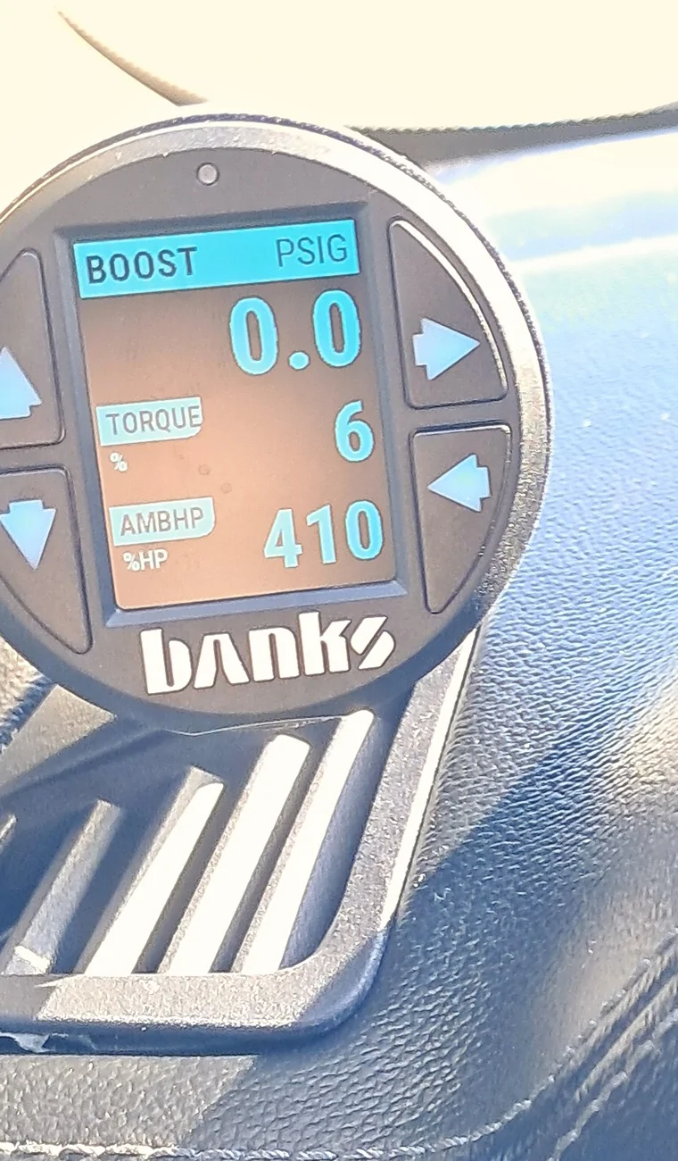

Now I'm playing with gauge settings for HP and torque output...
But c'mon 400 HP at 0 boost? πŸ˜†
Weird because that is a reading for the percentage of available power based off of that moments air density. 410% ??

If it's an expression of % and no calculated value it's confusing.
I'm running a tune, probably snapped this pic at modest throttle.
