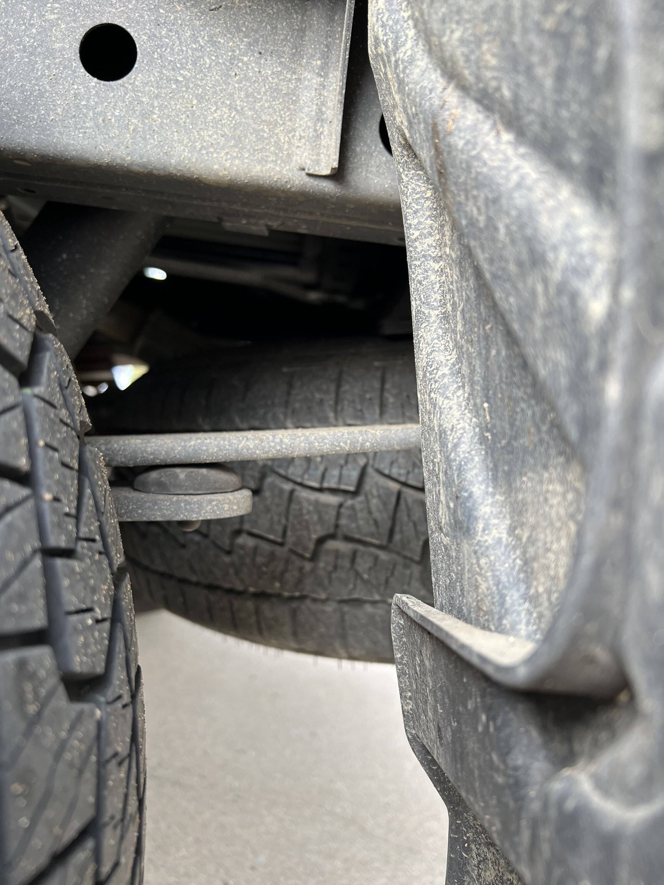

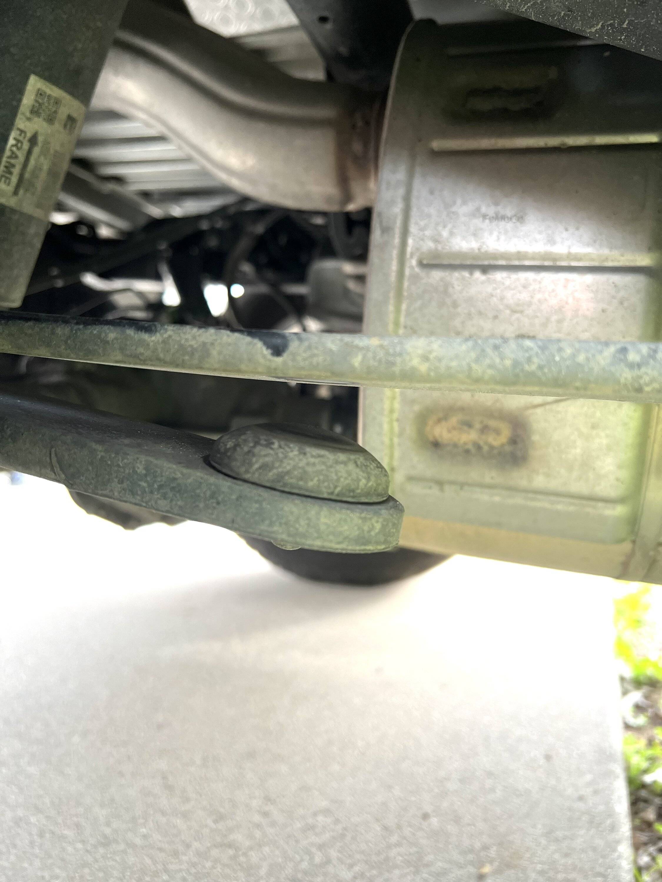

Here’s photos that may be informative. The one with almost no space between rubber bushing and spring is the low side of vehicle. Both pictures are at rear of vehicle. Couldn’t see any cracks or breaks but haven’t had it off the ground yet. Perhaps there’s a break where the two springs meet at the axle, which I can’t see until lifting it off the ground.

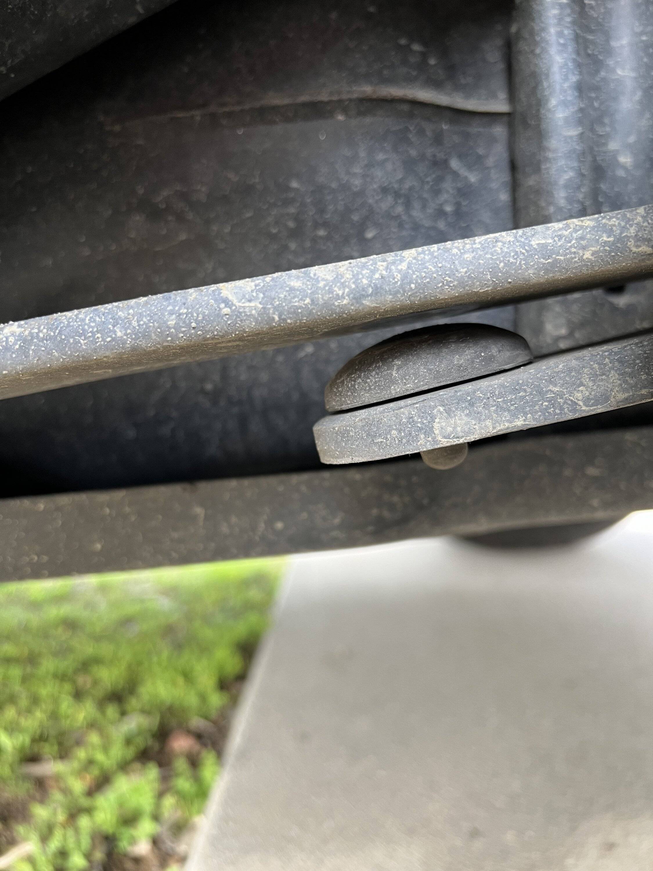

Actually the second picture is at the front of the wheel on passenger side. This new picture is at the front of the wheel on driver side. Note the spacing between leafs.
