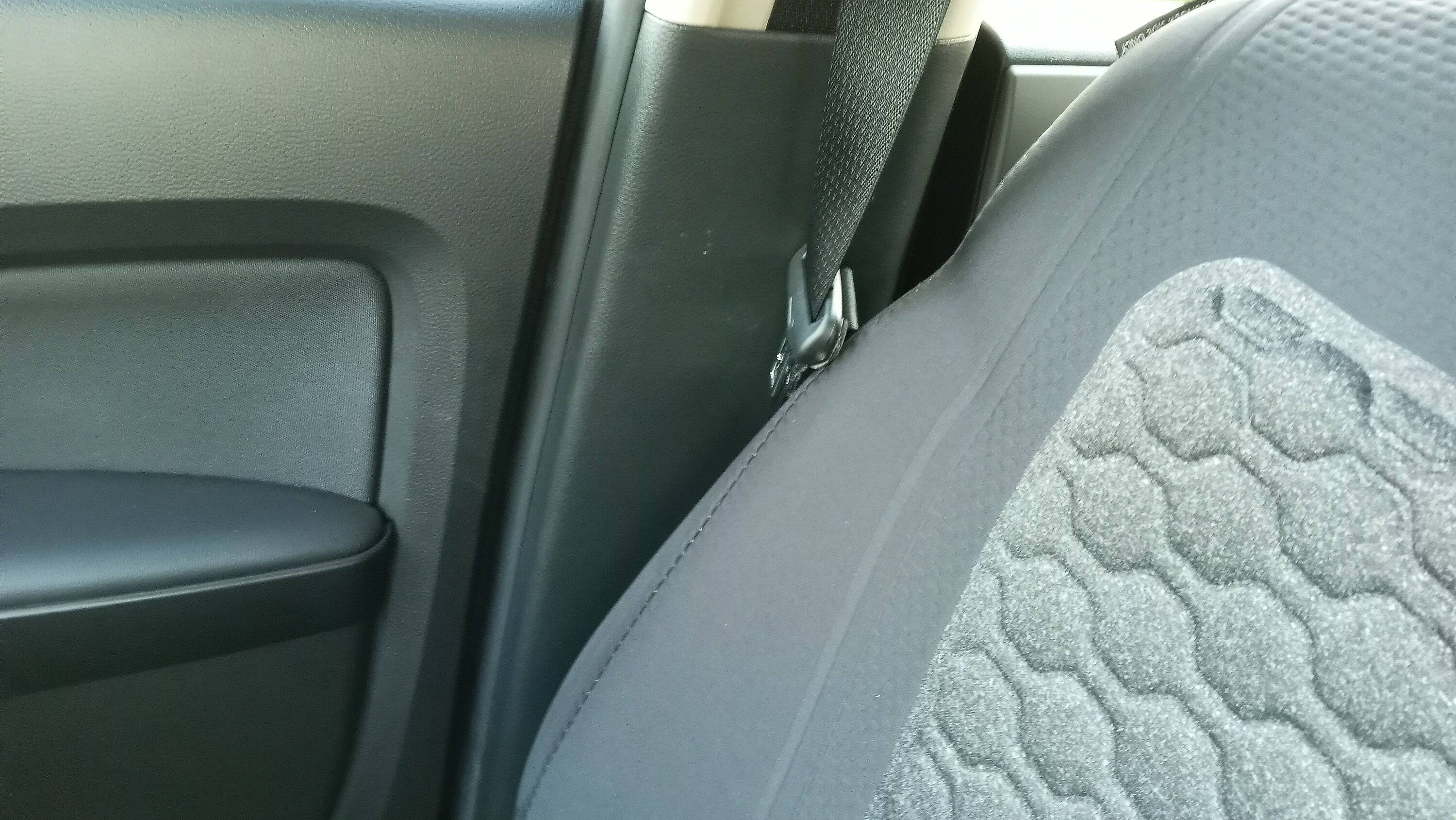

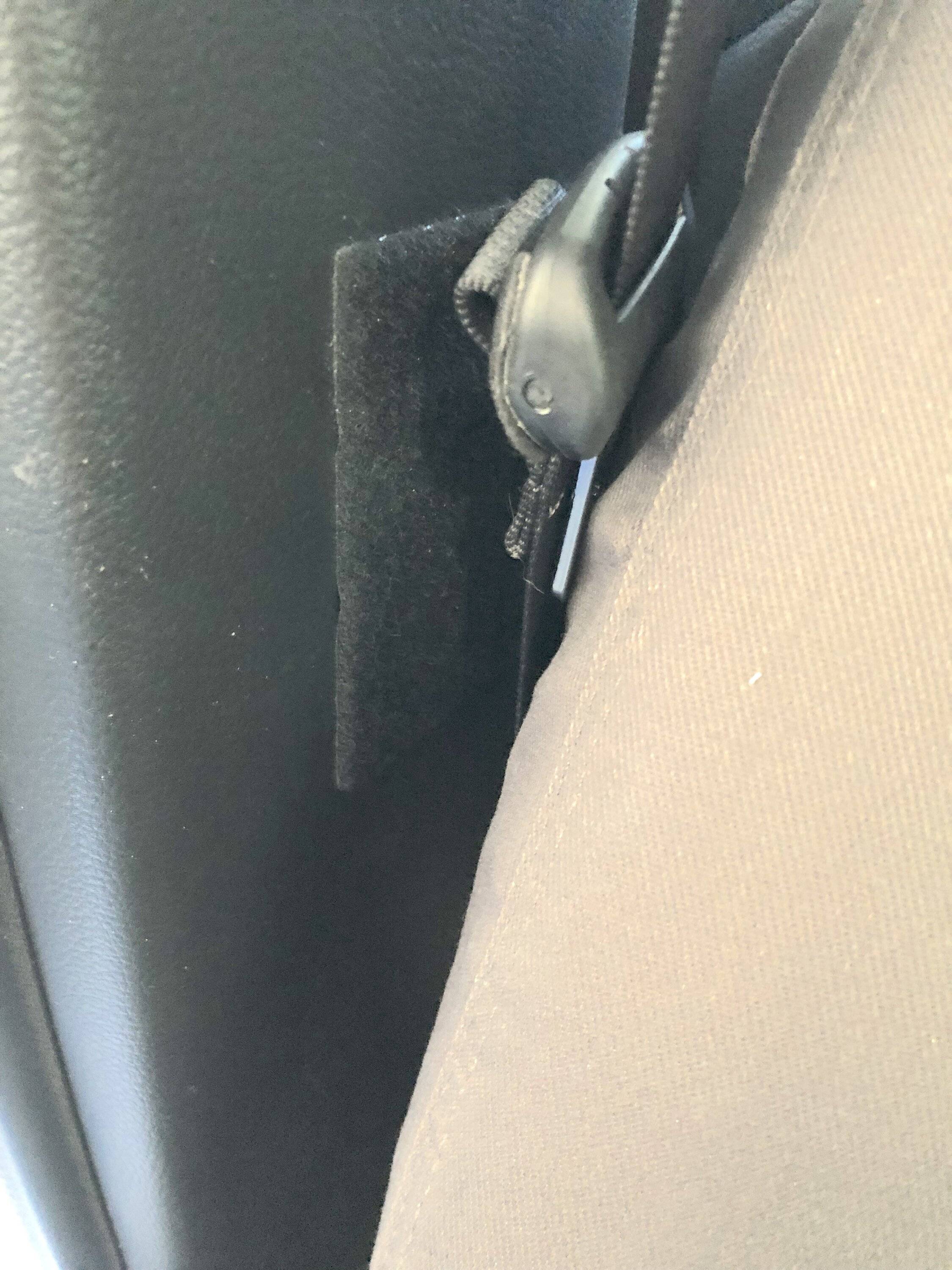

Has anyone encountered/fixed a rattle in the B-pillar? If so, can you share any tips for accessing and taming it??
Thanks!
