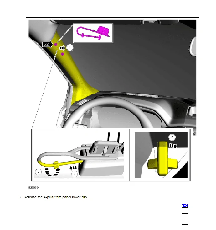

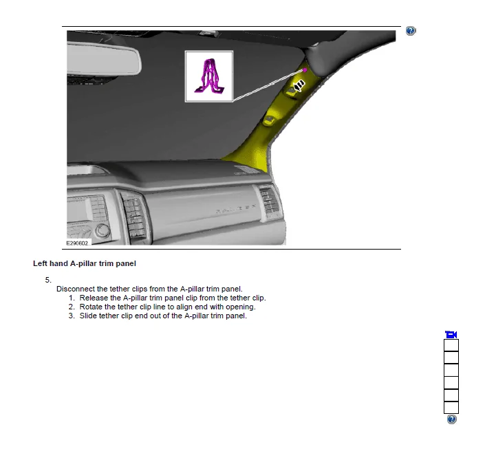

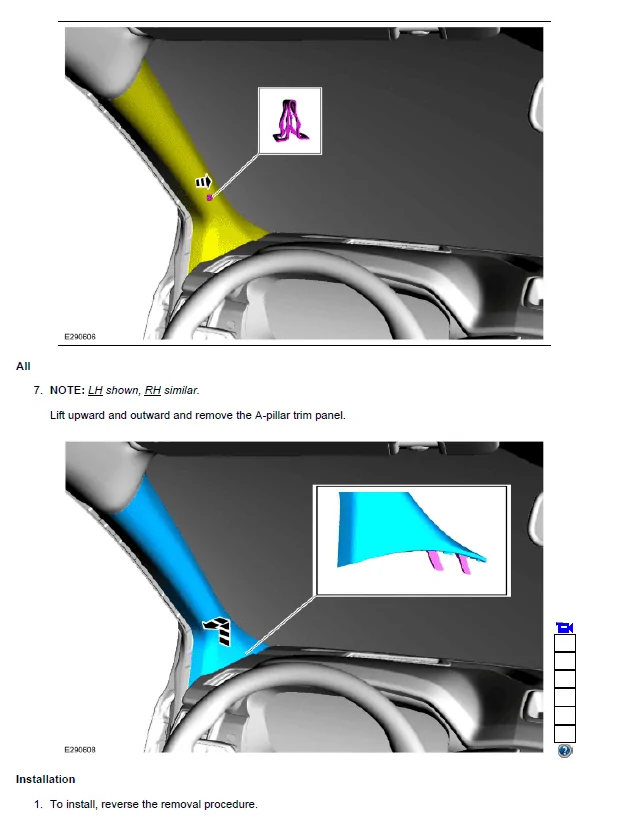

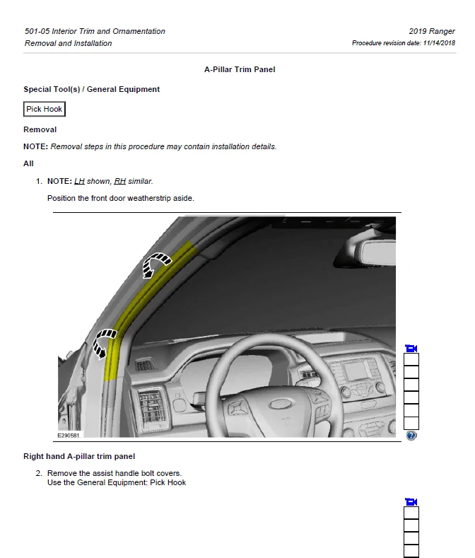

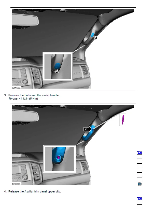

Hey yall, getting ready to install my dashcam this week. But i cant seem to find any info online on how to remove the a pillar trim. Before i just explore it on my own and risking dmg, figured id ask first. Whats the safest way to remove it?

I finally got it, sometimes i just gotta stop worrying about damaging shit and rip it out haha
