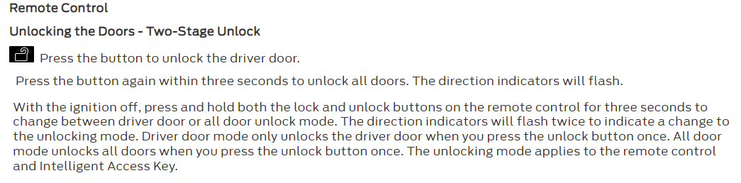

The tailgate does automatically lock and unlock with the doors. If the truck configured where you have to push the unlock button twice on the remote, once for the driver door, once for the rest, then the tailgate will unlock with the rest.
Peragrin
Sep 16, 2021
378
975
Fitzwilliam NH
2021 Ford Ranger
Purchasing
I'd like to see the tailgate lock operate with the door locks. I haven't modified my locking scheme but wonder if there is a FORSCAN setting to unlock the bed when the passenger doors unlock. Right now it's a separate action?
in the Dash settings there is a switch for unlock driver door, or all doors with a push of your remotes button.
the all doors unlocks the tailgate. you push twice to unlock all doors and tailgate if you have it set to driver door first.
I unlock all the doors as I have kids and car seats and it makes life a lot easier.

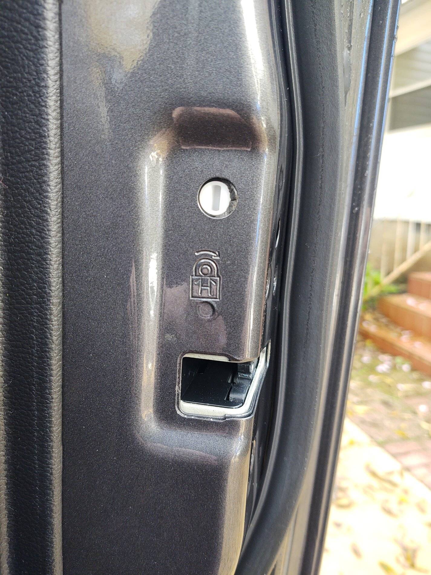

Apparently - due to previous experiences I have the all doors unlock disabled. And here is the child proof rear door lock:
