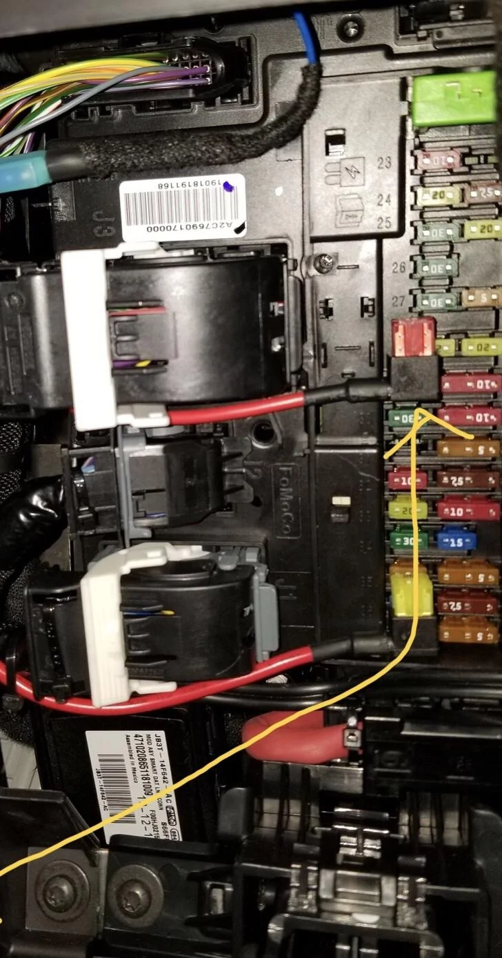

This is correct. I had doubts myself and confirmed it with @j0shm1lls who wired his correctly. He also posted the correct way to wire it in the thread and mentioned it in a post.
Wish it would have been corrected!
Can you explain what you mean why it’s incorrect? If I interpret correctly, the blue fuse in the picture should be pointing up when corrected. Can you provide the link where @j0shm1lls posted the correct way?
Correct is pointed in the other direction. I never bothered to take new picutres. It was discussed in the thread.
Sorry i missed this.. the correct @j0shm1lls way.
