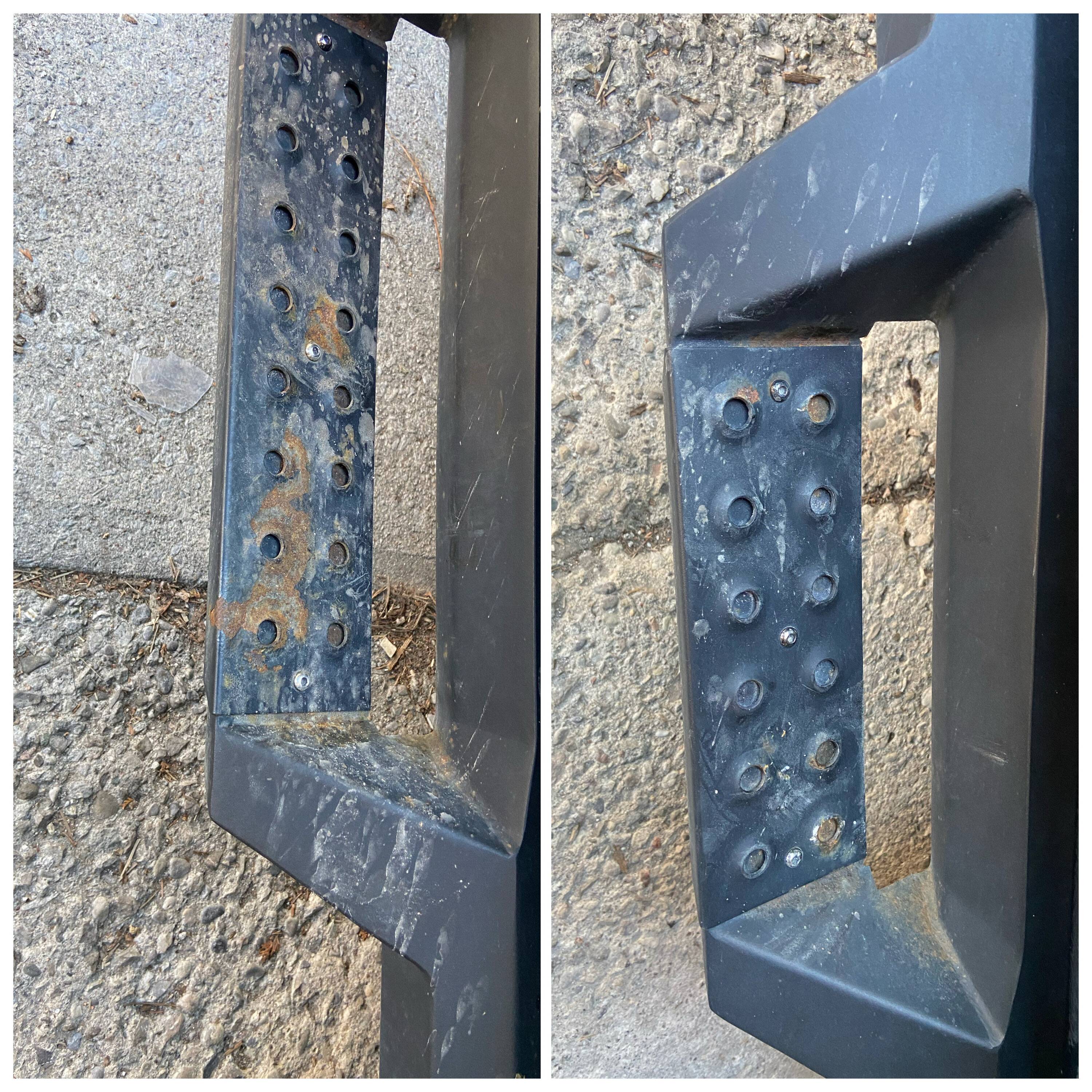

Any rock sliders out there that don't rot?

boy. thats several years worth of rust for my area. at least the manufacturer is working with you to fix things

Living in south Tennessee I hardly see any road salt and such but my rocky road sliders have held up great! I agree that lining or possibly even powder coating may be your best option if you want to keep the ones you have. If not and you are looking for a replacement check out rocky road in Utah. They are jam up!

I have the same sliders and the only rust I have is where I smacked the snot out of them and took the powder coating off. Basically, I used them and have to deal with the upkeep.
Do other people in your area with different brands have rust issues? Environment plays a factor. If others have the same issues, I don't think its a brand issue.

I see some rust on various vehicles but I’ve never noticed any sliders being super rusty. So, yea, I may be way off in offering another option of slider but I also suggested line-x (or the like) or powder coated.
The brand I suggested comes with a pretty heavy “wrinkle coat” pain job that I have chipped in a few places and there is the smallest amount of rust there at the bare metal but it cleans right off and I hit it with some black paint. Again, mine have seen road salt maybe 3 times. Just offering up options.

I thought you had White Knuckle sliders? The pics show a different mounting than the WK sliders. Or am I seeing it wrong? ( WK has clamp bolts top and bottom. One of the pics shows clamp bolt at bottom and one into the frame). Also there’s a decal that appears to have the letters A & D at the end.
the companies name ends in... Offroad...
I don't want to specifically say, because the OP might still be working with them.

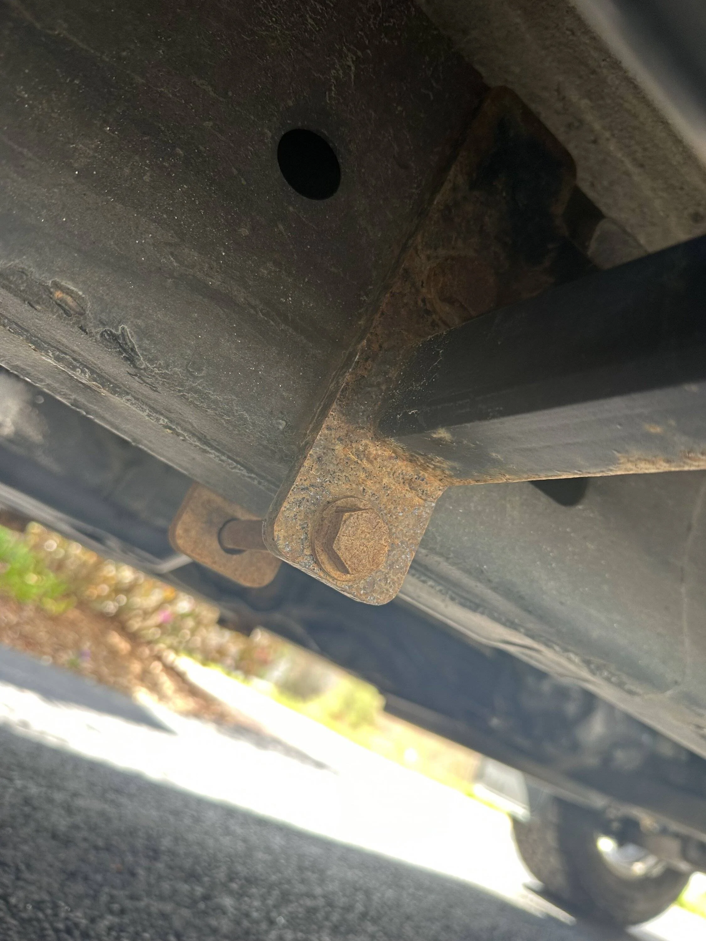

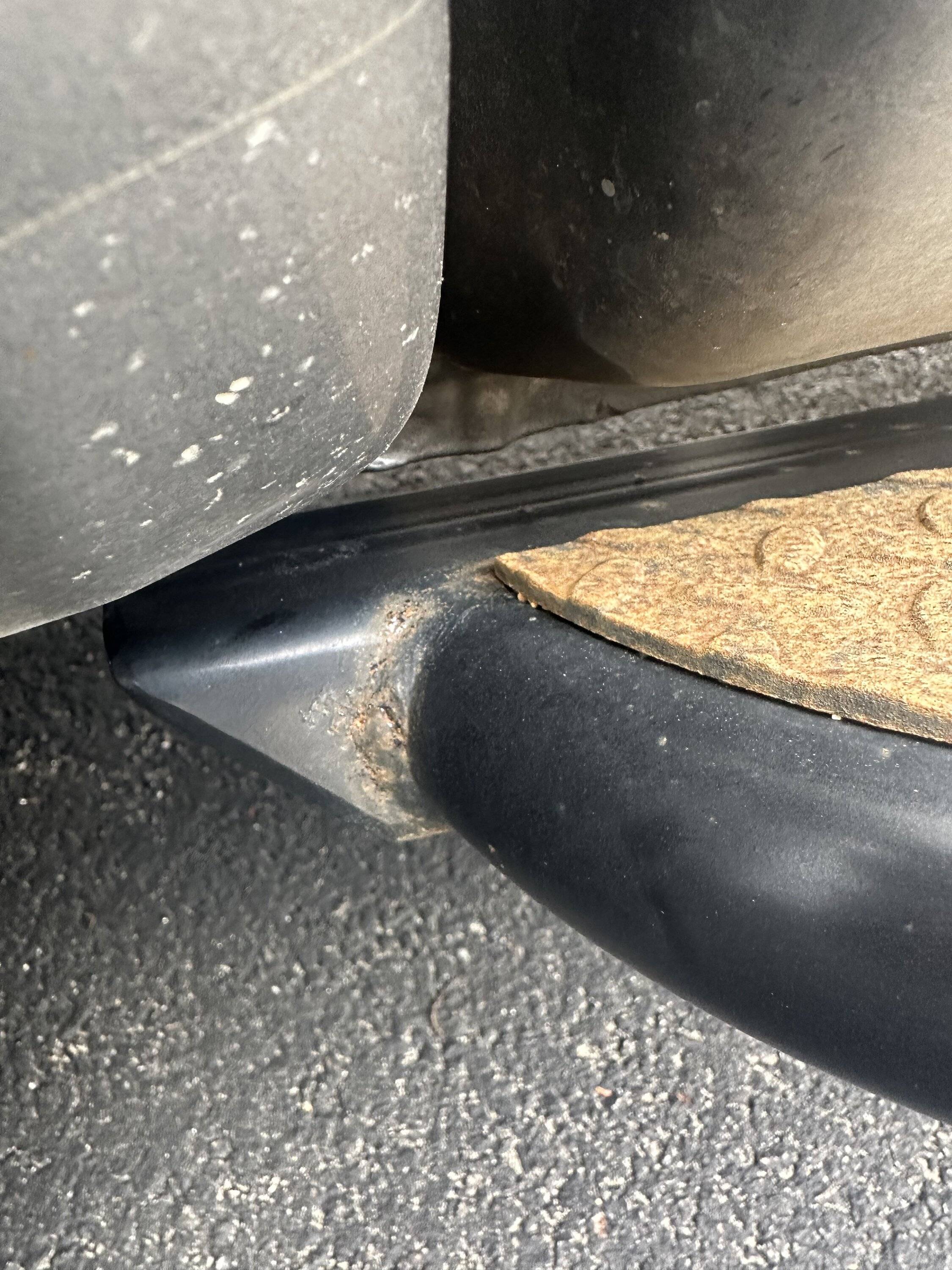

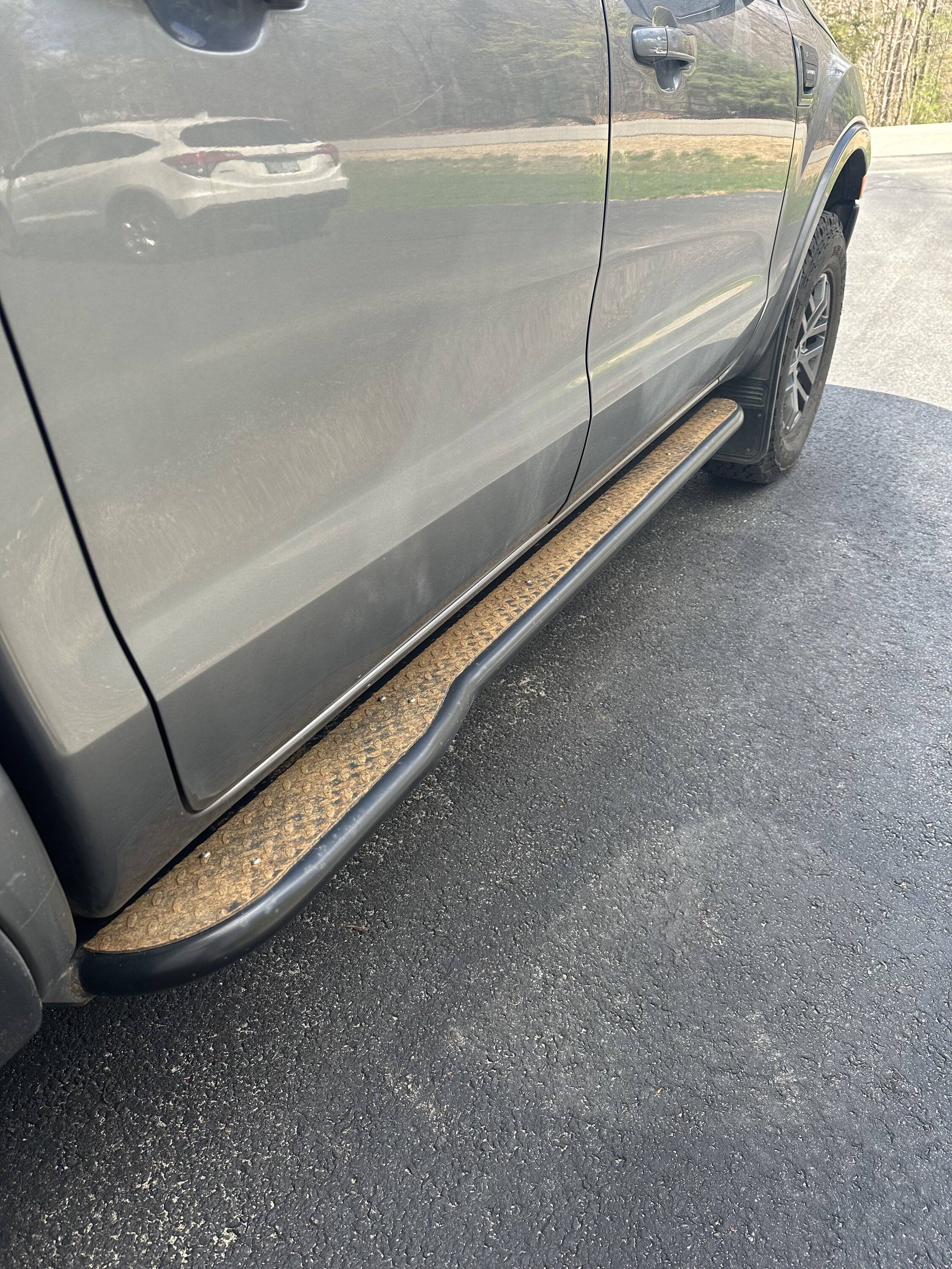

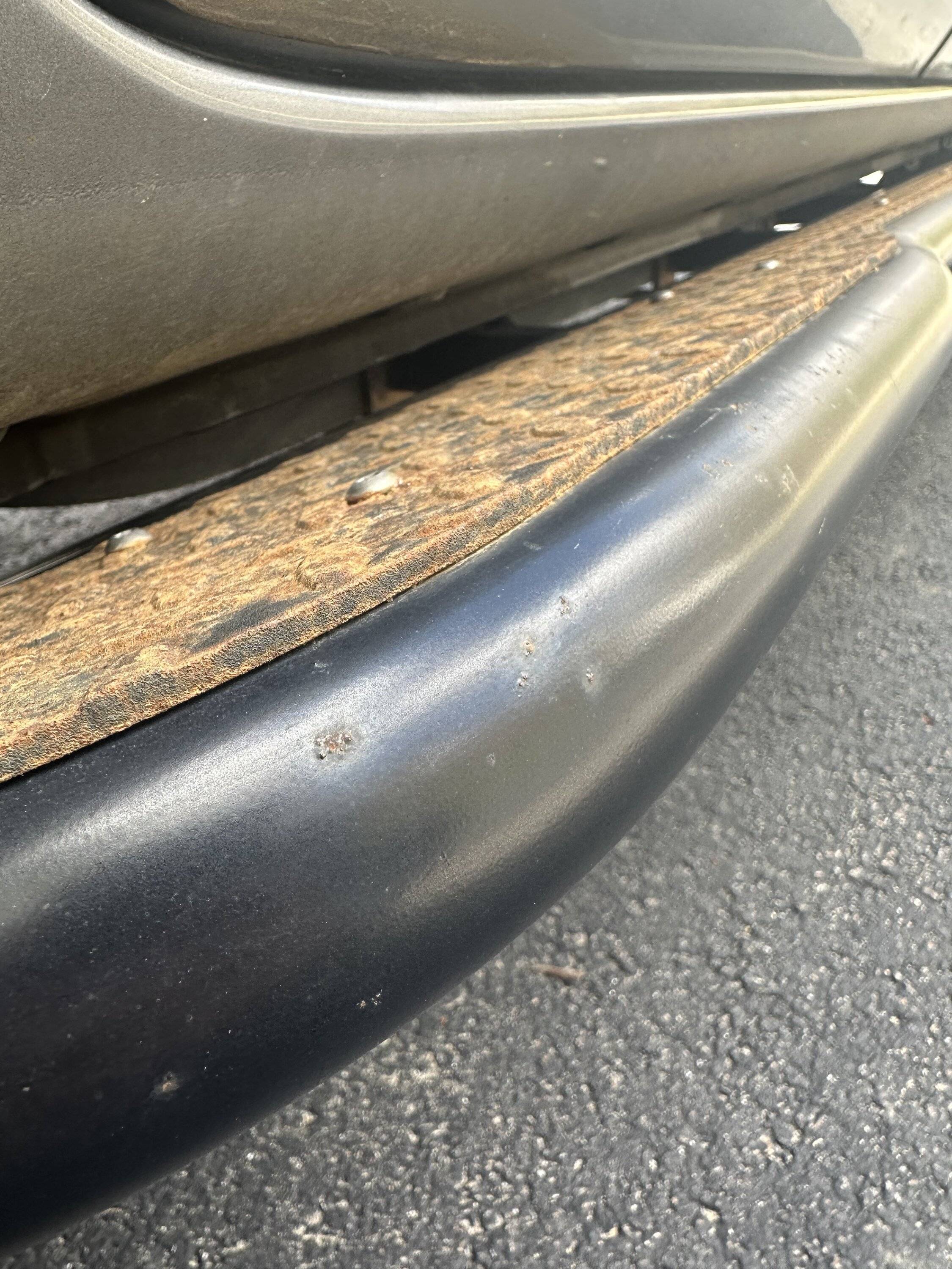

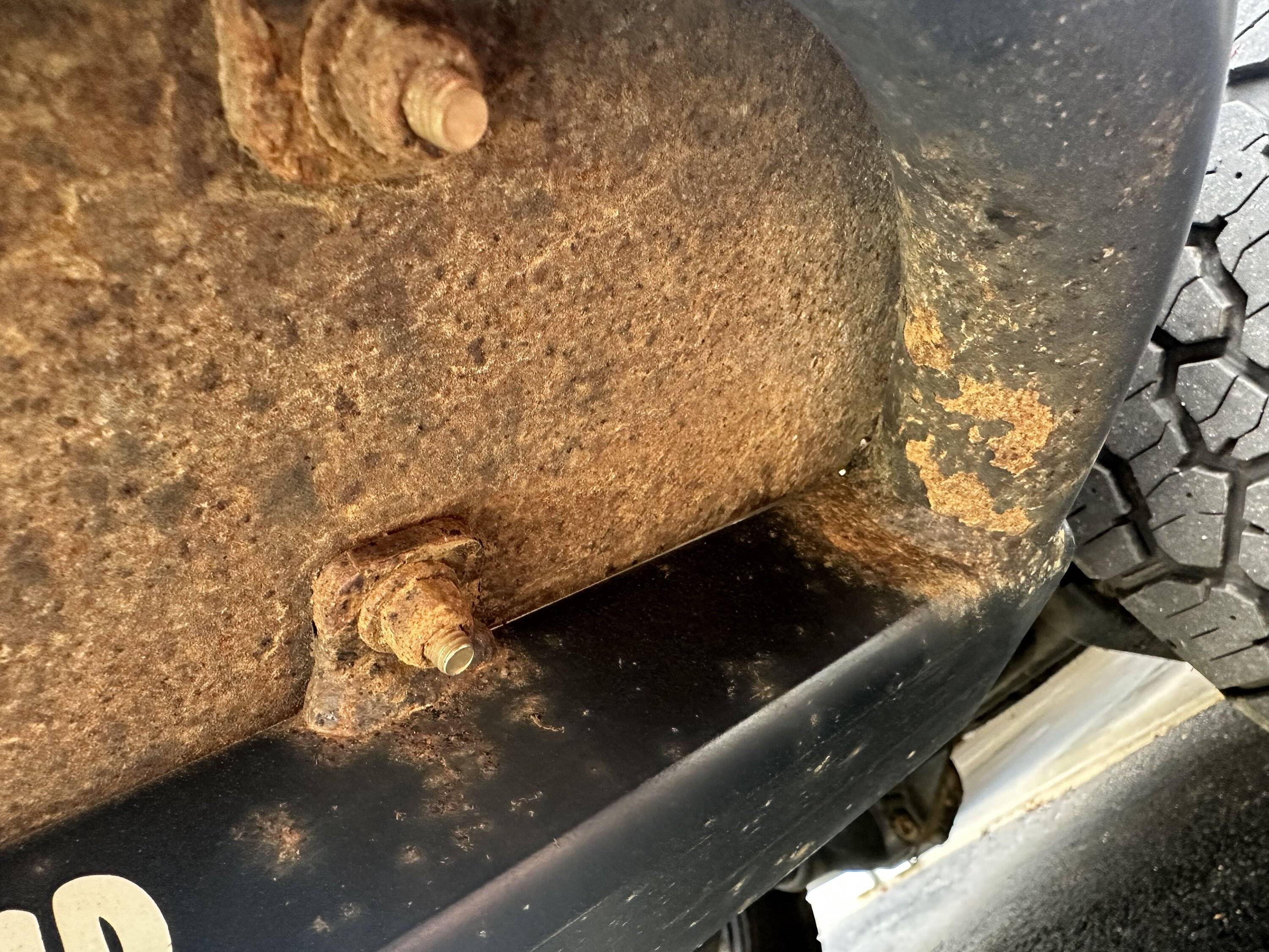

from the pictures it looks like they have the steps of manufacturing the rock sliders out of order. powder coat finish should go on each independent part, and then again on complete set to prevent welds and nooks from rusting. in the pics you can see where a lot of the rust could have been prevented with a lil more plan and time to the process.

I can confirm these are from White Knuckle. So far they have refunded me the $190 cost of the powder coat option but I haven't heard back from them on whether they can do anything else. I asked what kind of warranty is included and did not receive a response.
To address the question of how they are made. I can only confirm that the top plates and slider tubes are separate pieces that came disassembled and I had to bolt the top plates on when I installed them.
I finally found a local company that will sandblast, "zinc rich prime" and powdercoat them for $450. He seems to think they were not finished properly but will hold up with the way he would refinish them. I'm a bit skeptical but since they are local I could always go back to them if I have issues.
Now I just need to get them off the truck which might be a challenge. I used anti sieze on the bolts but am still concerned about getting them off and being able to reuse the bolts to reinstall them.
i would suggest new hardware if possible.
