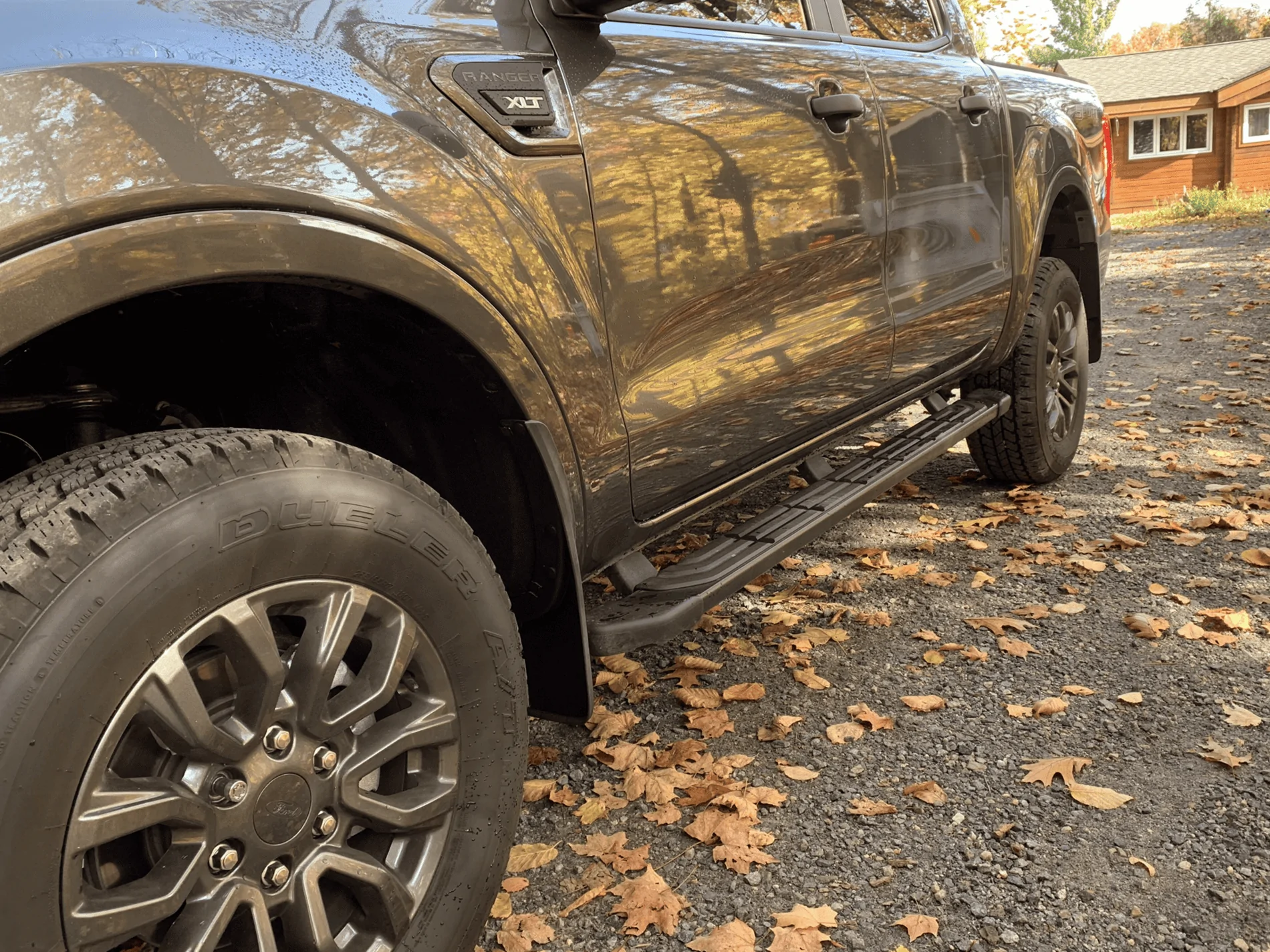

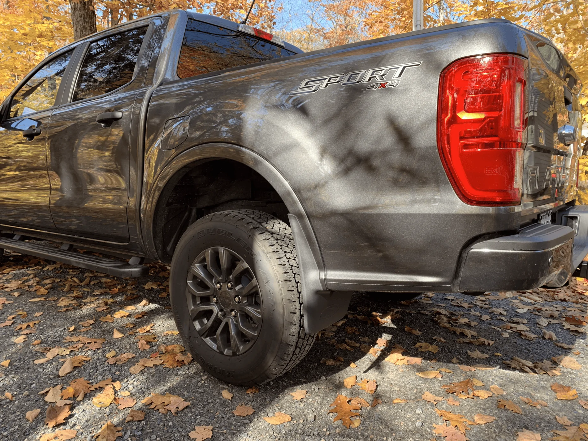

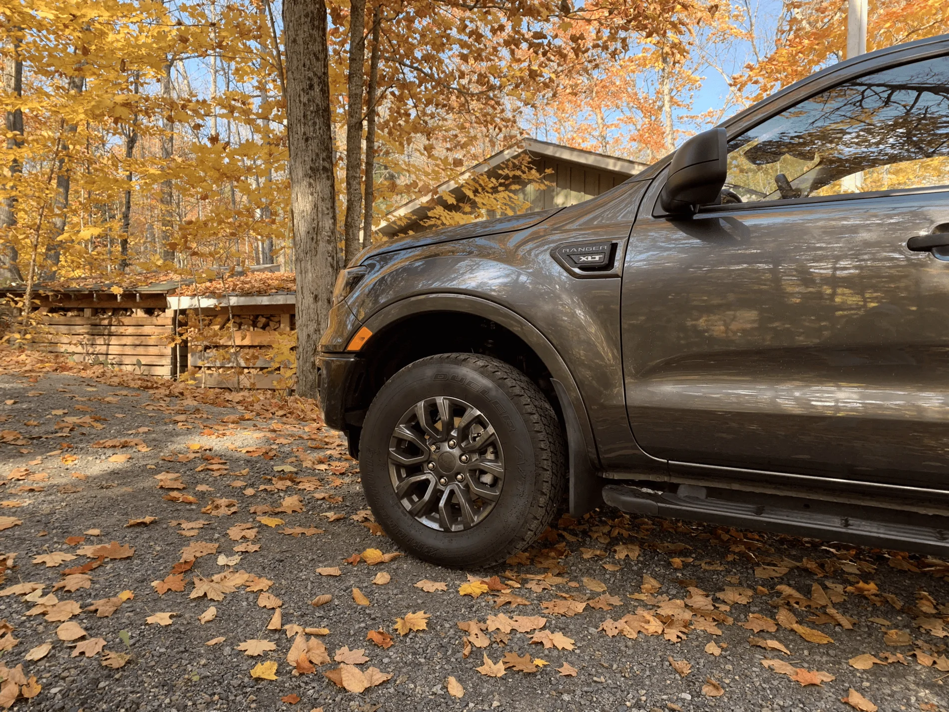

I put RokBloks on. Original size, black on black. No drilling required. They are somewhat adjustable, and I put them all the way inboard. The mudflaps stick out just a bit past the stock tire. If I ever get bigger tires, the mudflaps can be repositioned about an inch out.

Not OP but I had no trouble installing mine. Just a bit of patience with getting the lower screws into position first helped, and bending the tab on the flaps in advance makes it easier to attach. I did all four in an hour or so. :) They are kind pricey for what they are but I too like the thin style. They are easy to hose off for what it's worth.

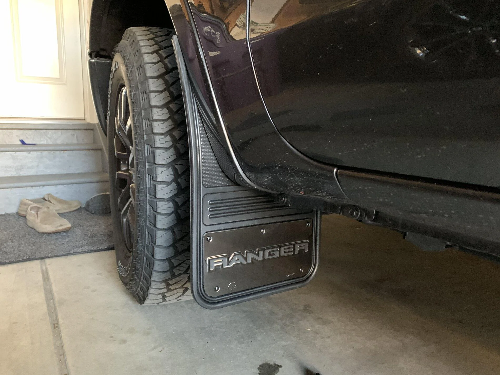

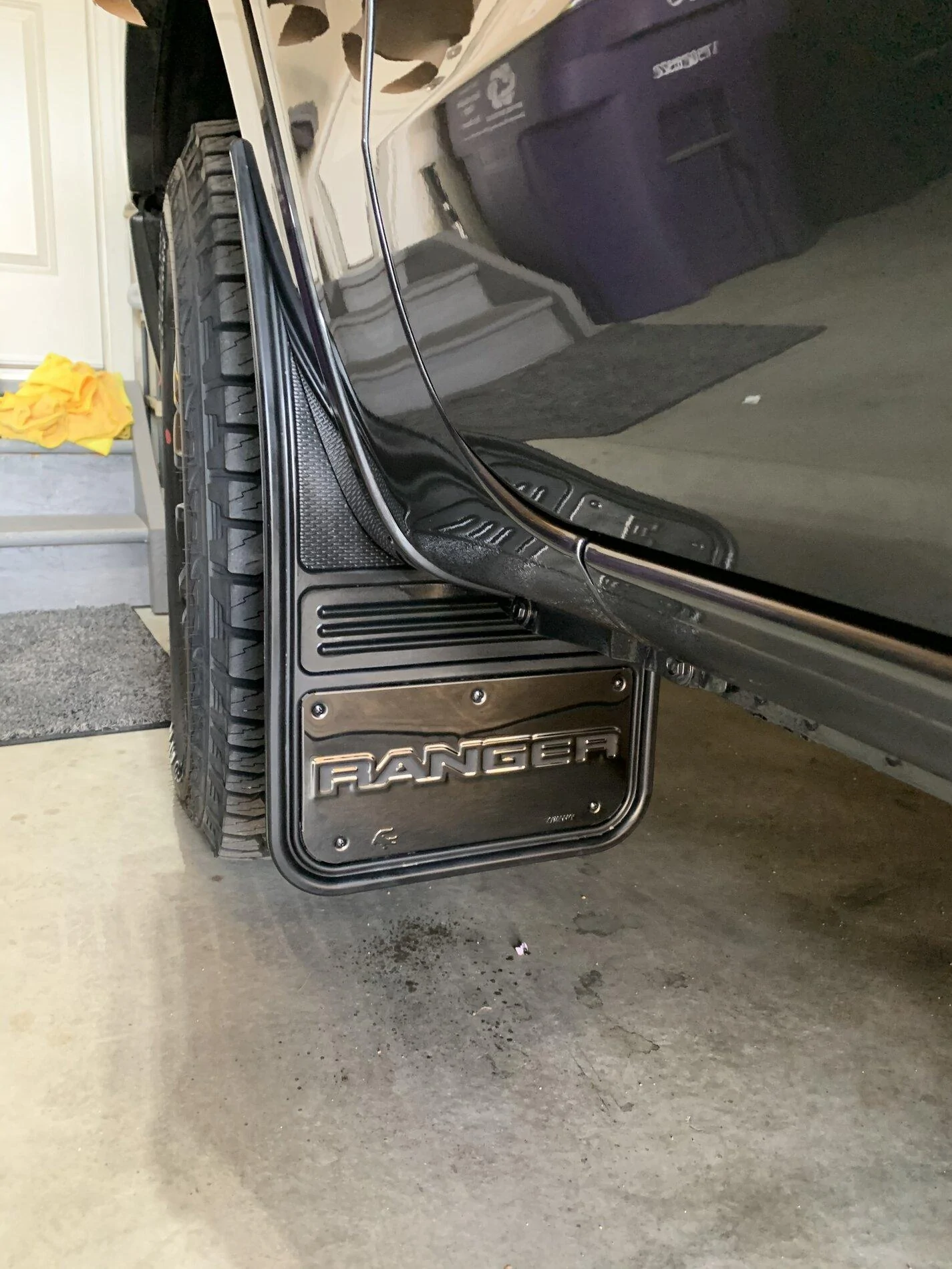

Weather Techs

Thanks! The Rokblokz were a bit fiddly to install. Make sure it's warm. I left mine sitting in the cab in the sun to warm them up. That makes it easier to bend the tab. Make sure you insert the flange nuts into the backing plate correctly. I spaced out on one and inserted the flange nuts from the front side instead of from the back side. They pulled out as soon as I tightened the screws, but that was easy to fix by reinserting the flange nuts correctly. One problem I had was removing the OEM plastic inserts that screw into the wheel-well liner. You're supposed to remove them and use new inserts provided by Rokblokz. They come out by loosening a metal screw and then pulling the plastic insert out. On one of mine, the metal screw just stripped the plastic insert and it was really hard to remove. All in all, it took me about 2 hours, I think. I used blue loctite on the stainless screws that go into the flange nuts. I'm happy with the result and I think they are top quality.

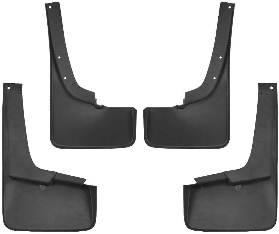

I got Husky brand on the way. Anybody use these?
