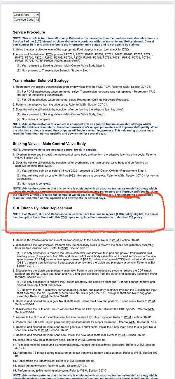

They will most likely follow the TSB 24-2101 steps.
1st is reflash the software
2nd is clean/replace the valve body
3rd is replace CDF drum or replace transmission under the LTIS ( low time in service) policy.

Mine was an early March 2022 build. They put a new transmission in it at around 18K miles. This was after they did the initial steps of the TSB

Well after a bit of drama the truck did its thing and they went straight threw all the steps. New Transmission has been ordered but no ETA yet. I am driving it till they tell me the trans come in and then I will drop it off.

well good news. new transmission came in within a week. they had the truck for about a day and a half. drives like the day I got it again even when cold. Tech in his notes mentioned the transmission fluid was very discolored. Very impressed with the service. Let's hope I can put trans issue premently. Let's see how long this one lasts.
