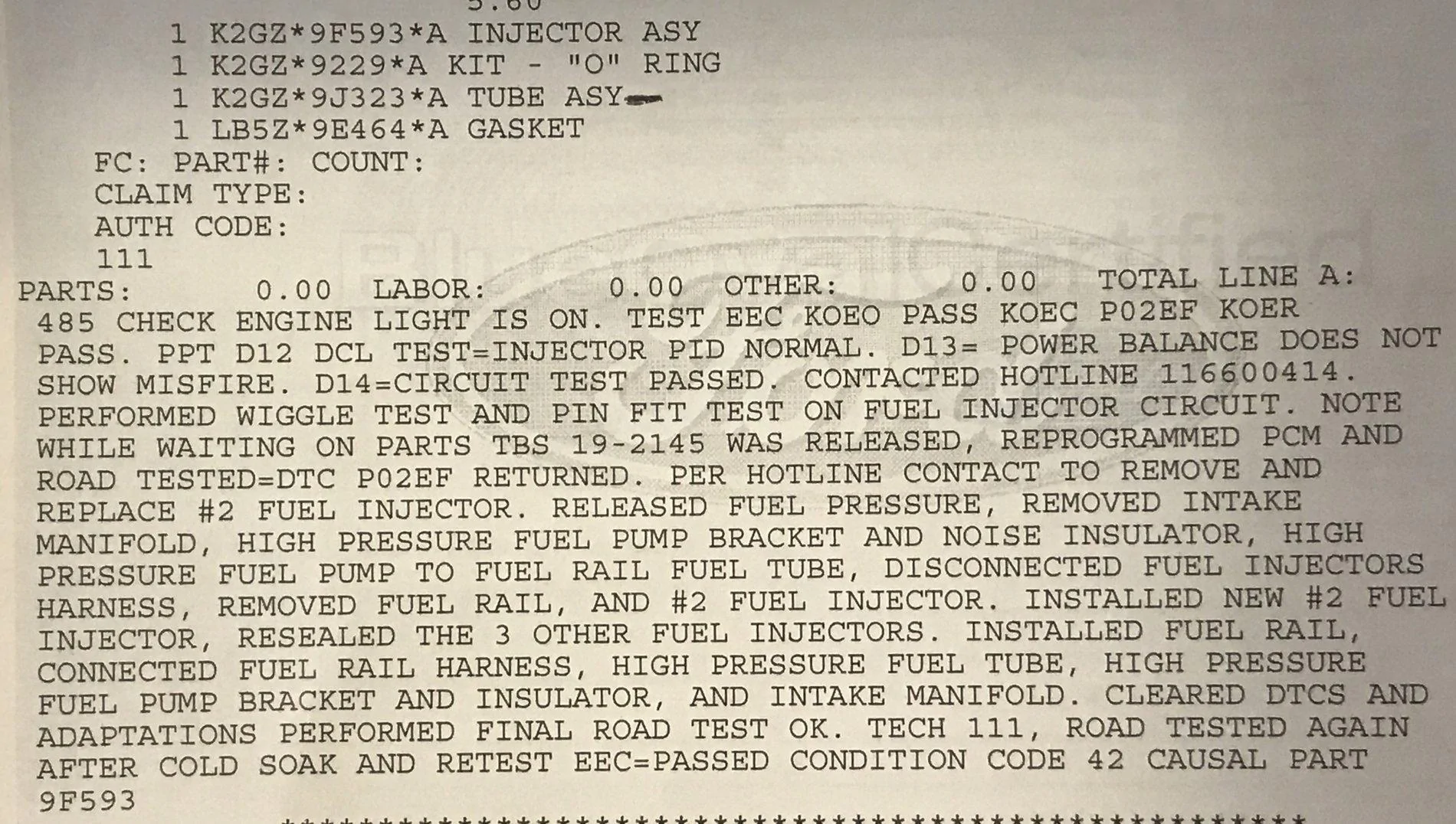

I posted my saga under the bad fuel injector thread. I all too well know your pain having lived through it. Here is the repair summary from the dealership. It was in the shop for 23 days. The delay was the Tube ASY part. Good luck to you, I made it through this mess, you can too.

Ranger Saga update:
Quick recap.
  • Ordered from dealer 23 Jan 2019 (Wednesday) and delivered to dealer 15 May 2019 (Wednesday) (about 4-months)
  • Picked up from dealer afternoon 16 May 2019 (Thursday)
  • Returned to dealer morning 17 May 2019 (Friday) for maintenance service light illumination at start up
  • I called “Big Ford” afternoon 17 May 2019 (Friday)
  • Dealer contacted me COB 17 May 2019 (Friday) still troubleshooting
  • Big Ford contacted dealer 20 May 2019 (Monday) for status report
  • Dealer 20 May 2019 (Monday) could not determine reason for fail code XXXX
  • Big Ford 20 May 2019 (Monday) directed dealer to change #2 injector
  • Big Ford 20 May 2019 (Monday) initiated overnighted shipment of injector from manufacturing to dealer
  • Dealer received injector morning 21 May 2019 (Tuesday) and contacted me afternoon 21 May 2019 (Tuesday) Ranger ready for pickup
  • I relayed to dealer 21 May 2019 (Tuesday) I expected the truck to be represented to me as new (detailed, maintenance checks, acceptance inspection)
  • I picked up 22 May 2019 (Wednesday) and left with my “New” Ranger
Bottom line: Dealer was very responsive and accommodating. Provided me a loaner truck for use during this period. Big Ford appeared to be responsive and accommodating as well. Big Ford said they would do a follow-up with me in a couple of day via phone and then in 2-weeks via email. Will provide updates as needed.
