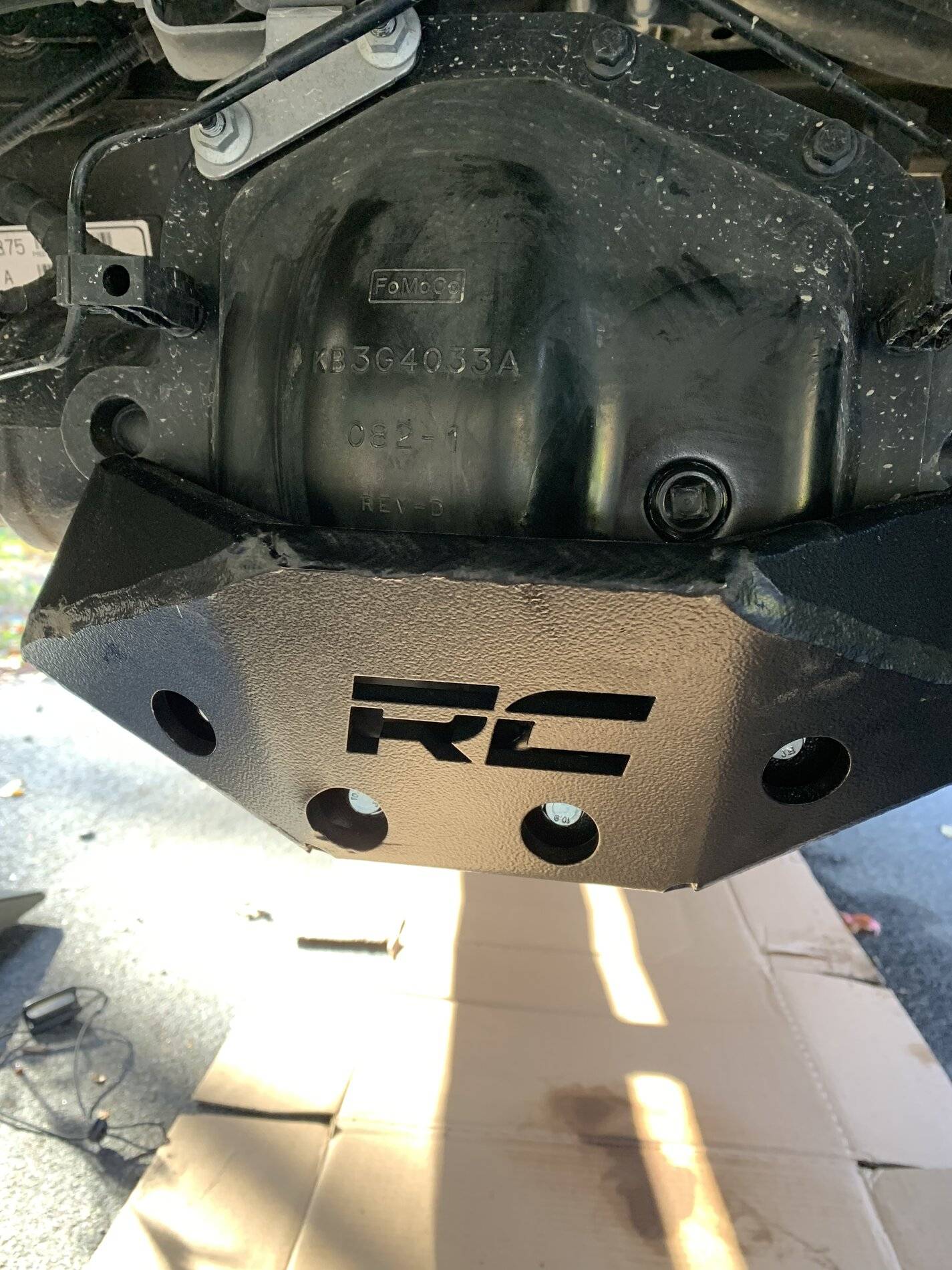

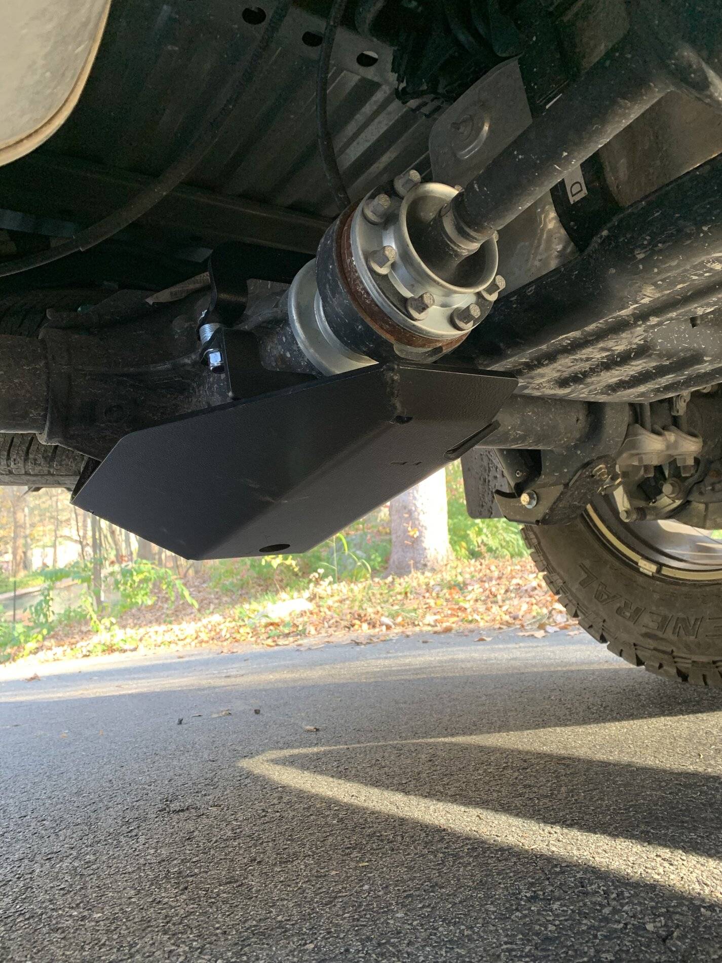

Looks like a well made product. Seems to fit snuggly. Myself I would make some SS spacers, instead of all the stacked washers.
I did some quick looking for a spacer and couldn’t find one that was right size so went the washer route for now. Will replace when I find a spacer the right size (guess I could cut one).

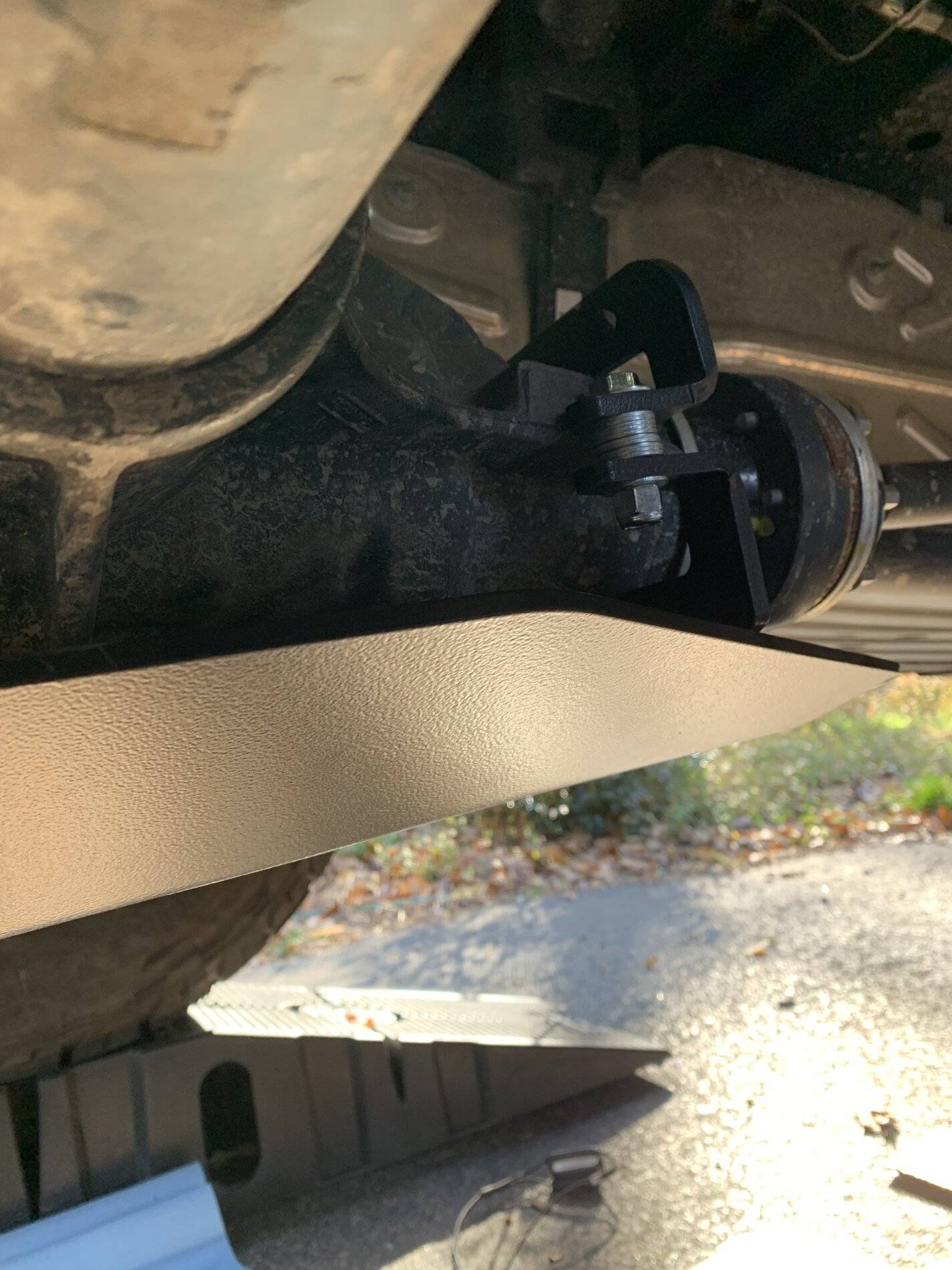

a socket might be the right size. I need to mess with mine.

What length spacer should be used?
gwhalin
Greg
Aug 7, 2021
480
1,009
New York
Roughly 1/2”

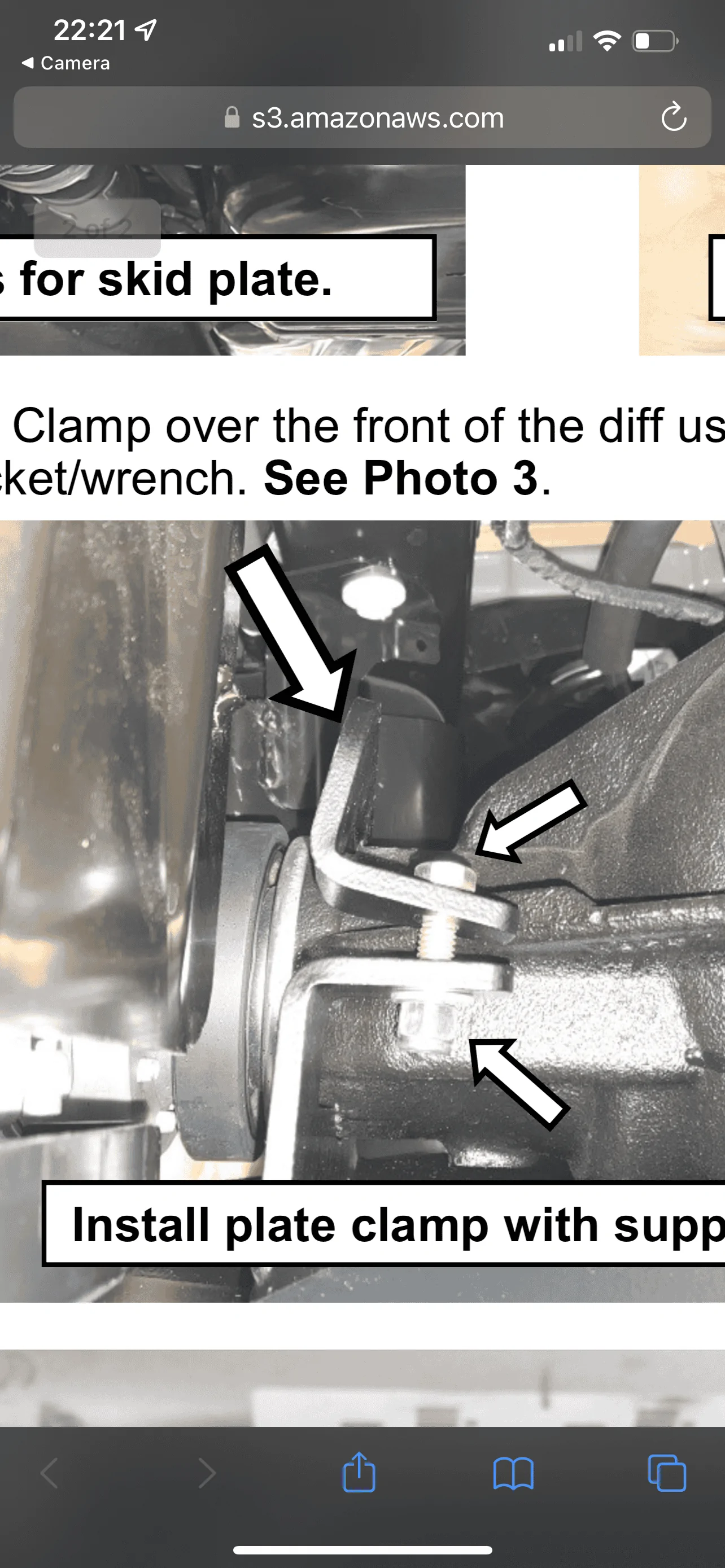

Going to install tomorrow, but curious from torque bend and spacers comments, in instruction it looks like originally it’s supposed to be a gap and a bit of bend? What did I miss :)

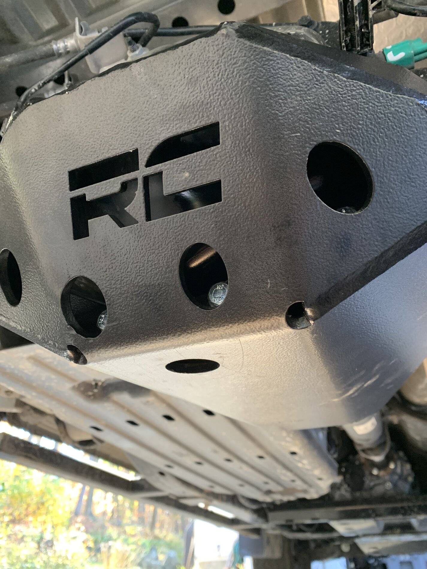

Just installed on my 2021 Tremor this morning (and changed diff oil while there). Went on super easy and fit tight. Seems well made. Don’t know if this is necessary but will definitely give me some added comfort when/if I smack this in a rock.
From what I gather, they say it should look like the picture linked above. I think we don't like that, so we feel like a spacer would solve the issue.

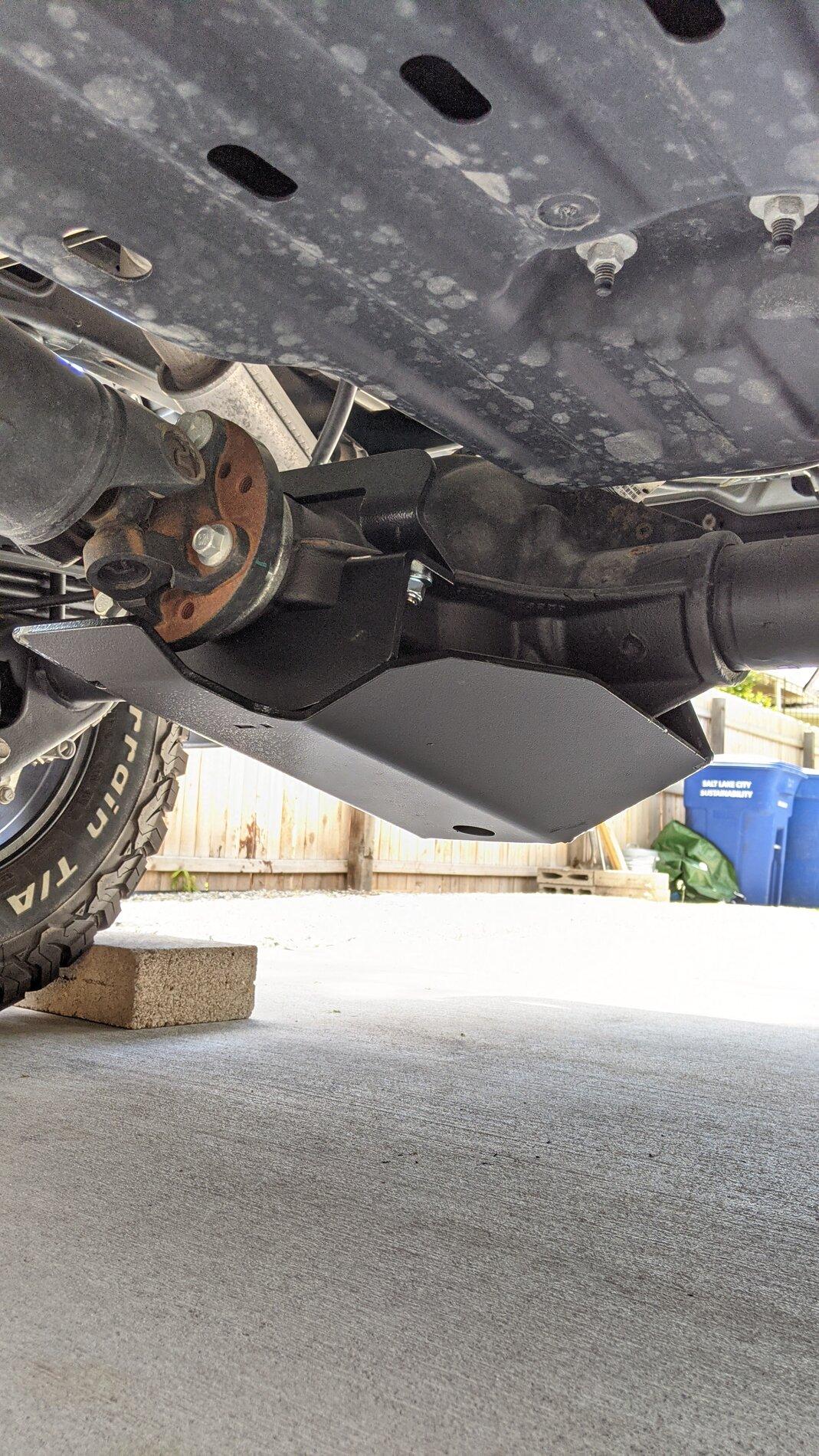

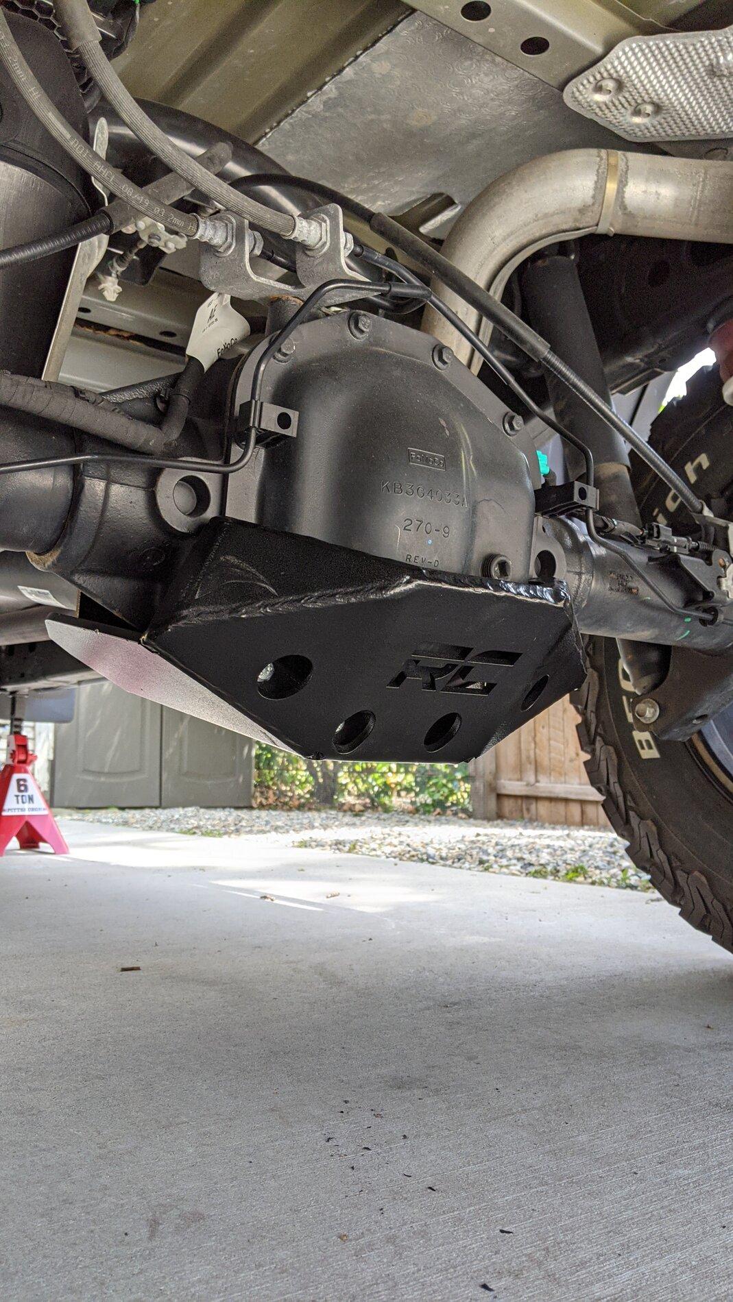

I wanted to keep my differential cover stock, but still add protection from rocks. So, took a gamble and ordered the Jeep JL (with the Dana M220 Rear Axle) diff skid.
https://www.roughcountry.com/jeep-jl-m220-diff-skid-plate-10628.html
It fits!

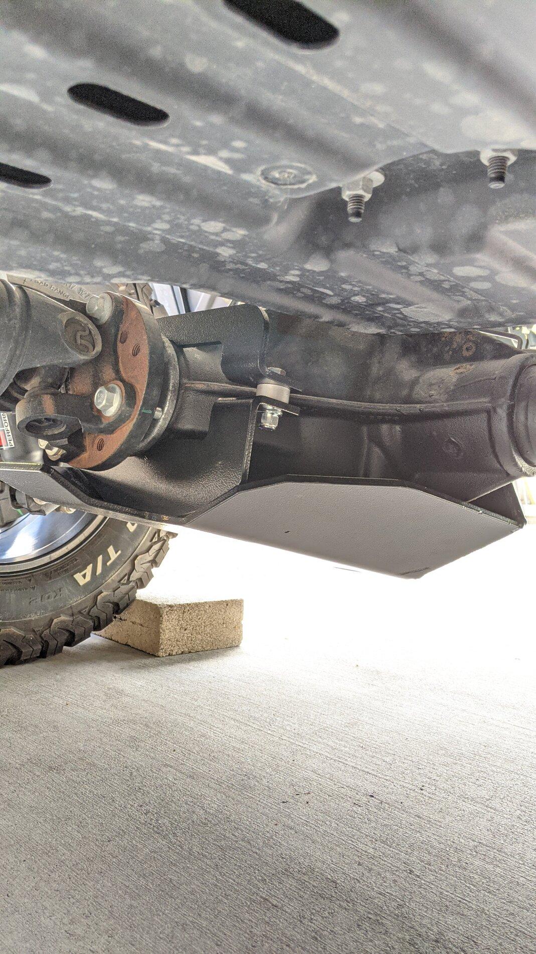

Note the front bracket is angled, this is how it was in the instructions too, but I went ahead and added a metal spacer in-between:
What size spacers did you get to fit the front bracket by the pinion ? I just bought the skid plate to add to my 2019 ranger.
