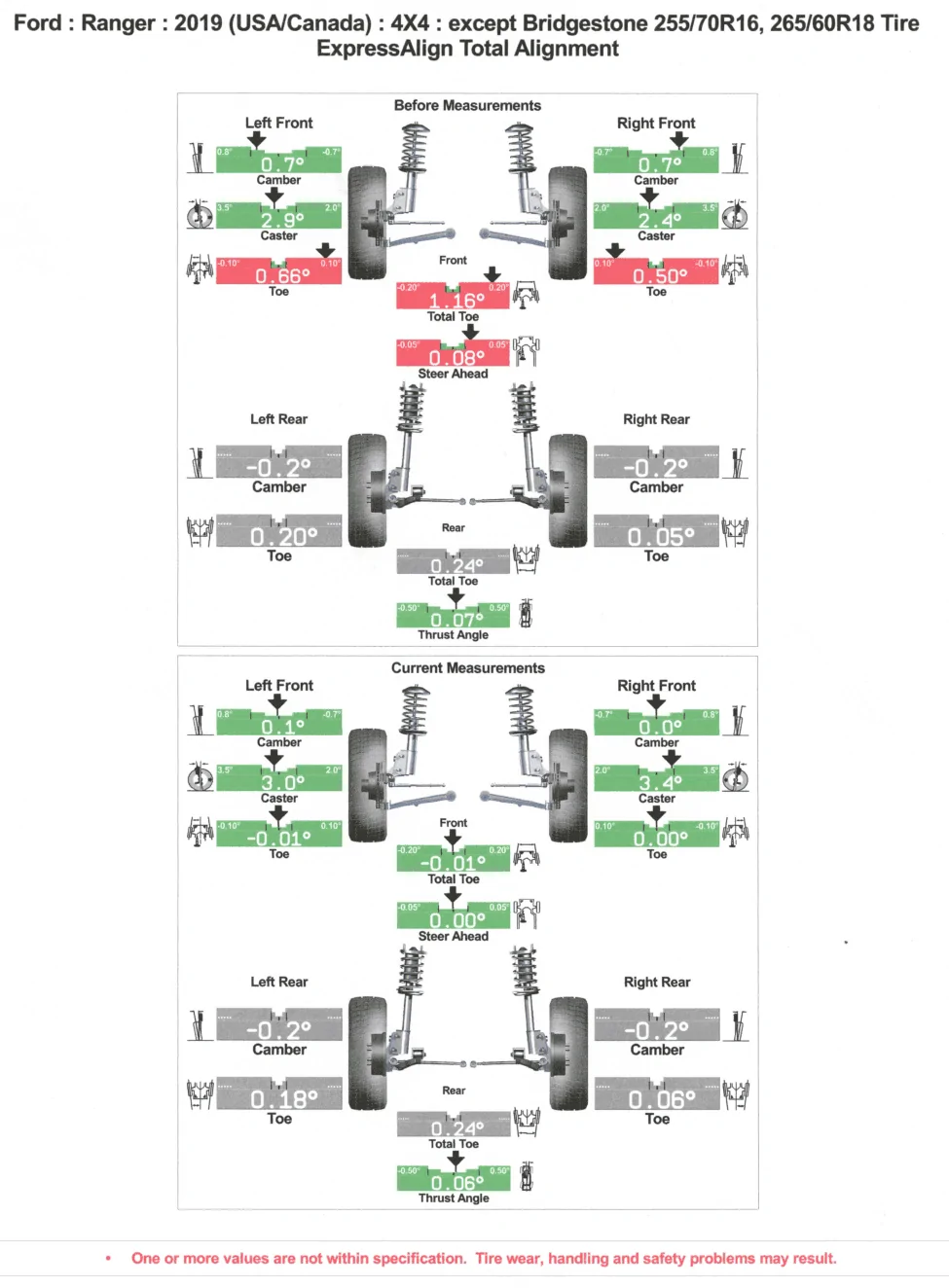

Prior to delivery, my dealer installed our FP/Fox Leveling Kit. When I asked for alignment data, they gave me this...

Hi Mtsoxfan,
The caster split might be a tad too much. If you experience any pulling to one side or the other, you might have caster split lowered to around 0.2° to improve.... JMO.

Generally the goal is to set it back to OEM specs on trucks. Depending on the lift height and method leveraged, OEM specs will not be achievable and they will get it as close as possible. The phrase "they will do their best" is often an honest statement.
For a 2 inch or less level, they should be able to get it close with the factory adjustment range. Sometimes they have to fudge on caster to get camber and vice versa.

The specifications are the same no matter what. With the truck being leveled itay be tough to keep it in specifications. This is due the the extra Caster angle that can't be corrected unless the rear is also lifted.

As others have said, the specs are the same and they will just get it as close as possible. They may just have to work a bit harder than they want to get it there. Depending on the lift, you may actually want a bit more caster than oem. I would find a 4x4 shop and have them do it if the local shop has these sort of questions. It may be more, but it is worth it
