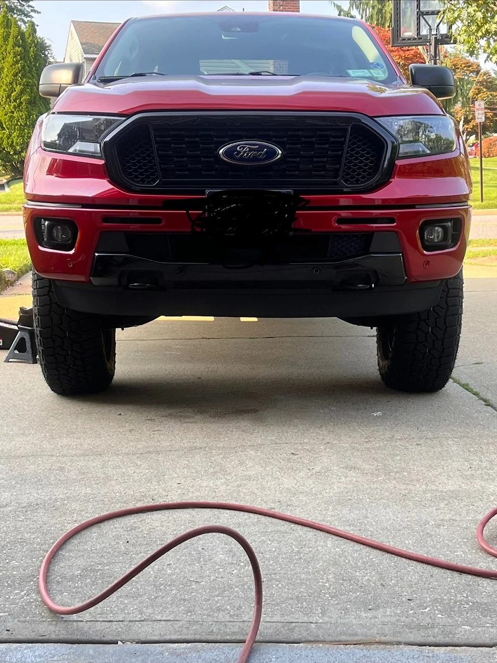

Good evening everyone I just did a 2 1/2” lift and put new tires on the ranger due to premature wear. had them do an alignment and to me it does look like it is sitting right in the front. My old tires whore out prematurely on the outside on all 4 tiers. The question is do you think they did the alignment correctly or even at all. Here is a picture

From that angle, looks like too much camber, which would lead to wear on the outside as stated.
Who did the alignment, and did you get a print out of before and after?

no printout

Under-inflated tires is also a common cause of excessive wear the outsides, especially if you’ve also been out of alignment.
This
Kinda looks a little bowlegged
If it was just done, may need some time to settle?

Update
Went back to the original place that did the wheel alignment and they said they only can do the alignment to the vehicles specifications.
went to another shop and they did the wheel alignment for me and used rough country’s specifications and everything seems to be fine

With a 2 1/2 lift I the front I don’t think you can get the camber back to 0* where it needs to be.Did you get a print out?

No printout but he got it as close as he can
