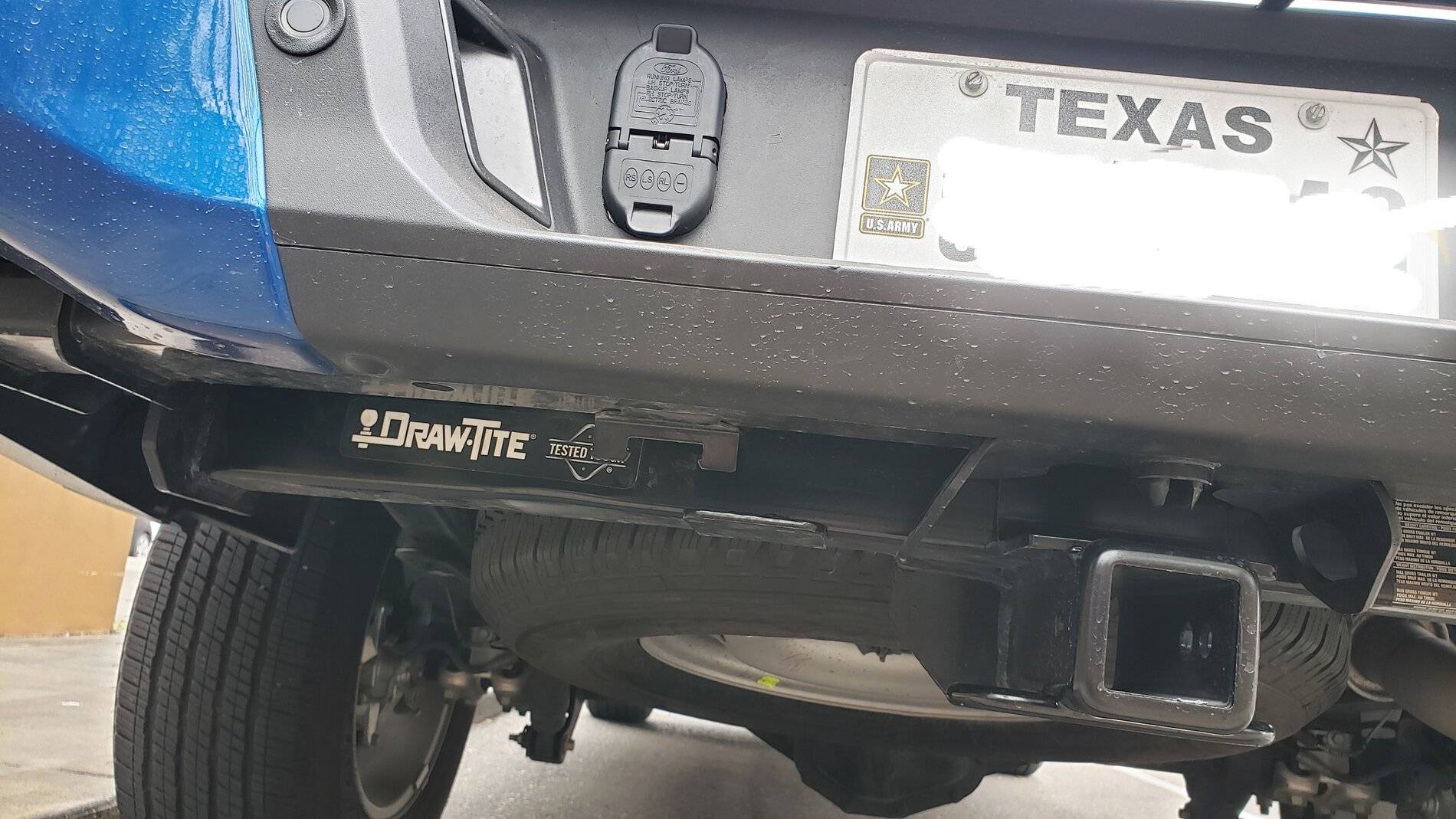

I take possession of a 2021 tremor ranger on monday but need to install a hitch.
Am partial to the draw-tite model.
Since the truck has no tow package it has the hooks in the rear.
I sent an email to draw-tite but no reply.
Has anyone on this forum installed an aftermarket hitch on a 2021?
Put a Draw-Tite on my 2020. It fits just fine (including around the stock spare) and as a bonus it doesn't stick out past the bumper.

Draw tight. 7500lb tow rating and factory wiring and plug installed. 120$ for hitch, 30$ for plug, and Ford points for factory wiring. Works awesome lots of room for spare? Took 15 minutes to install, snap on 3' ratchet with a cheater bar and red loctite. 15 minutes to get supplies ready and put away. And a jack.

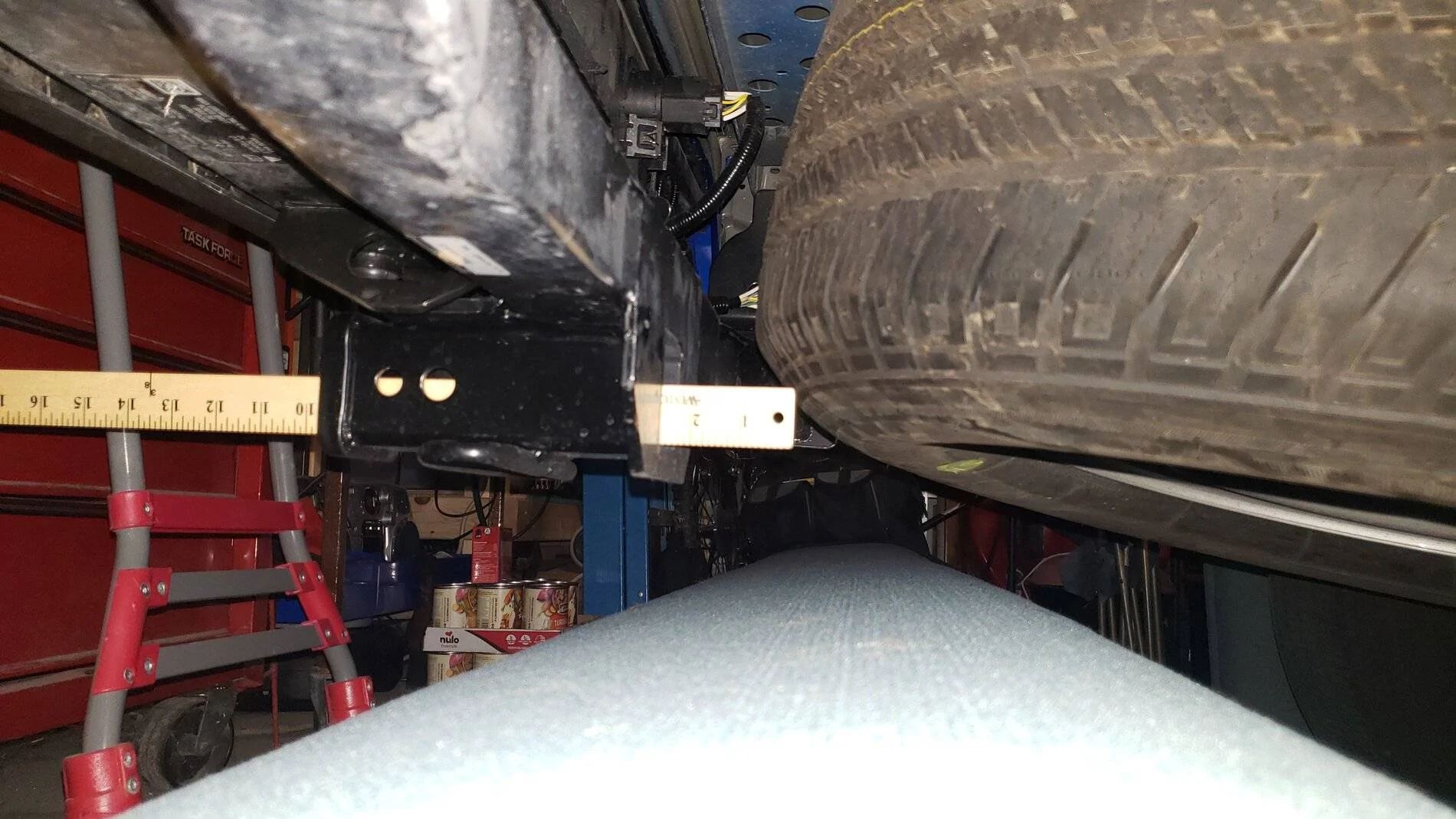

A picture is worth a thousand words.
That pic with the ruler should be on ever site selling that hitch.?
