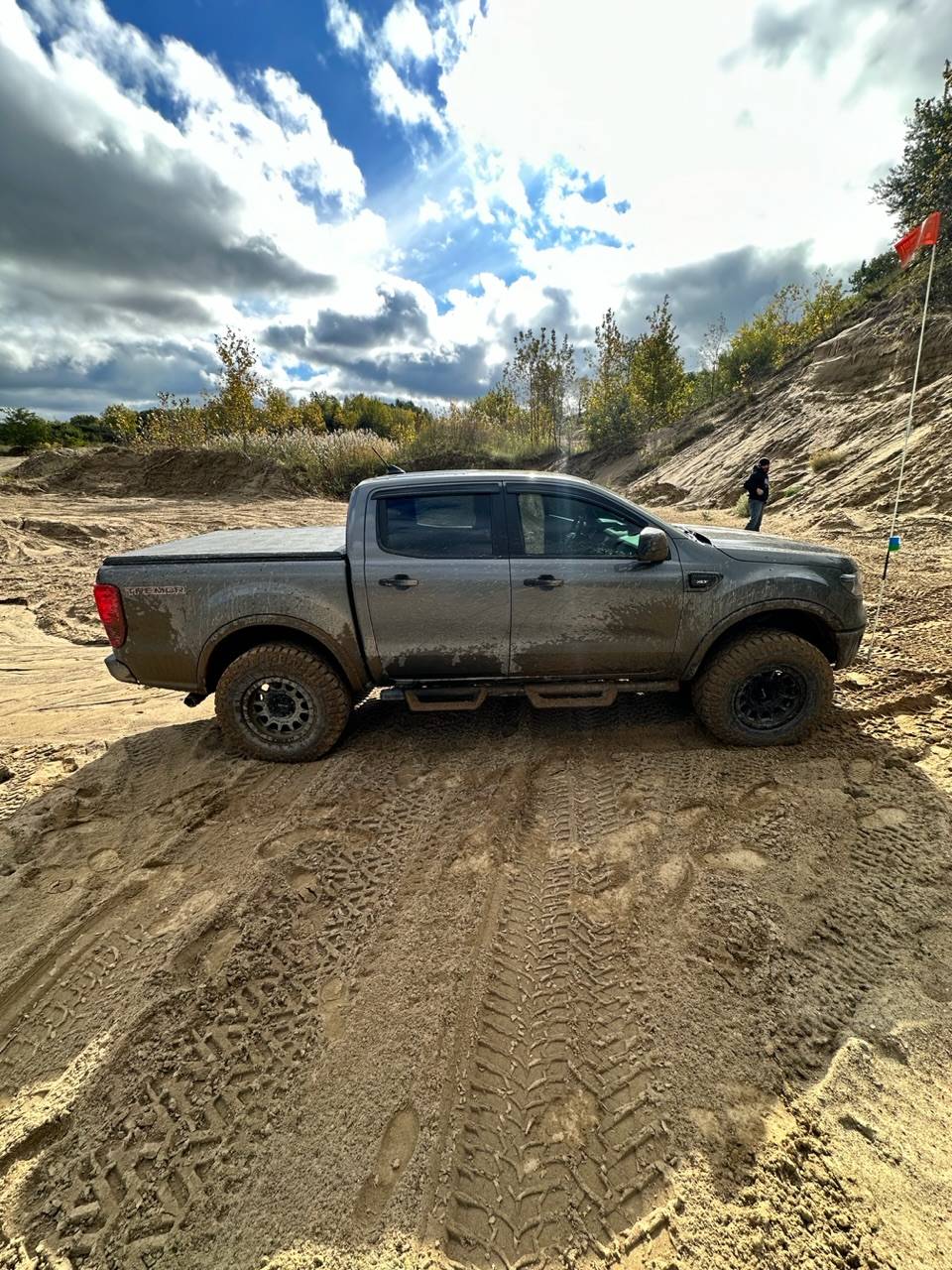

295/70/17. 0 offset. No rubbing with crashbars removed and plastic block behind wheel liner removed (during off-roading as well)

Thank you! No level on yours?

I have the adjustable fox/eibach replacements on the front from ford performance but they’re not adjusted up more then .5” from stock currently. I wouldn’t question the stock tire size on a 0 offset. 295/70/17 is quite a bit larger
