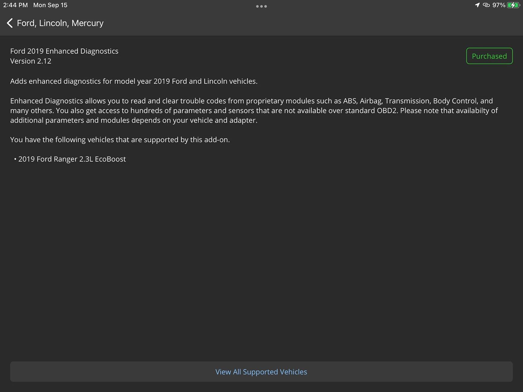

It's a 2019 Ranger 2.3 pid module...
I believe that's basically the same as what I have, just for your 2019 where I have a 2020.

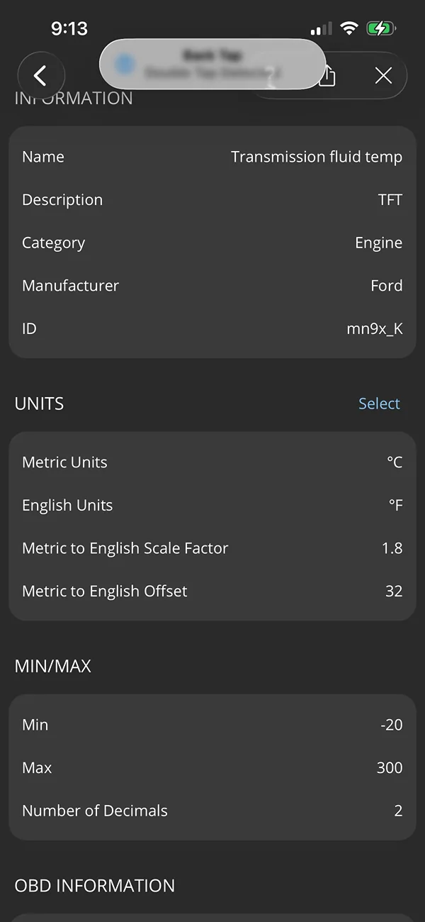

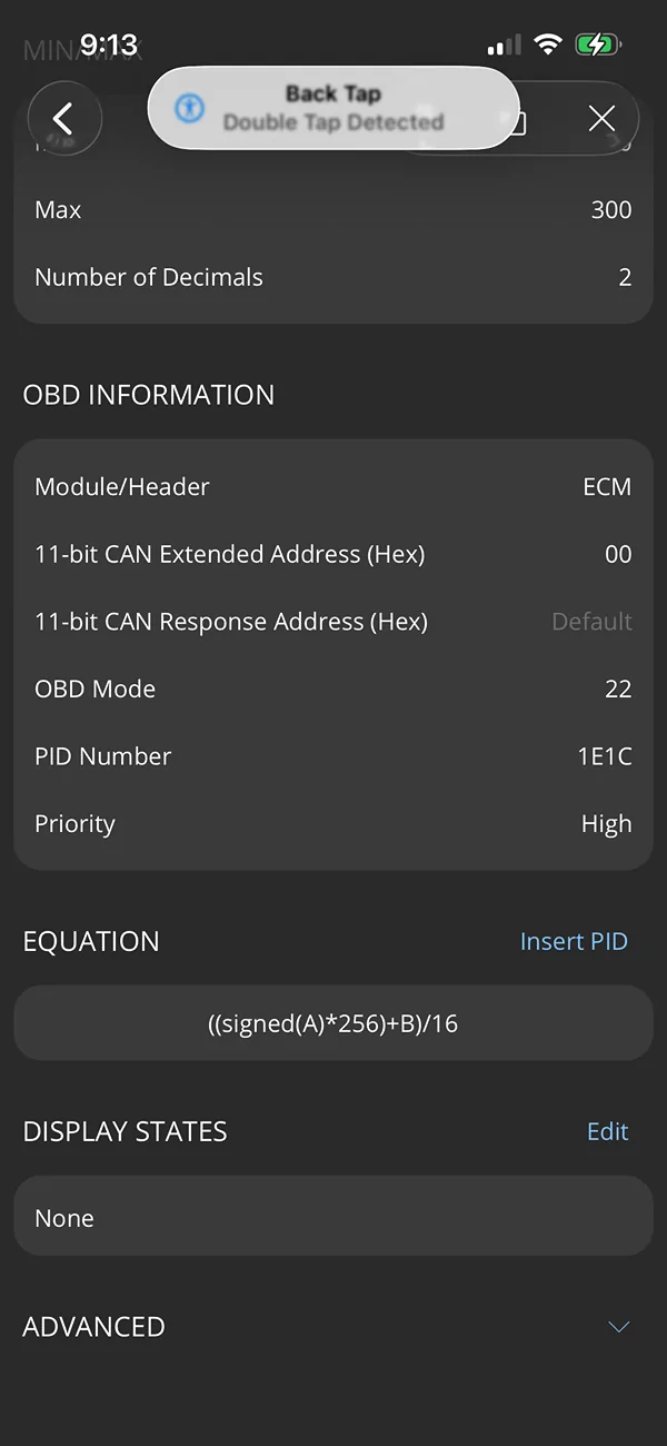

So I wanted to be able to monitor transmission temps on my Sync3 screen via CarPlay. I already had the OBD Link MX+ adapter that I had been using with my Android tablet and Torque Pro. I purchased the OBD Fusion app for my iPhone and also the 2022 Ford enhanced diagnostics. But there was no pre loaded PID for the transmission temperature. Had to build the PID through the user defined process. Searched high and low here and the web for someone who had already went that route on a 2022 to no avail.Found a PID that was used on a 2019 and loaded that. It gave me data but it was incorrect. Example: screen displayed temp as 286.02F when it was actually 141.12F ( verified by my Torque Pro app). Here’s what was weird, 141.12 C converts to 286.02F so the equation was doing something wrong. I contacted OBD Fusion and they confirmed the equation problem but didn’t suggest how to fix it. So I went back to the web and looked at all kinds of PIDs for any Fords and looked at how their equations were built. After trial and error I finally found the right equation. So here’s some screenshots of how my PID is built. I saw on here a few others with 2021-2023’s had the same issues so sharing this to save someone the headache of trying to figure it out.

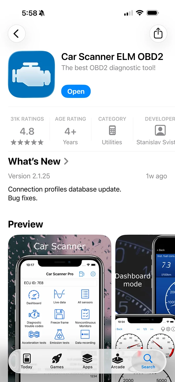

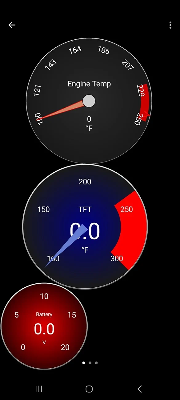

For trans temp and battery info I use Car Scanner ELM OBD2 App. Works fine with Sync3
