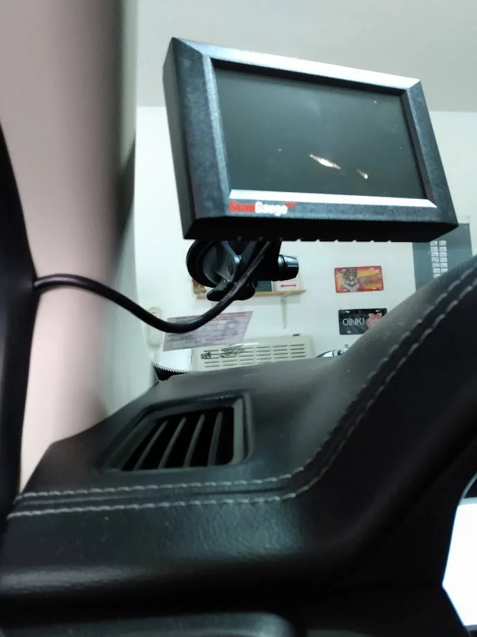

How did you mount the Scan Gauge lll?
6,042
30,175
Used the windshield mount that comes with it. Ran cable to and down weather stripping, bundled extra cable under dash next to port.
