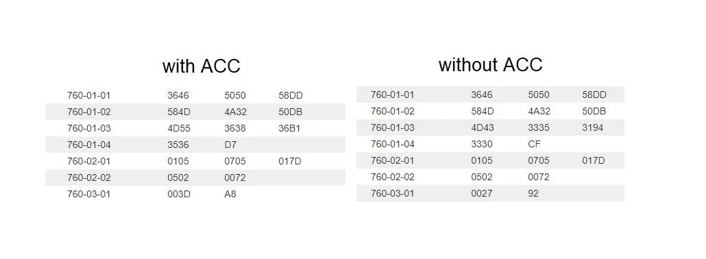

I stand corrected. Yes 760 module is different between models.
This is what I believe.... please compare to yours:
760-01-01 > 760-01-04 contain the VIN number
760-02-01 x5xx xxxx (5 is FX4 package, 1 is without)
760-02-02 x5xx xxxx (5 is SuperCrew, 4 is SuperCab)
760-02-02 xxx3 xxxx (3 is FX4 package, 2 is without)
760-03-01 xxx7 < I believe this is the Trail Control Even is with, Odd is without

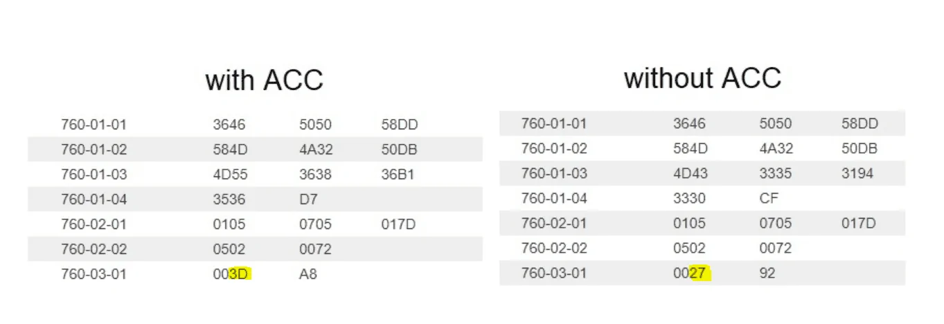

The only difference I found is:
760-03-01 -> xx3D with ACC
760-03-01 -> xx27 without ACC

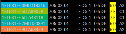

Another change that I found in IPMA that is responsible for ACC is
706-01-01 -> xxxx 9xxx xxxx
I'm still unsure about ABS but the change should be only in one place.

YES! Confirmed by my data:
VINYearSuperCabXLTLariatFX4NavADDTMTC
1FTER1FH0MLD183162021xx
1FTER1FH5LLA890782020xxxx
1FTER1FH6LLA481182020xxxxxxx
1FTER1FH7MLD508912021xx
1FTER1FH9LLA689592020xxx
Also
No other differences in module IPMA 706

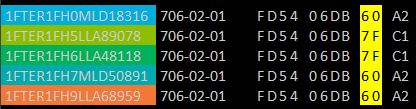

I have concluded that these settings are responsible for ACC. Could you compare this to your finding? Could anyone also approve this and does anyone know anything about ABS?
IPC:
Enable Menu ACC 720-01-01 > xFxx xxxx xxxx
FCW ( Forward Collision Warning ) 720-01-02 > xxxx 9xxx
SCCM:
Steering Controls ACC 724-03-01 > xxx4 xxxx xxxx
BCM:
Enable ACC 726-13-01 > xxxC xxxx xxxx
IPMA: (Not sure)
706-01-01 > xxxx 9xxx AAxx
Gap Setting 706-02-01 > xxxx xxxx 7Fxx
ABS: Most likely 760-03-01? > ???? ??

GOOD STUFF!
Confirming based on my data:
IPC:
SCCM:
This one isn't matching. On a F-150 the x2xx xxxx xx is correct but this doesn't match my VIN's that should have the 2nd and 3rd vin with the ACC option.
BCM:
IPMA: (Not sure)
I show nothing in the 760 ABS module that correlates to ACC
