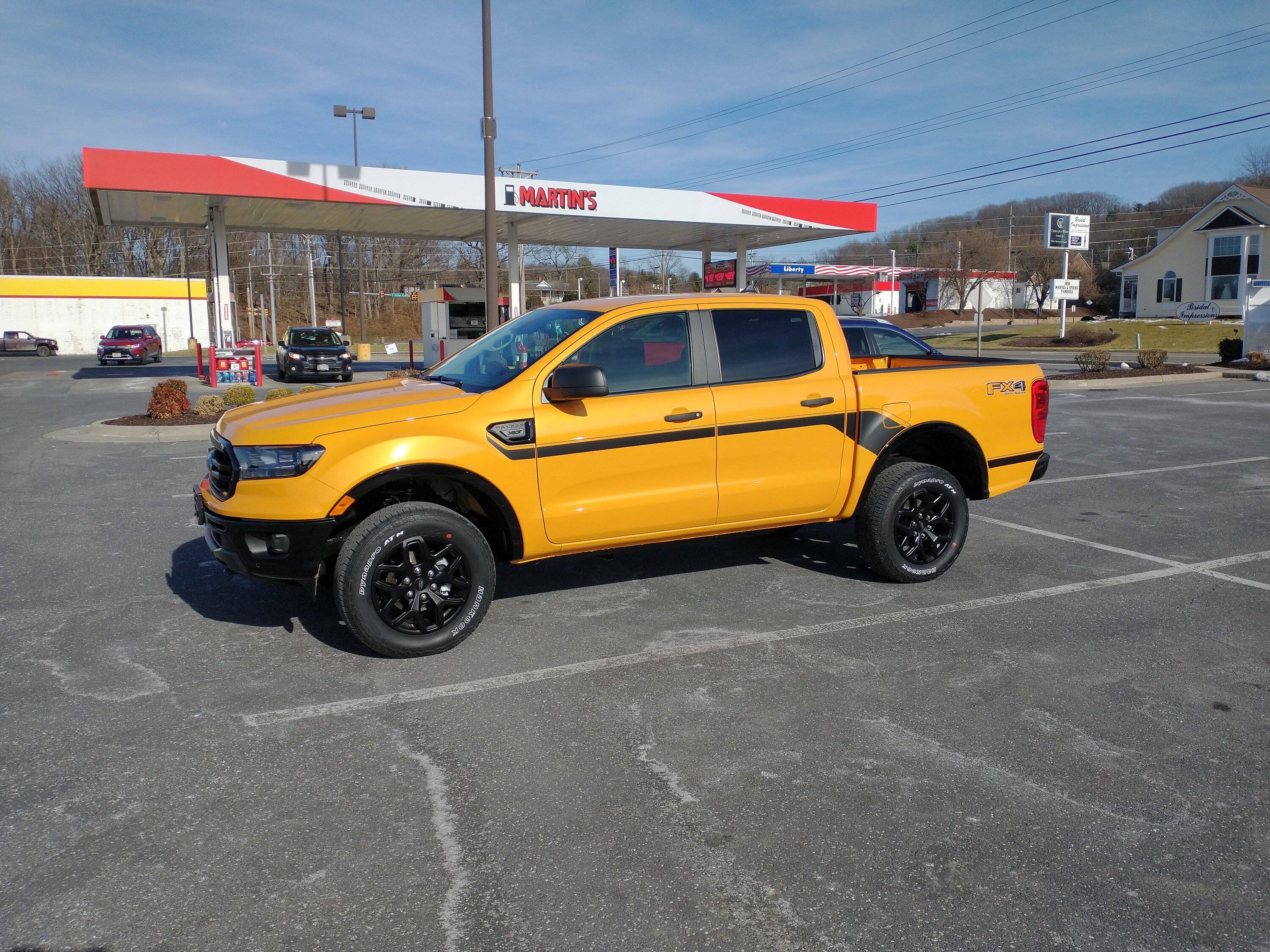

Fantastic highway trip mileage! I just did a trip to CT From VA, a total of 530 miles. I fueled up in Southbury CT, and drove to Winchester VA to fuel up before the last leg of my trip, I had 1/4 tank of fuel left. My truck took 15 gallons of gas, I had travelled 417 miles on that fuel. Checking the math on my phone revealed I had average 27.8 mpg on my return trip. AMAZING!
My truck is a 2022 XLT, FX4 with the 18" Hankook all terrain tires. I just hit 4000 miles on the odometer. Typically my dash mpg calculator indicated from 25 to 30 mpg depending on the grade of the road, I kept my speed on cruise control around 72 mph the entire trip, AC on. Each fuel stop I reset trip odometer and avg fuel reading. My tires are inflated 32 psi front, 34 psi rear.
My fuel, Shell 87 octane.
I'm convinced the Cyber Orange paint is key, lol
