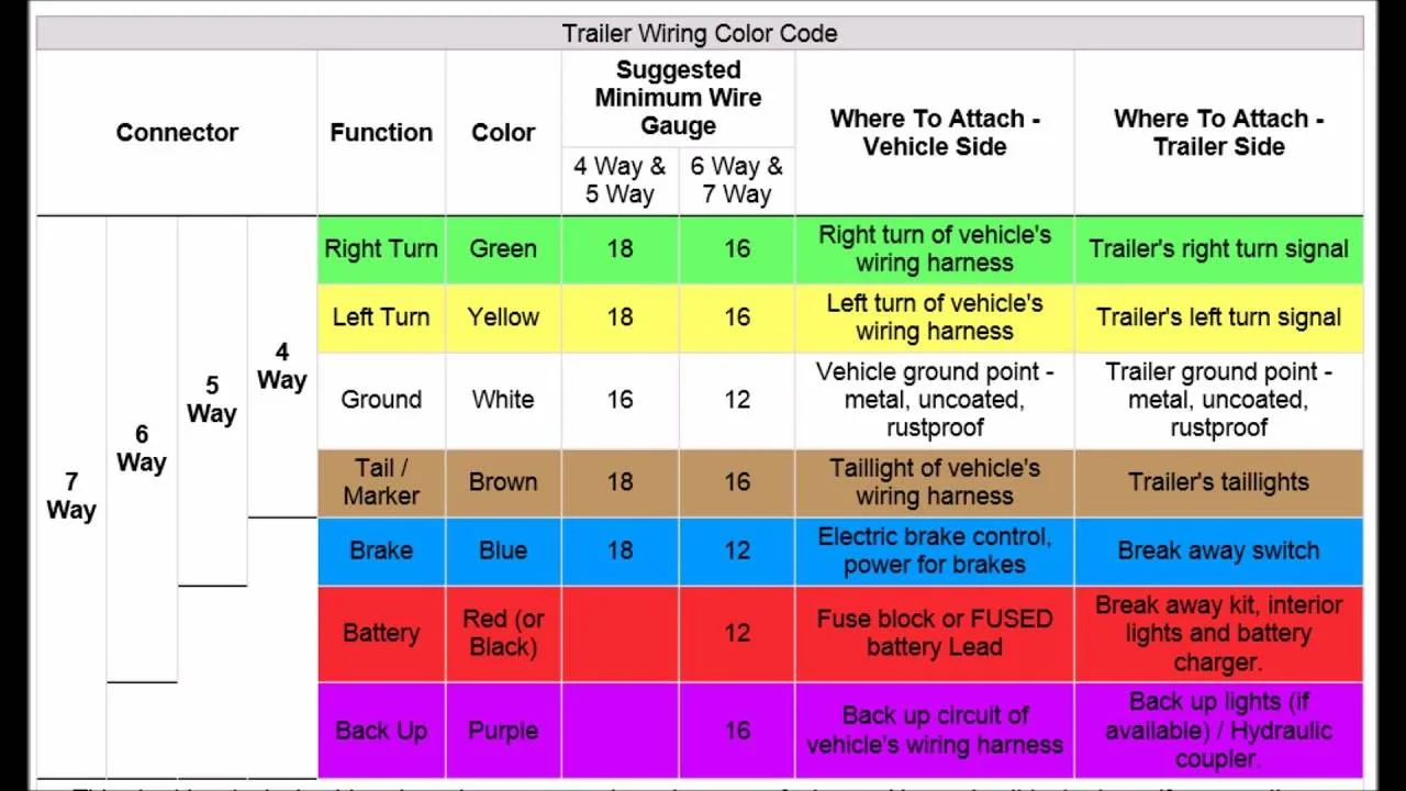

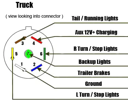

I should be already to go. (Unless the factory screwed up, which I doubt) YOu can use a tester to make sure though.

yes, the 4-pin comes standard, whether or not you have the towing package. If you want a 7-pin, you'll have to add it (it it isn't already there).

BRAKE LIGHTS and the actual TRAILER BRAKES output are different things. The 7 pin ADDS the trailer brake output. The 4 pin DOES NOT control trailer brakes.
