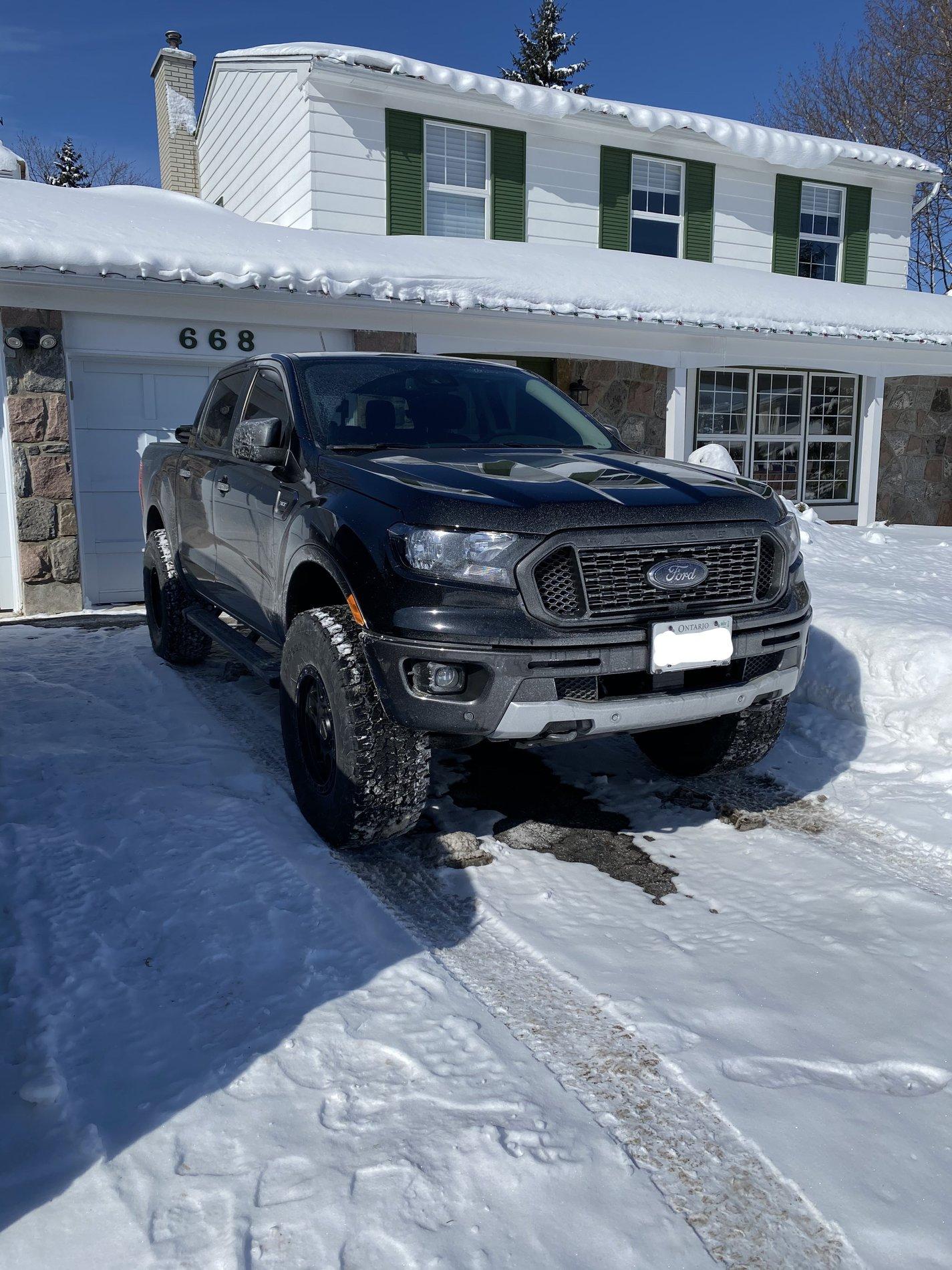

Hi all,
Just curious. With the right amount of trimming, would it be possible to fit 35x12.50x15s on a 3" suspension lifted Ranger without swapping the front bumper? I've seen 33s and 34s fit but I would prefer to go with a 35 for appearance and off-roading.

I did level lift ,new UCAs and a redesigned crash bar and I am safely running 285 70 17 tires that are 32.7 "tall. I know it's not the 35s you listed, just for a comparison.

I was able to fit General grabber X3 315 70 17 on my 2019 ford ranger. Using spc adjustable upper arms that i adjusted to configuration E to clear rubbing issue (move tire forward) shocks are stock ... I just put a 3 inch label lift from fordrangerlifts.com.

Just a quick update - with the ford performance tune also installed around same time as 35s, getting 16-16.5 mpg thus far, mostly city driving...pretty happy with that. Then again, I have been perhaps a bit more conservative than usual driving lol. But thus far, not too shabby.

How's the ford performance tune with 35's? Peppy?

Admittedly don't have frame of reference for tune with smaller tires, but objectively still feels heavy from a start but picks up nicely between 20-40. Mainly got tune to fix tire size/odometer and any performance gain was gonna be gravy lol.
