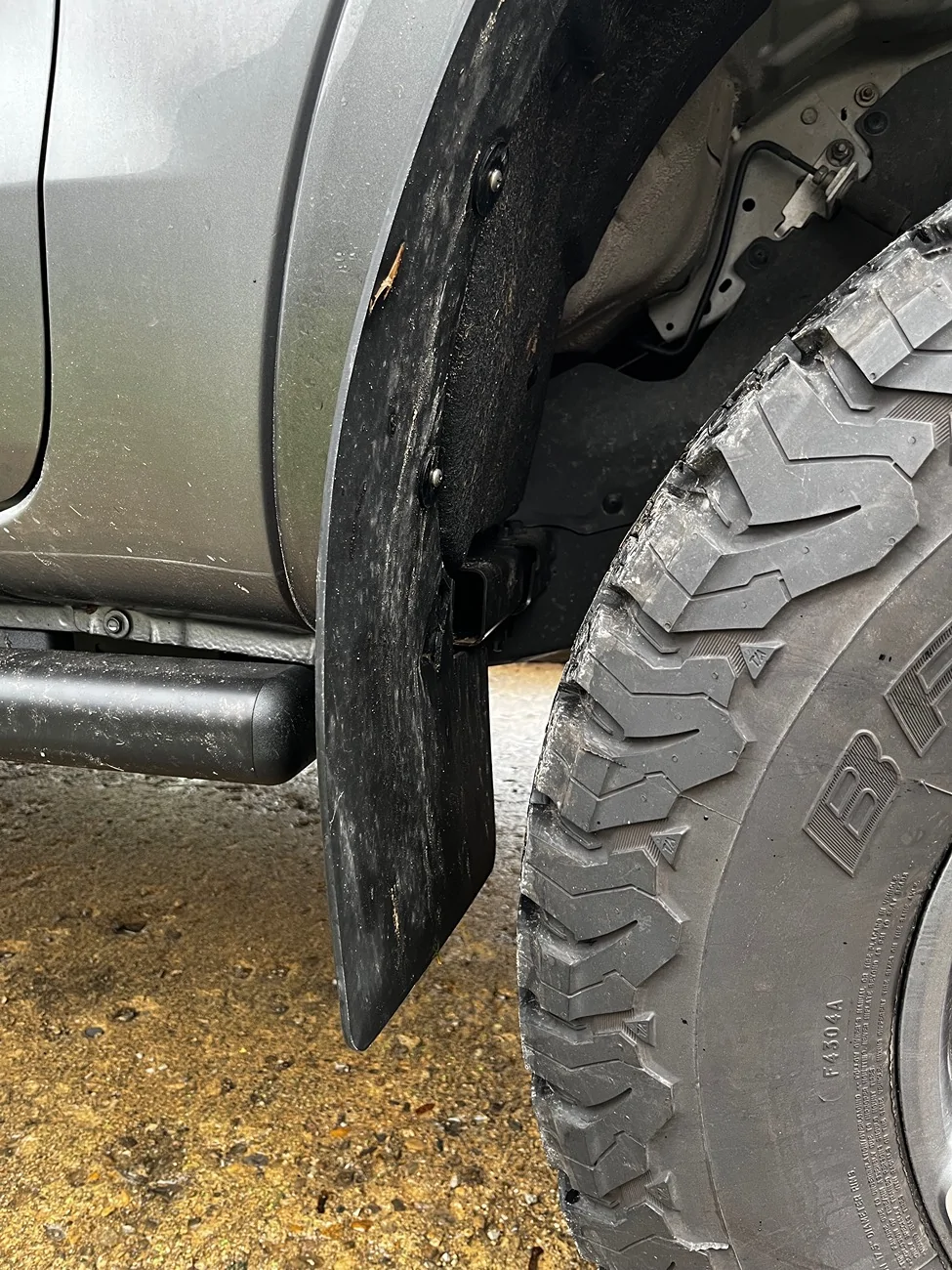

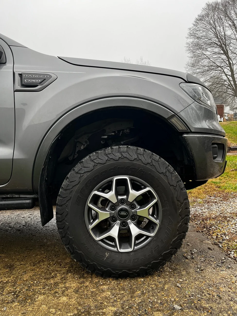

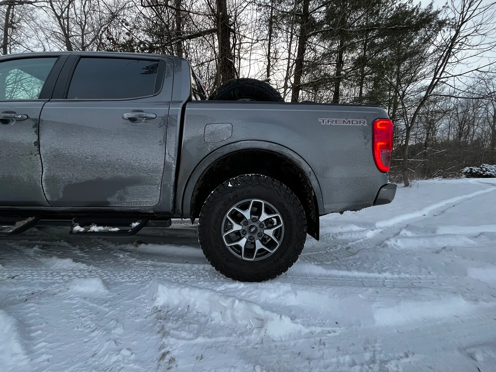

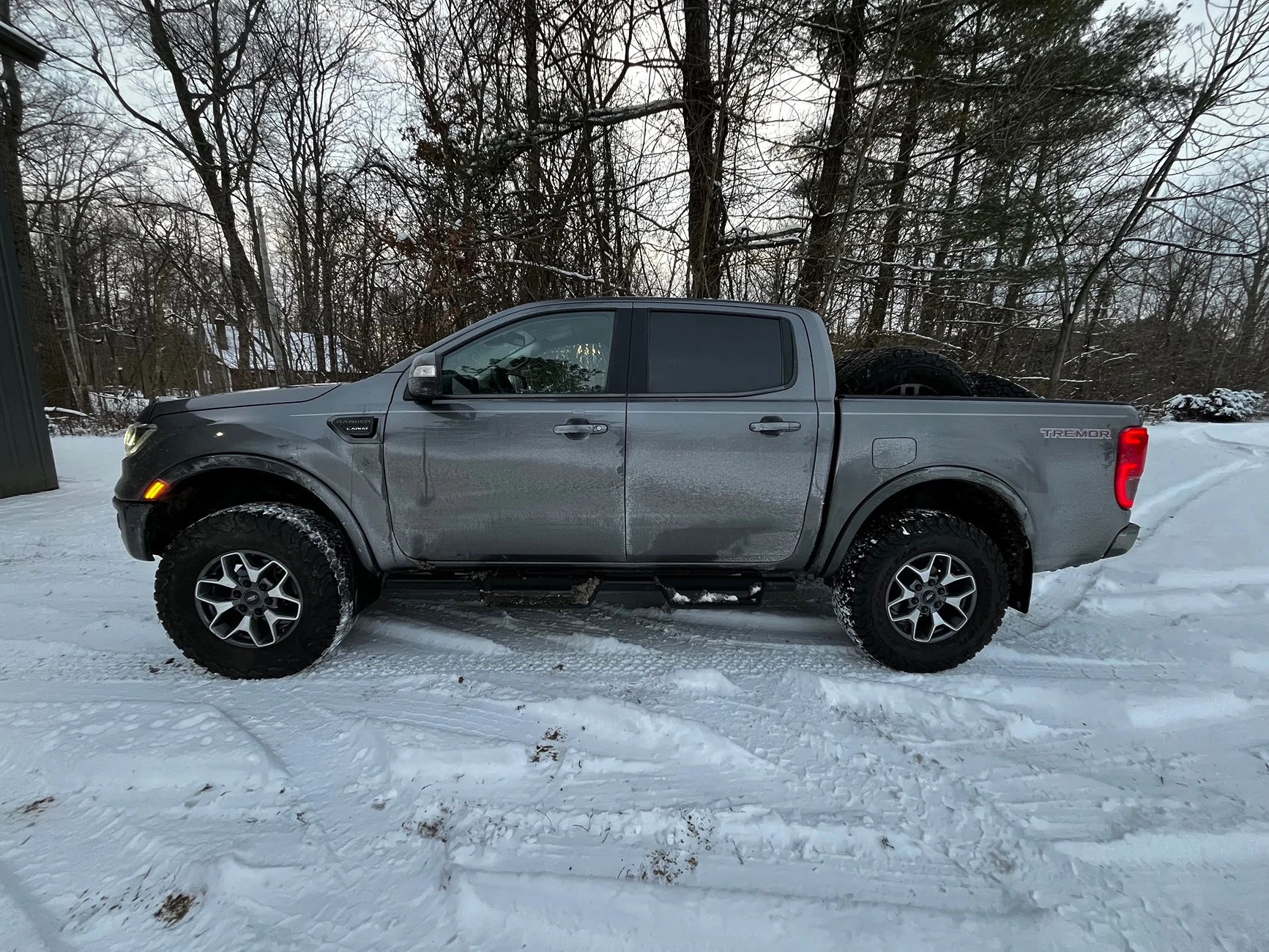

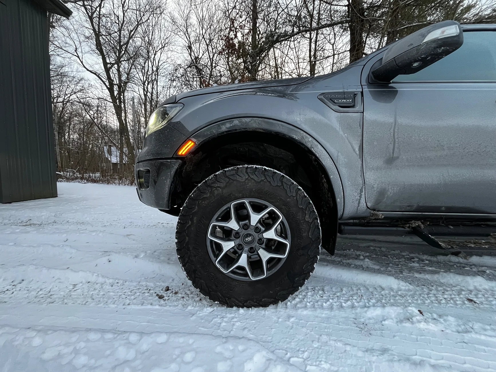

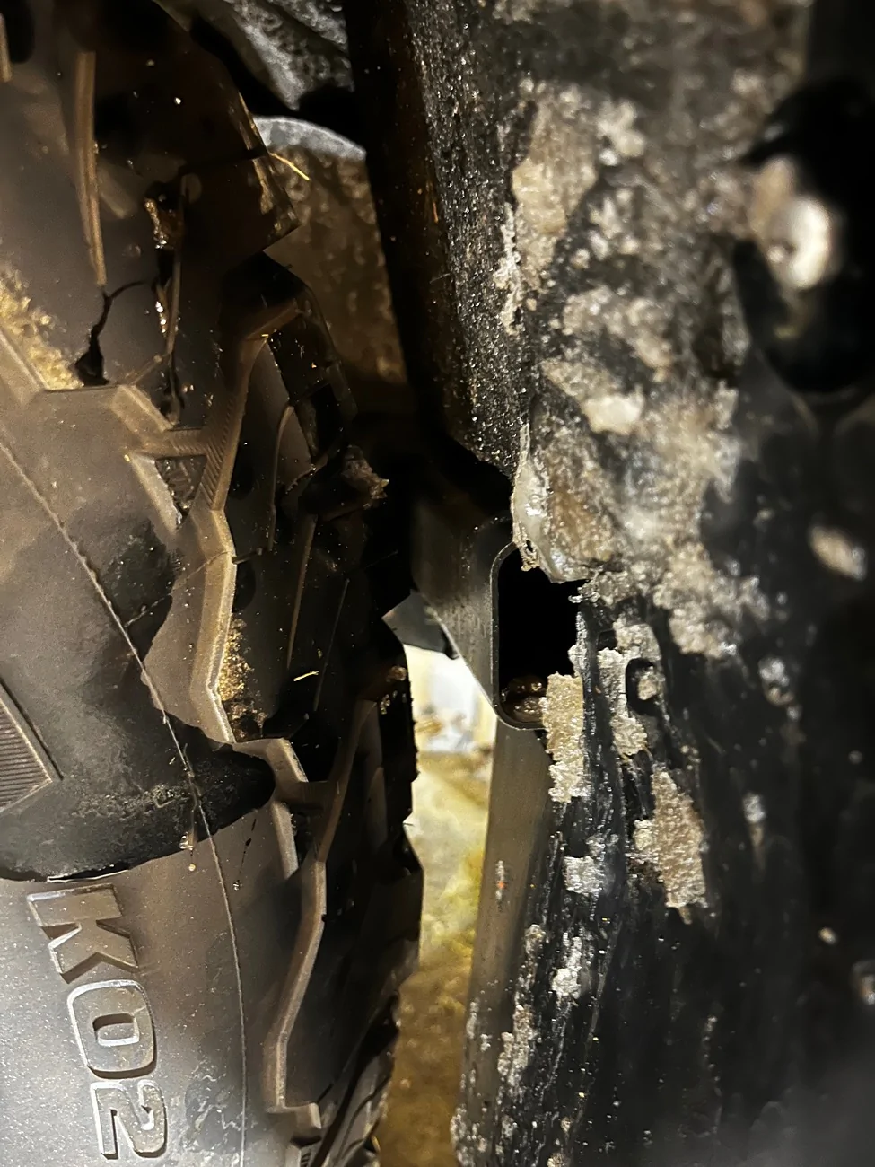

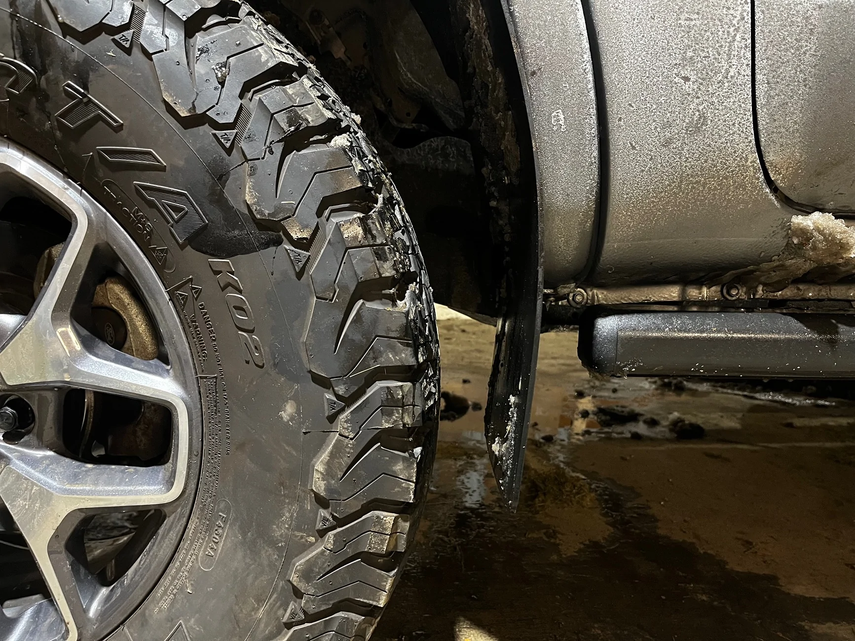

Well to add to the thread, I picked up a set of Bronco badlands wheels with 285/70r17 KO2 tires. To my surprise, it fit my setup without any removal to the crash bars?
Tremor model with 2” lift. 1” wheel spacers with factory 55mm offset bronco wheels.

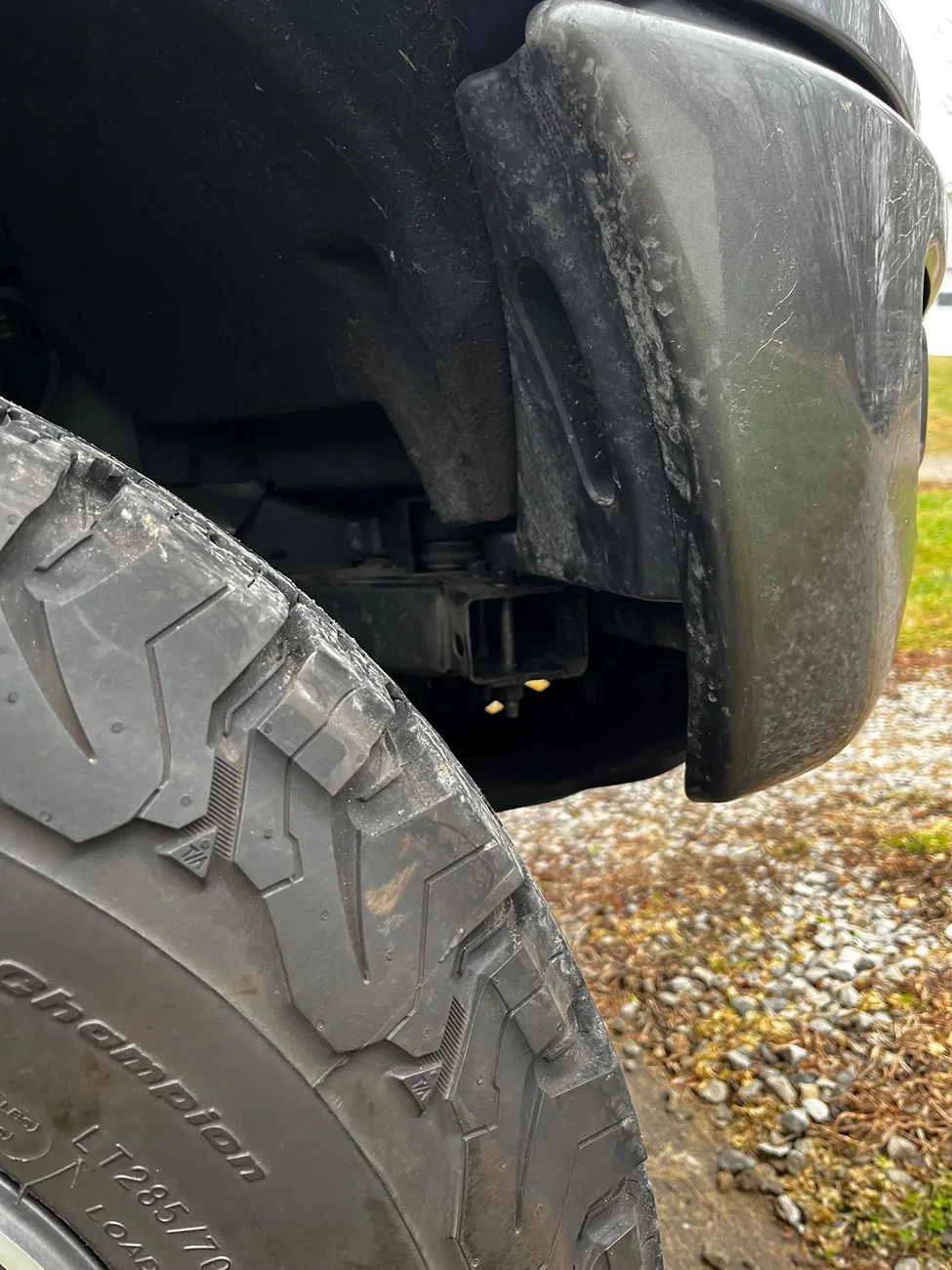

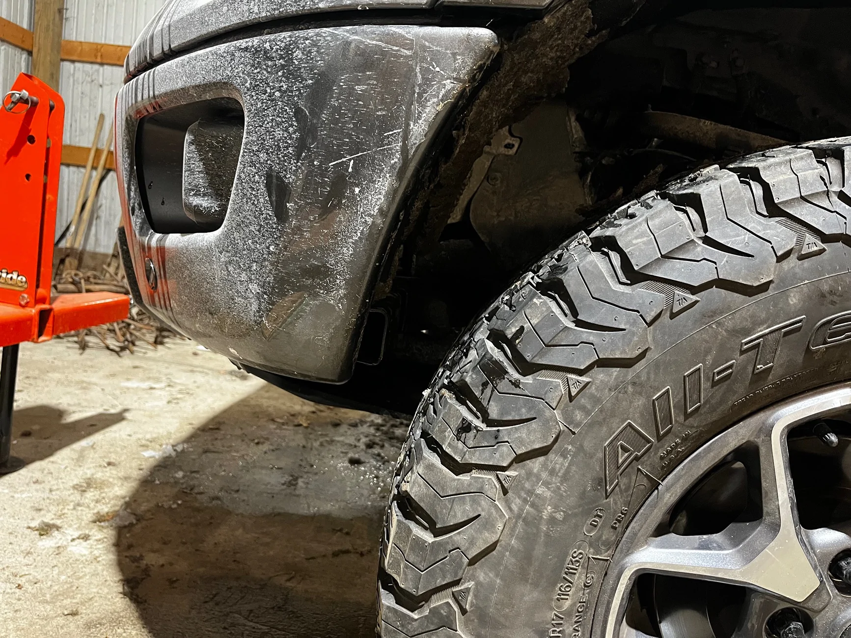

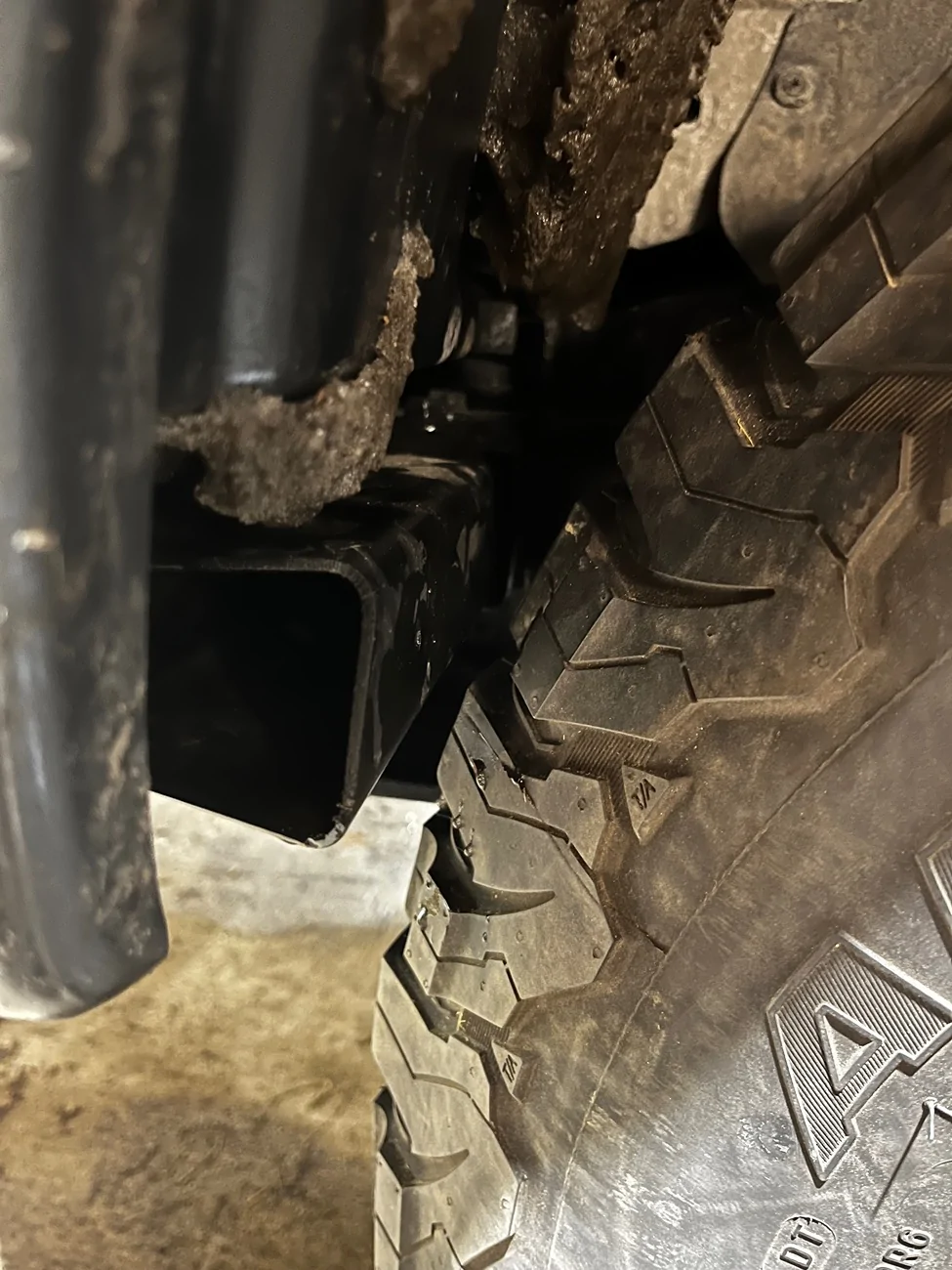

Well, I ended up with a slight rub on an incline in reverse. So I cut out the front crash bars to see if that fixes it! Wasnt hard to do, just tricky to not hit anything else on accident with the angle grinder. Man I miss my dads old pneumatic cutoff wheel. That thing could fit in the smallest spaces.

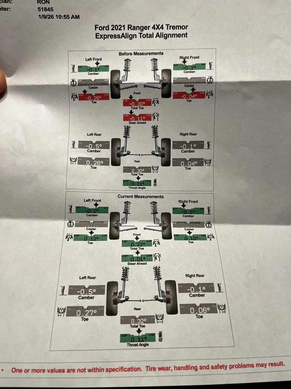

Got an alignment on the truck to make sure the tires age well. How does everyone feel about the toe being so high?
