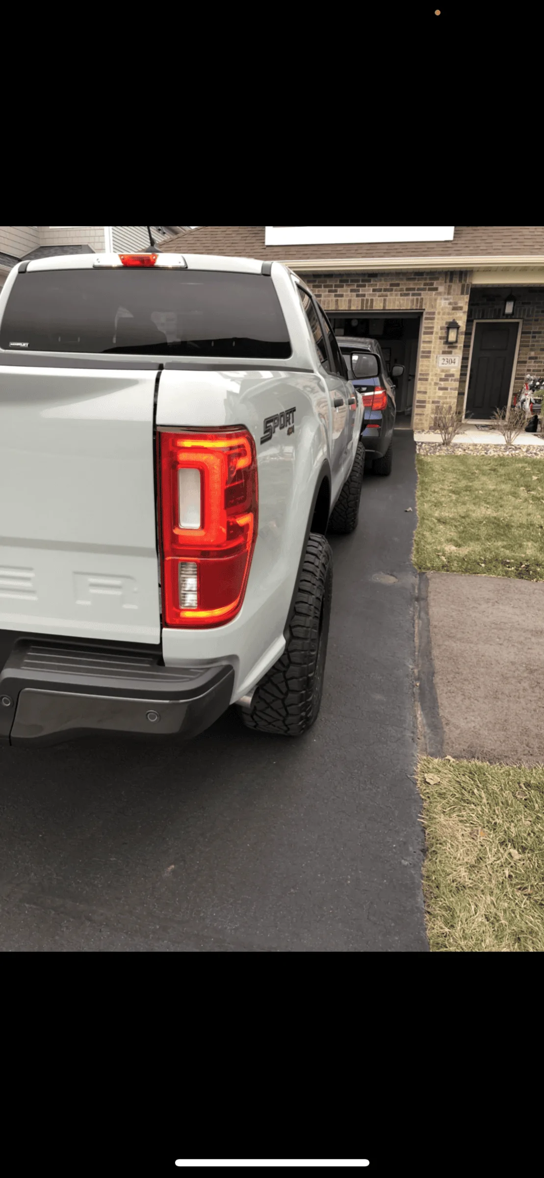

Hey guys, not really the one to post but I did a lot of reading on these forums when deciding which tire/wheel setup to go with so here’s mine.
Readylift SST 3” front / 1” rear lift kit
Readylift high clearance intrusion bars
Fuel covert 17x8.5 +12
Ridge grapplers 285/70
Let me know if you have any questions.
Love your truck on 33’s! I’m still trying to figure out exactly what I will need to do with my Tremor to get 287/70 tires on. I did do a 1” lift in front. I like the stock wheels but may need a spacer as well as replacement intrusion bars to get them to fit. Not in a hurry as I will run stock tires for a year or two.
Looks really clean - nice!
