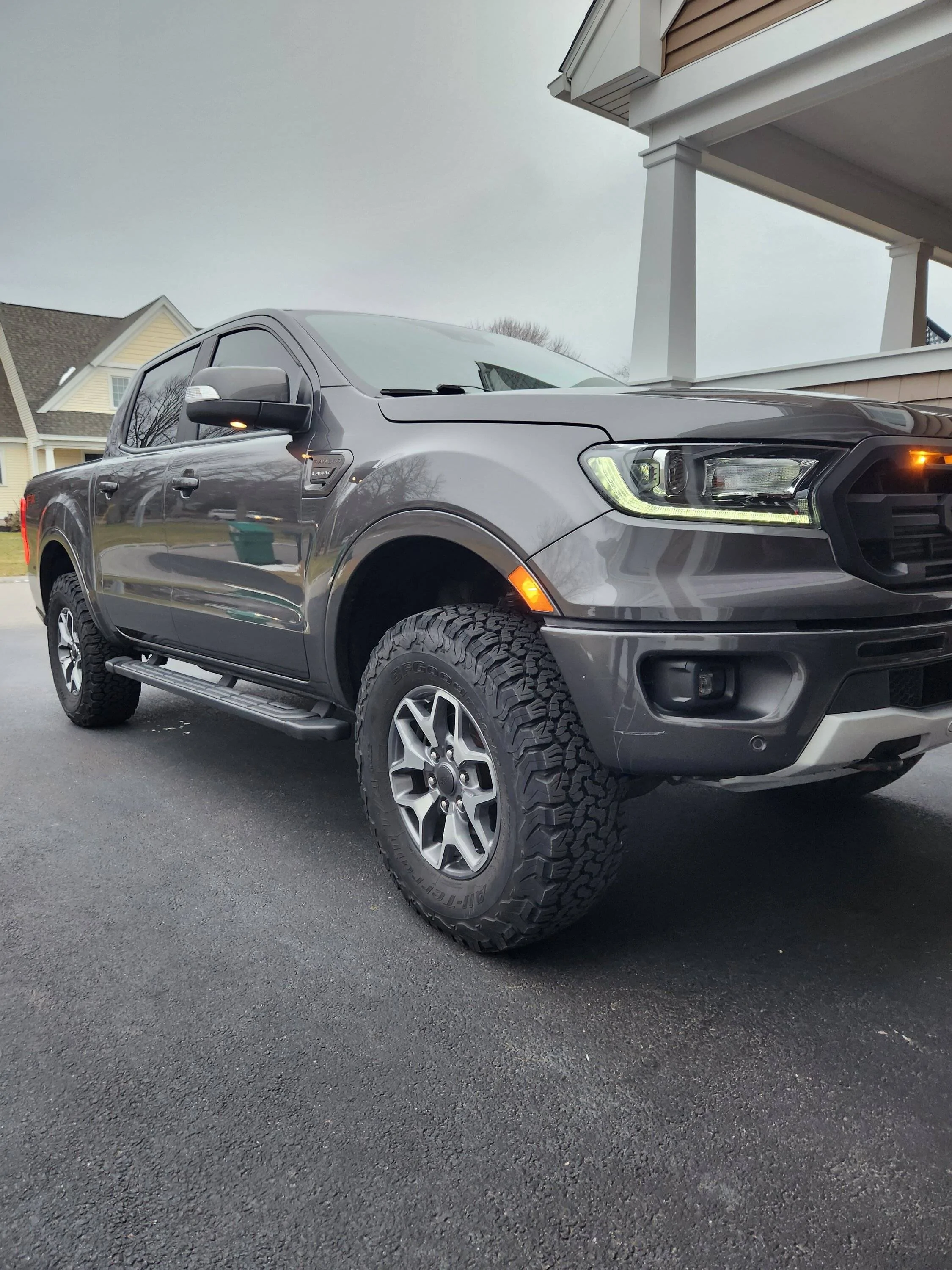

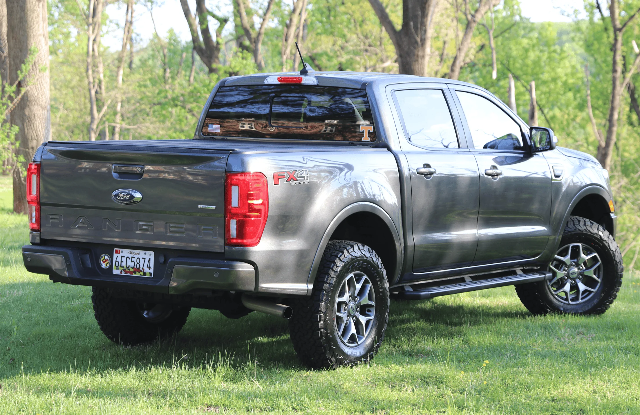

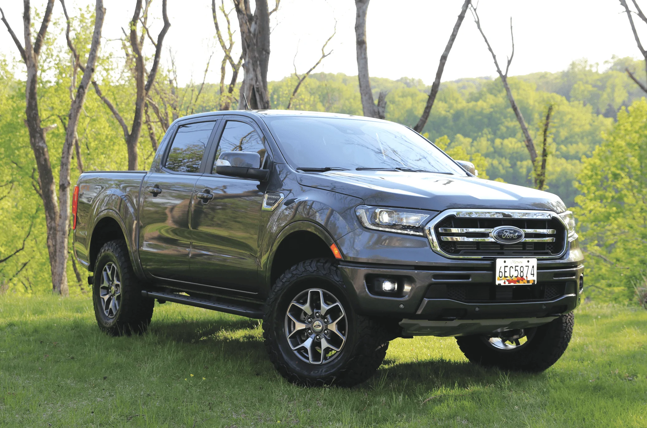

Hey everyone - first post. Finally got to work on my Magnetic 2019 Lariat CC FX4. My main reason for posting on here is that I haven't seen anyone do this yet, so I though I'd share. I purchased a set of 5 wheels and tires off a 2021 Bronco Badlands and just installed them. The tire specs are 285/70/17 and the wheel offset is +55, the same as my factory 18"s. I needed a level to clear the rubber, and I don't do enough heavy off-roading to justify buying a coil kit, so I cheaped out and went with a spacer setup. The 3" level I purchased is from fordrangerlifts.com and the quality is fantastic. The customer service is phenomenal as well; I got a response to my text in all of 200 seconds. Well worth the extra $100 over RC. I think it looks awesome and it definitely drives great. Favorite part - zero cutting or rubbing. Only removed the air dam which I probably didn't even need to do. Crash bars are here to stay.
Respond if you want any more pictures. Took some beauty shots today.

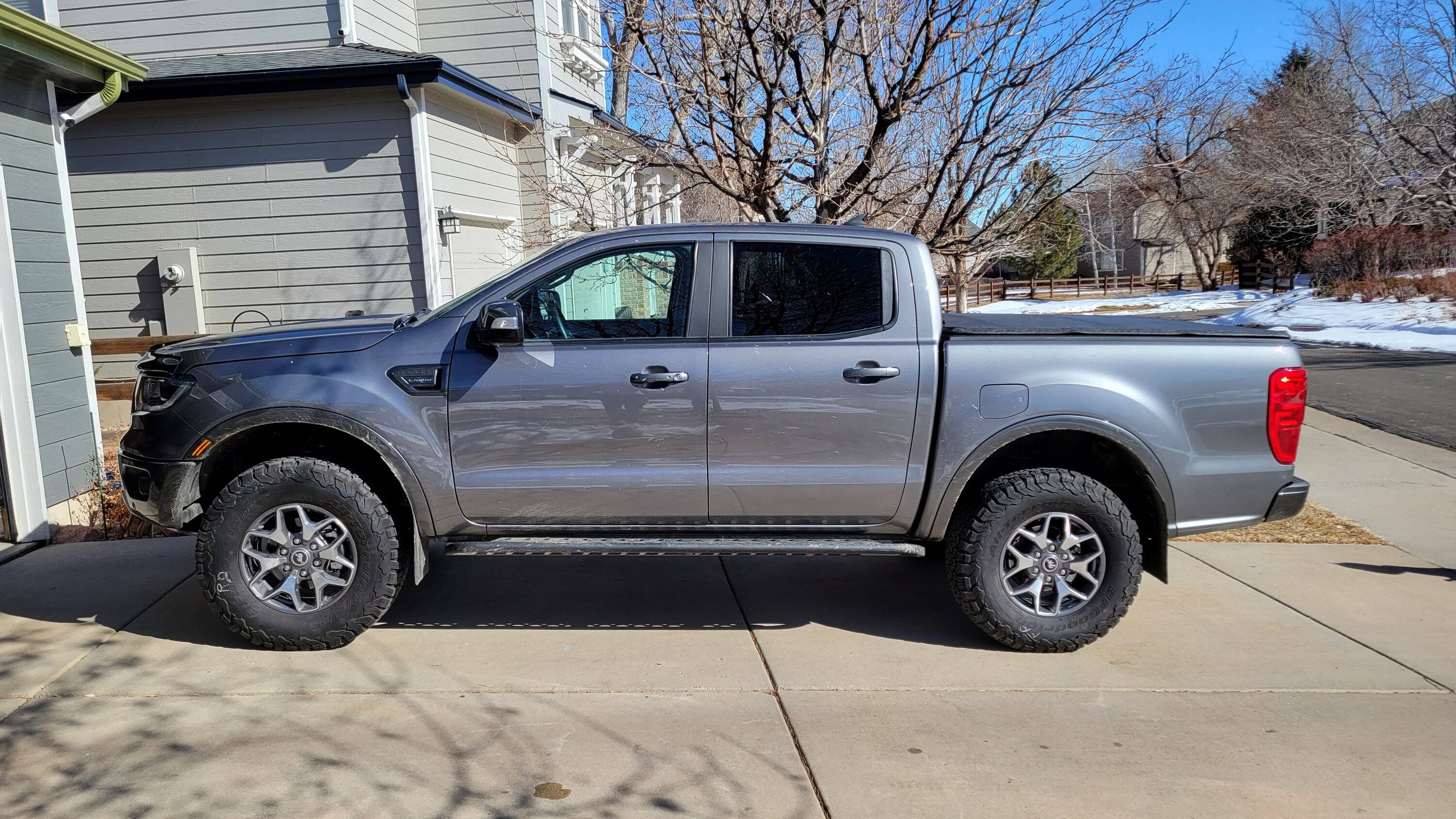

Done and done, Eibach suspension as well. Wish I went higher.

Can you get a pic of where the spindle and tire gap is? Trying to see how much room you have there.

where do you mean? Crash bars are still there, suprisingly.

looks good matches with all the oem chrome bits well

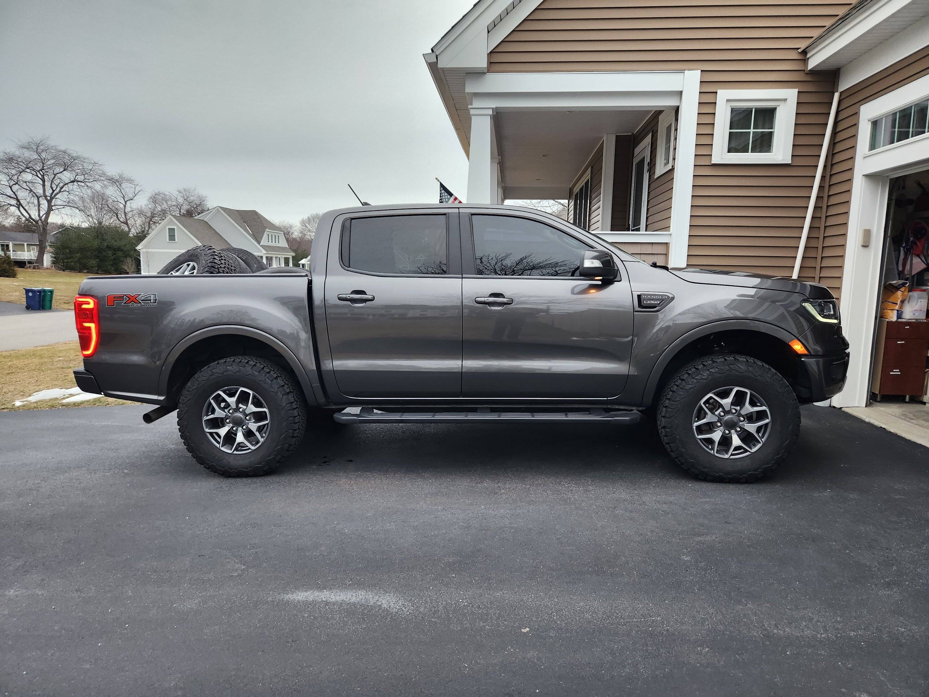

Oh yeah it's the perfect match, I did the same thing. I wound up putting eibach all around but I wish I went a little taller to make it jump out. But it's the perfect combo for sure
