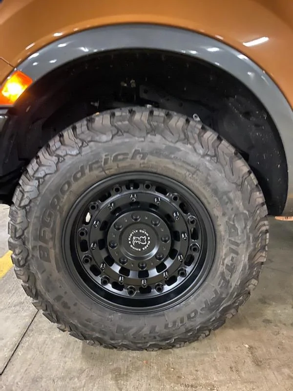

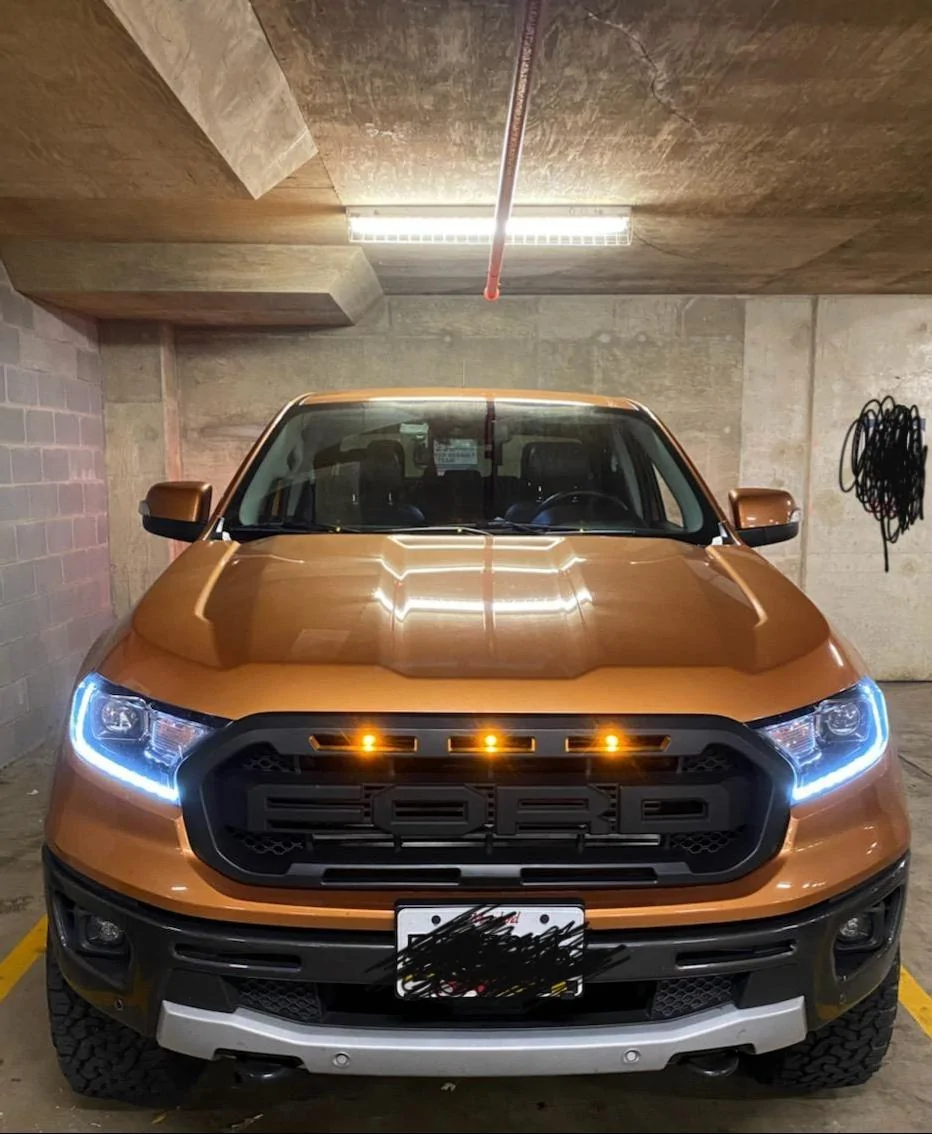

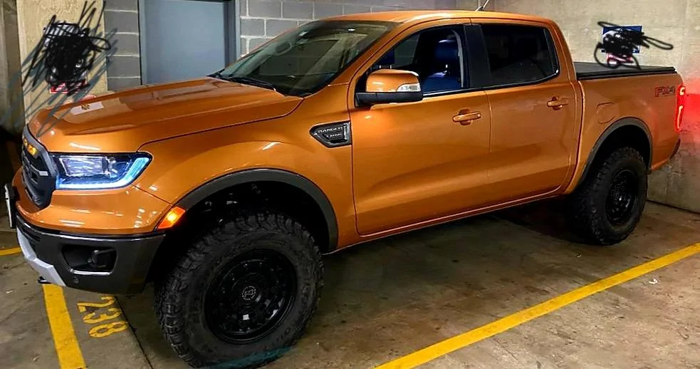

Just finished getting the new wheels and tires put on. I installed the grill and suspension on my own. Fairly straight forward job and this new look gives it a more aggressive appearance with the wider stance on the tires.
Fox 2.0 suspension and raptor grill were brought through stage3motorsports.
Wheels are Black Rhino Arsenal in textured black
Tires are KO2, 285/70/17.
The crash bars had to be trimmed a little in the front to make the clearance for the tires

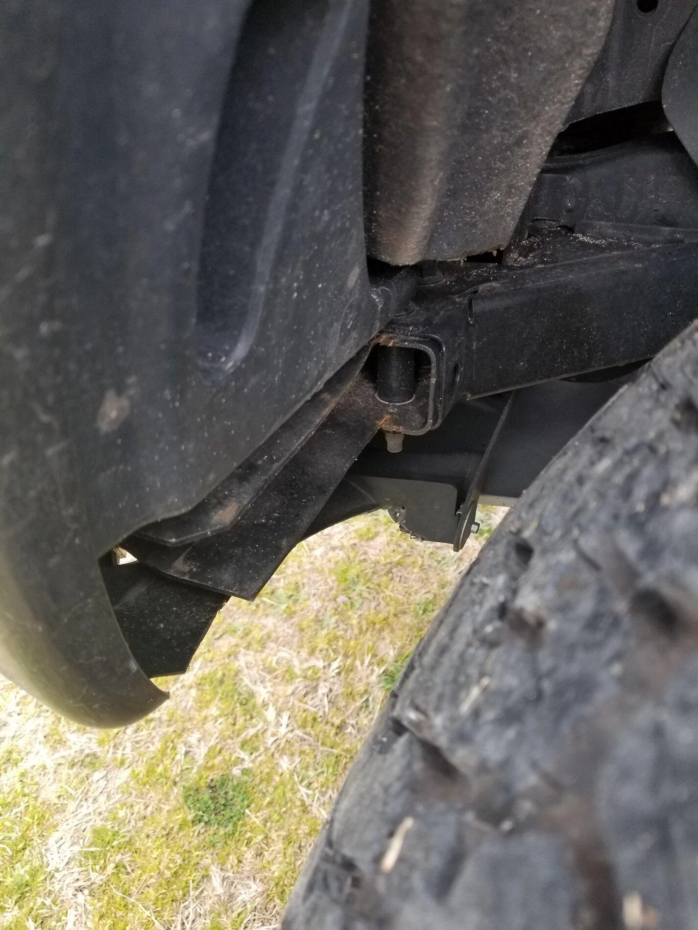

I had to trim some of the plastic around the front wheels and cut the front crash bars a little. I was able to keep the majority of the crash bar. It doesnt have any rub with normal driving but I took it off road and on a bigger bump the front wheel will touch the plastic guard in the well but it doesnt interfere with the driving

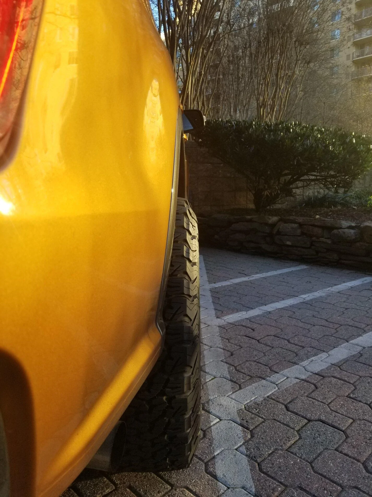

nice truck, which offset did you get? Also do you have a shot that shows how much they poke out from the fender?

If you go with a lift higher than 3 inches you should be fine without having to trim much. But if you do the same suspension as me than you'll need to trim the back side of the crash bars on the front side so the tires aren't rubbing. There is also some plastic near the bottom of the wheel well, just under the crash bar, that had to be trimmed.

I’m surprised how far they poke out with 12 offset. I guess it’s because it’s a 17x9.5 wheel.
it’s honestly a little further out than I am shooting for but I bought a 8.5” wheel so I’m guessing that will pull the sidewall in a bit.
