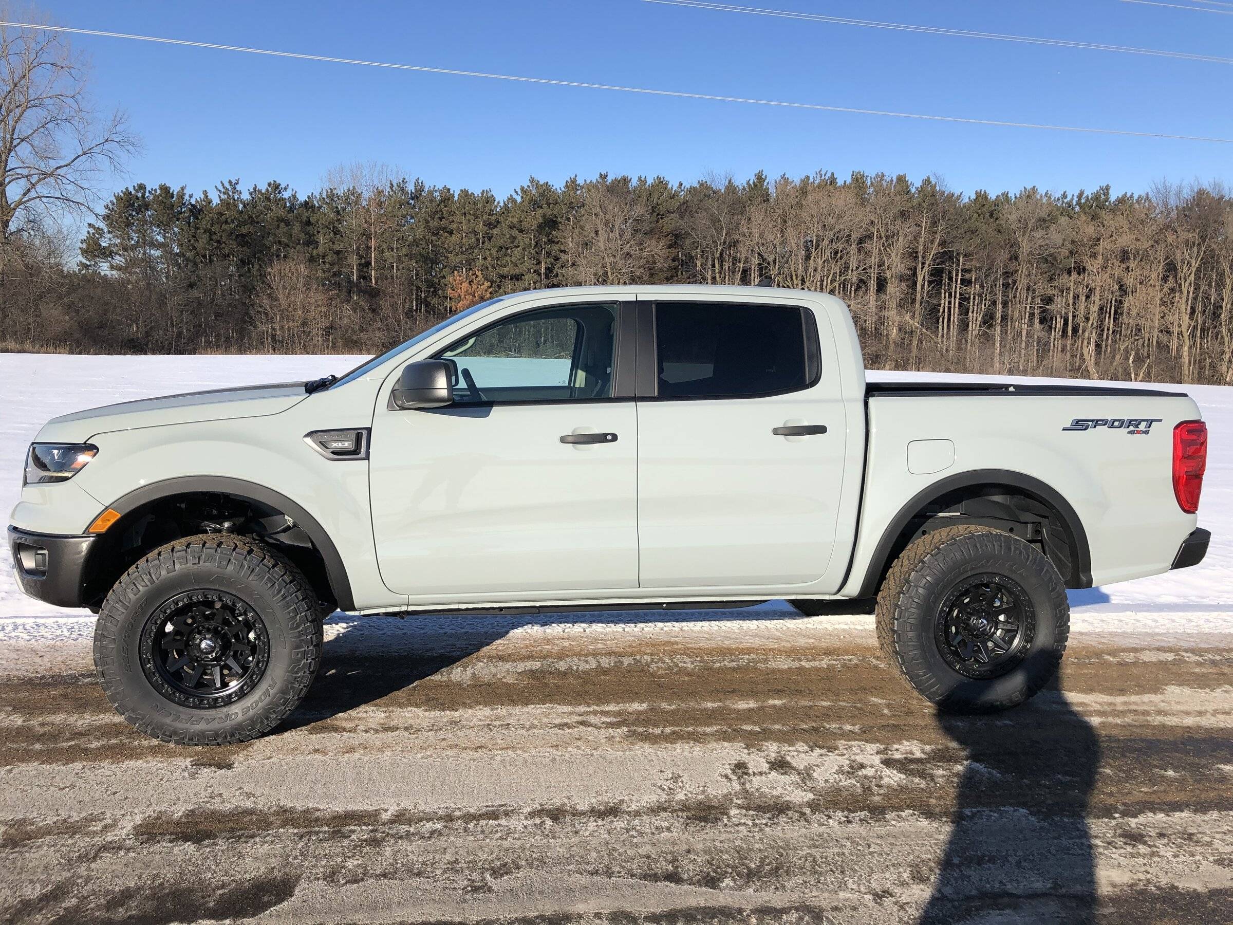

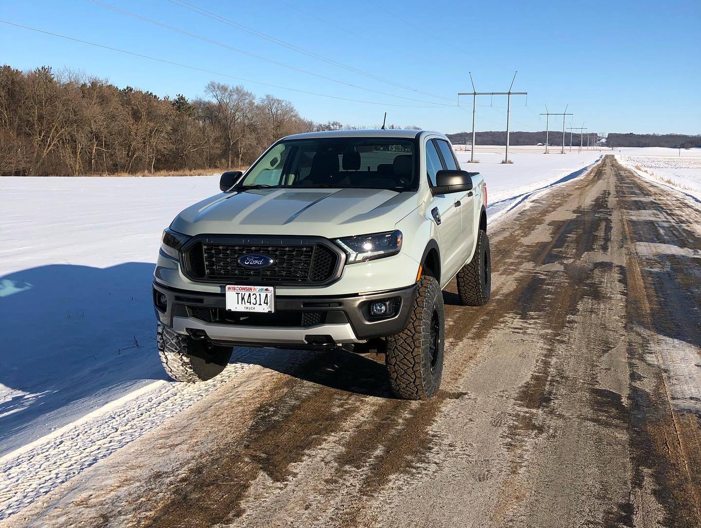

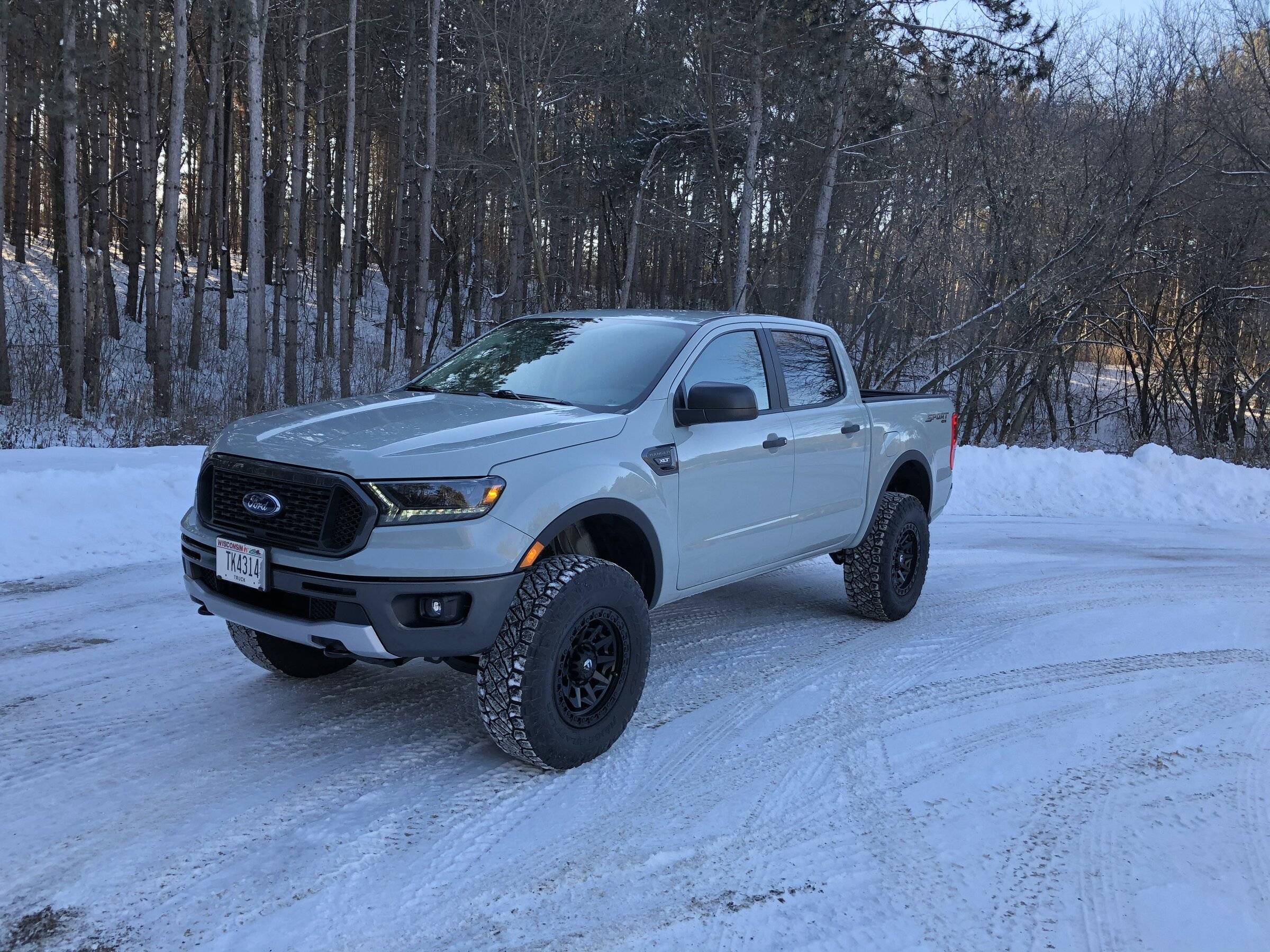

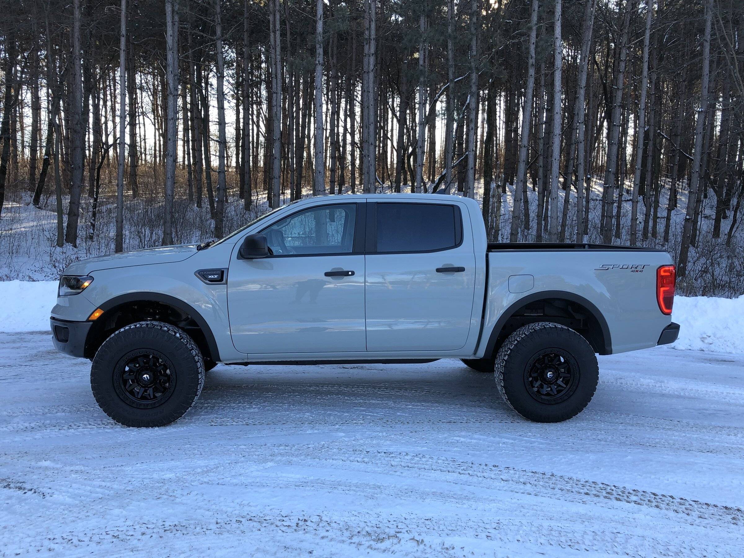

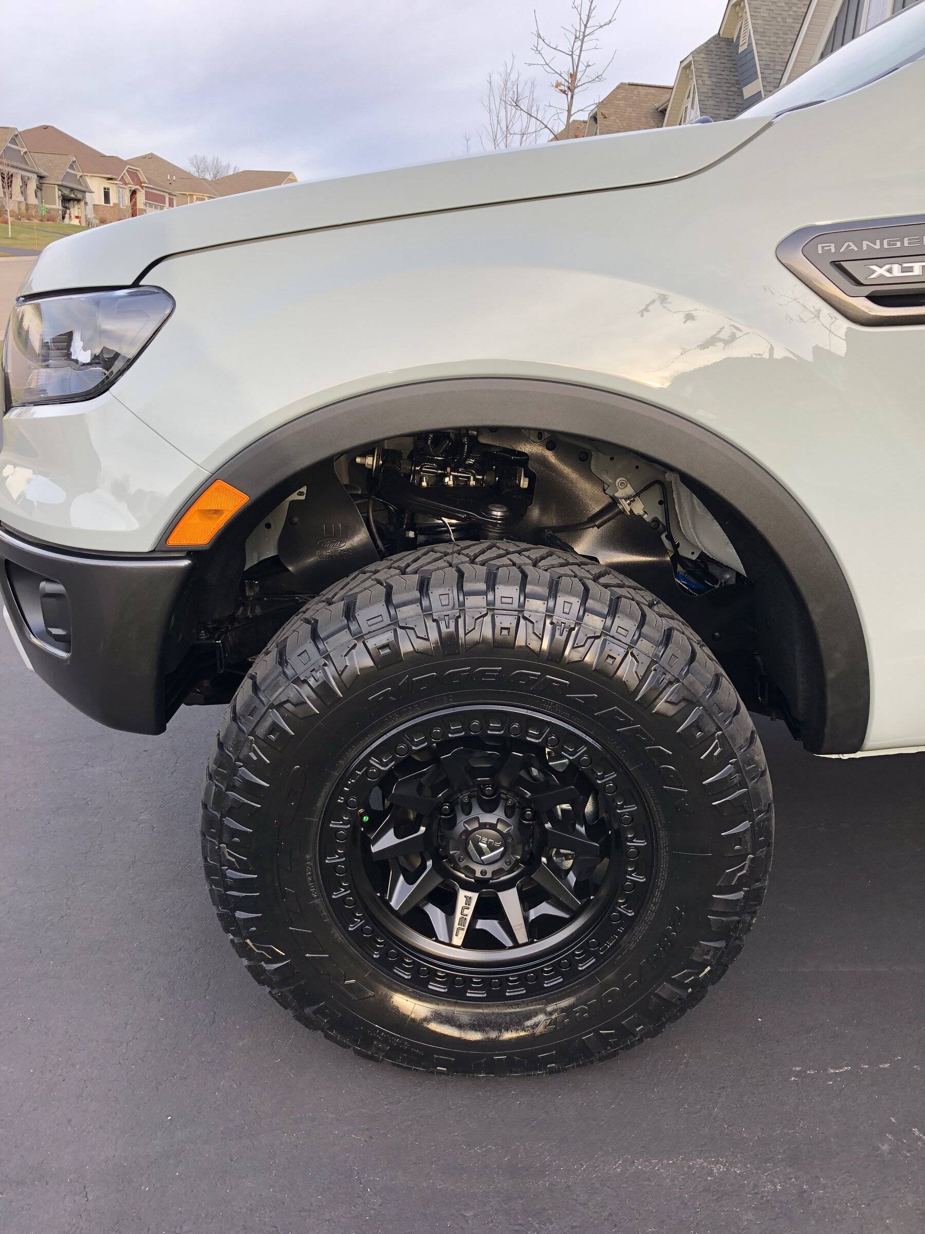

Hey guys, not really the one to post but I did a lot of reading on these forums when deciding which tire/wheel setup to go with so here’s mine.
Readylift SST 3” front / 1” rear lift kit
Readylift high clearance intrusion bars
Fuel covert 17x8.5 +12
Ridge grapplers 285/70
Let me know if you have any questions.

Notice any vibrations or grind in 4wd going up 3" Seems like its a mixed bag of ppl saying to drop the diff with a kit from Peak or BDS but also see/ hear of plenty 3" kits and ppl having no issues. I get the prolonged wear part, just a given of going up. Any plans to do uca's? Have the same truck and about to go up 3", looks sharp! Had those same wheels on my last truck too.

Thanks man. Haven’t noticed vibrations but it does feel different when I turn all the way in 4wd vs 2wd. There is absolutely no rubbing though so Idk what it is. I do plan to do UCA’s soon. Enjoy going up 3”, I think 3-3.5 is perfect for this truck

Cool thanks for the details. I got the diff drop parts just in case but was curious of some real world experience since my setup will be super close to yours.
