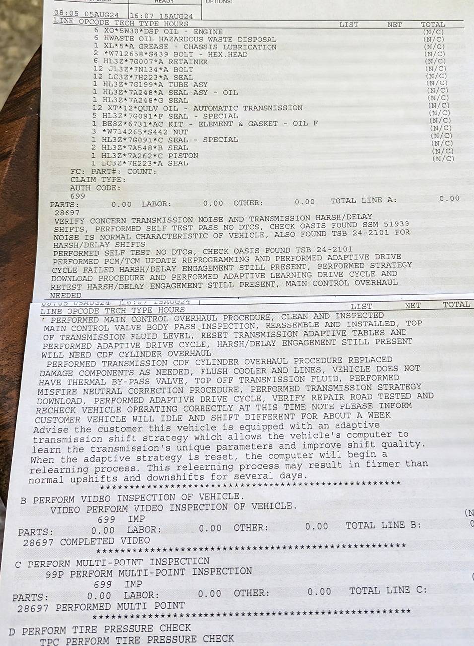

Update:
Complete trans main control was needed & done at Fairfield Ford who all were excellent! See attached N/C invoice. So if your young un is stumblin', rumblin' & bumblin' get it to the shop now to save 6k+ if you wait!
Thanks to those in this thread who offered advice

Update:
They also did the CDF drum replacement which was the root cause of your issues.

Cool that you got it done for free.99.
I hope you have all issues solved, which you should with this level of work.

Update August 30th: the procedures outlined in the service report above have solved nothing. Still hesitating and bucking between 12 and 1500 RPM. Back into the shop on the 5th. Fairfield Ford continues to be very accommodating with it. More to follow.

You may have a bad DPFE EGR pressure sensor. It will cause bucking when it is bad. It is a fairly inexpensive fix.
airline tech
Aug 24, 2022
4,499
8,592
Midwest - KS
Aircraft Tech
I have to agree here - DPFE Sensor will most likely fix the issue, this goes to show how the transmission and the EGR can give similar drivability issues- and without knowing how the DPFE symptoms show and what to look for in a Live Data drive you can miss it - as this is a no code symptom.
There needs to be a GSB or TSB written on this to highlight to all Ford Techs, look at this because without a code giving direction it will be overlooked, no code - no problem.
We have a few Ford Techs on here who I imagine gained the knowledge of the DPFE bucking issues from this Forum or they have encountered it in another trouble shoot issue on another model, the manuals only direct you to replace it when it codes, so a tech must think outside the box for this issue.
Most on here who have replaced it - it was a shot gunned part and they were successful.

Update September 10th 2024.
Got my truck back out of the shop yesterday. They tested and found a faulty DPFE sensor. Part and labor not under warranty but my dealer worked with Ford to get it done since it was just after the transmission warranty work. So far so good all bucking and hesitation remedied. Knock on wood.
Thanks to those who chimed in with info on my issues.
