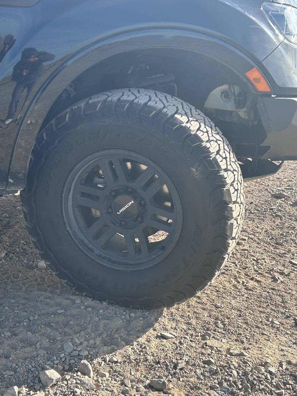

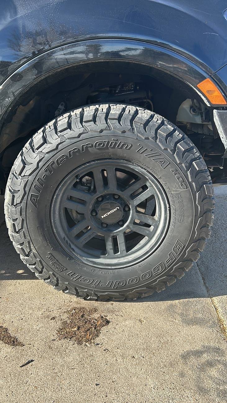

Hey whats up i just recently swapped my tires to 295/70/17 from 285/70/17 and not gonna lie it gave me a little more contact surface im just worried that i might need to re gear anyone here have 295/70/17? I

Do you have clearance when you rock the truck while turning? If not you may have to install ReadyLift intrusion bars. Changing the differential gears is a whole other issue. Good luck.

There’s some glare in the photo but it looks like he might have already removed his OEM crash bars.
Joseph, did you?
Joseph, did you?
Sorry for the late reply and yes i did cut the crash bars and trimmed the fender liners to mitigate the rubbing so far no rub on these 295s on 2 inch lift and +18 offset wheels
