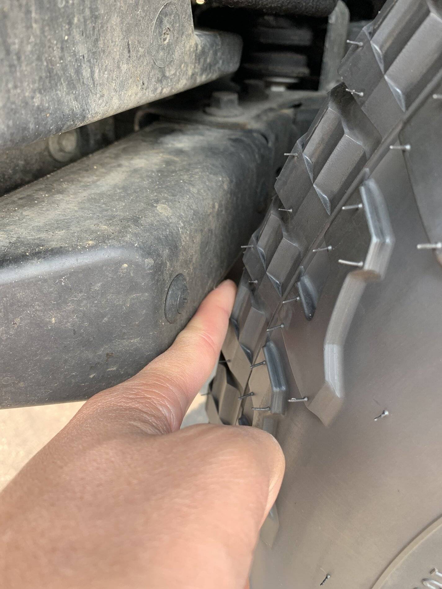

Make note that you can loosen the crash bars and adjust them a little if you have minor rubbing.
