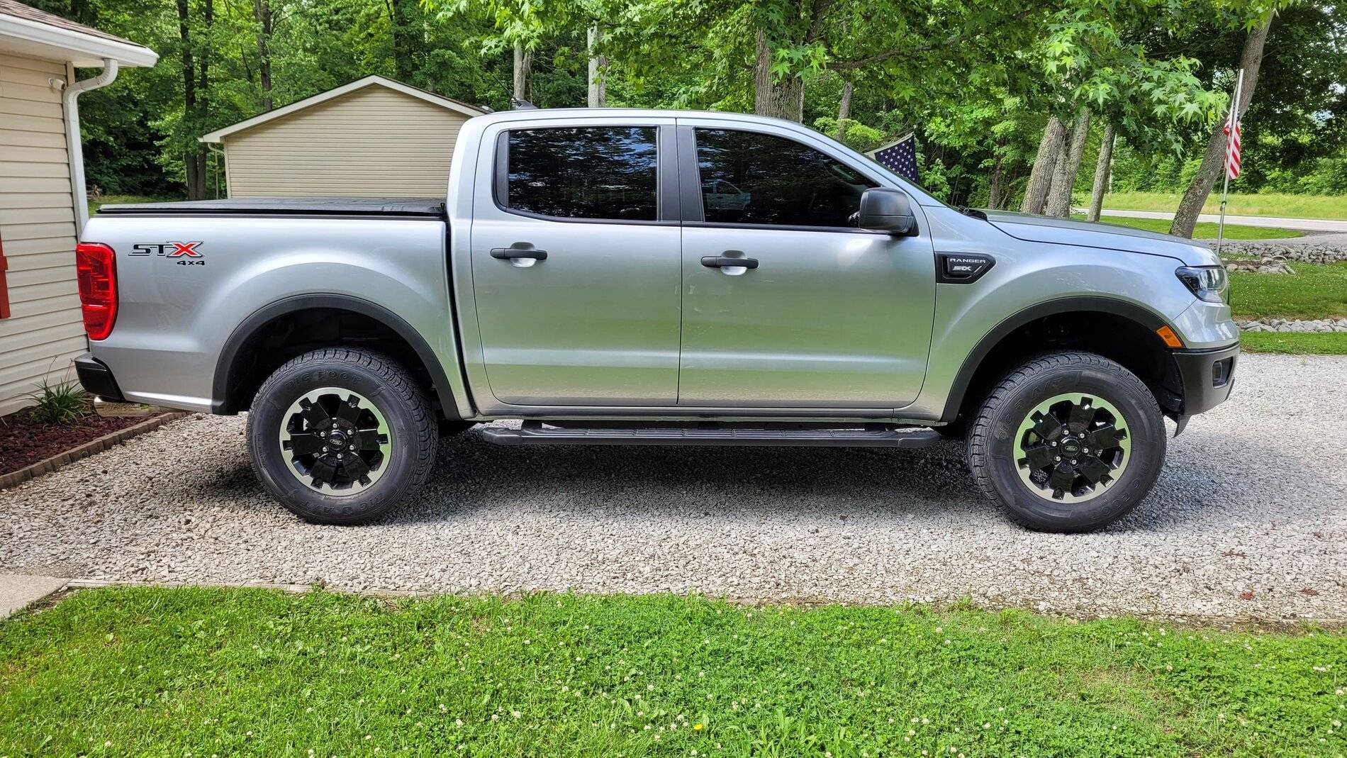

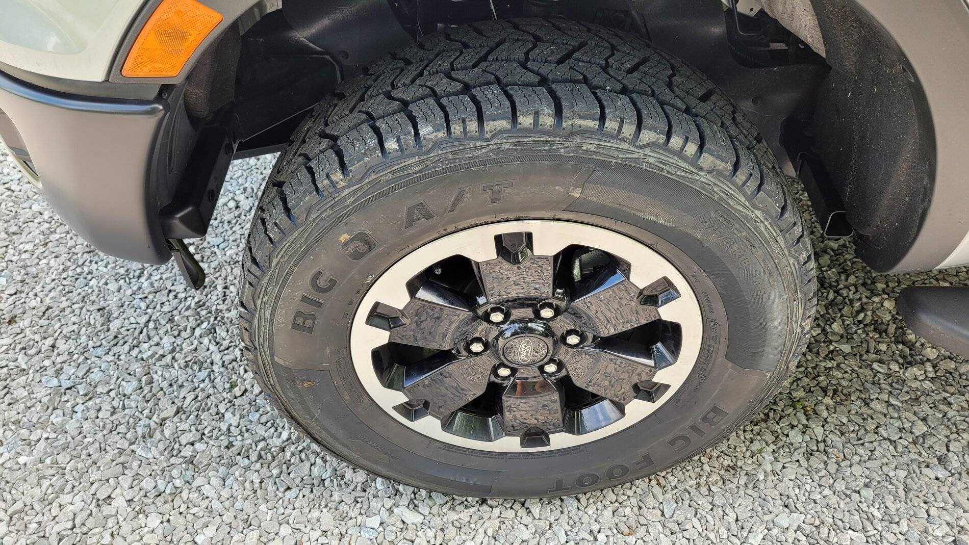

2021 Ranger STX
I've got a rough country 2.5 coilovers with 275/65/r18 and they fit great. The 275/70 might work ok but I was worried about the tires being too close and mud, snow, ect building up. I wasn't going to remove the crash bars, to me that's an important safety item and I'm going to keep them.

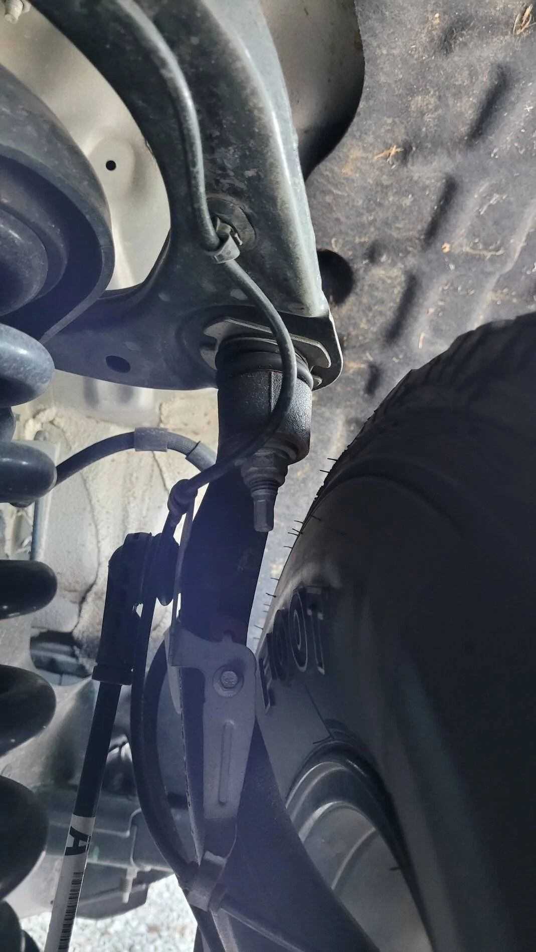

2021 Ranger STX
has your experience changed much?Still full clearance with no rubbing issues? Also are the stock stx rims +55 offset as the 18” black appearance pkg rims? Just wondering because i still cant decide on 265/70/18 or 275/65/18
No problems and no rubbing. Idk about the rims. It's a little tight on the back side but again no problems.

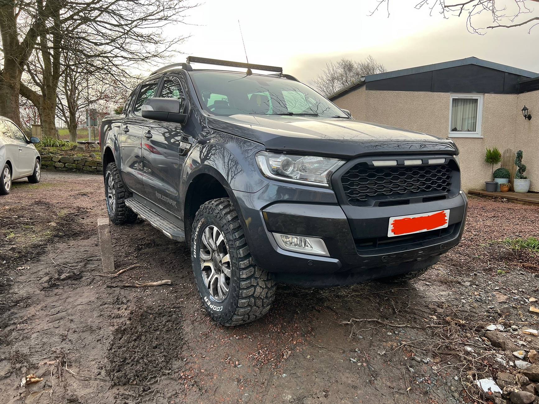

mechanic
I fitted 275/70/r18 cooper stt pros to my 2016 ranger with a simple spacer type 2” lift kit and they fit nice ? no rubbing at all although I haven’t done any serious off roading yet ?
