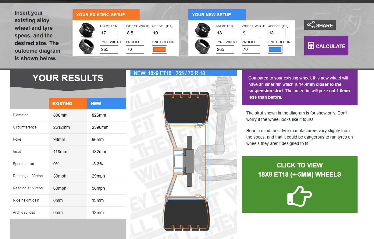

Here's a good reference for you.
If my math is correct, your poke would be approximately -2mm less than below. (Obviously dependent on tire tread pattern, side wall design, and such.)
Mine: 265/70r17 on a 17x8.5 +10mm wheel
Yours: 265/70r18 on a 18x9 +18mm wheel
If you want to do some further comparison, check out "Will They Fit"
