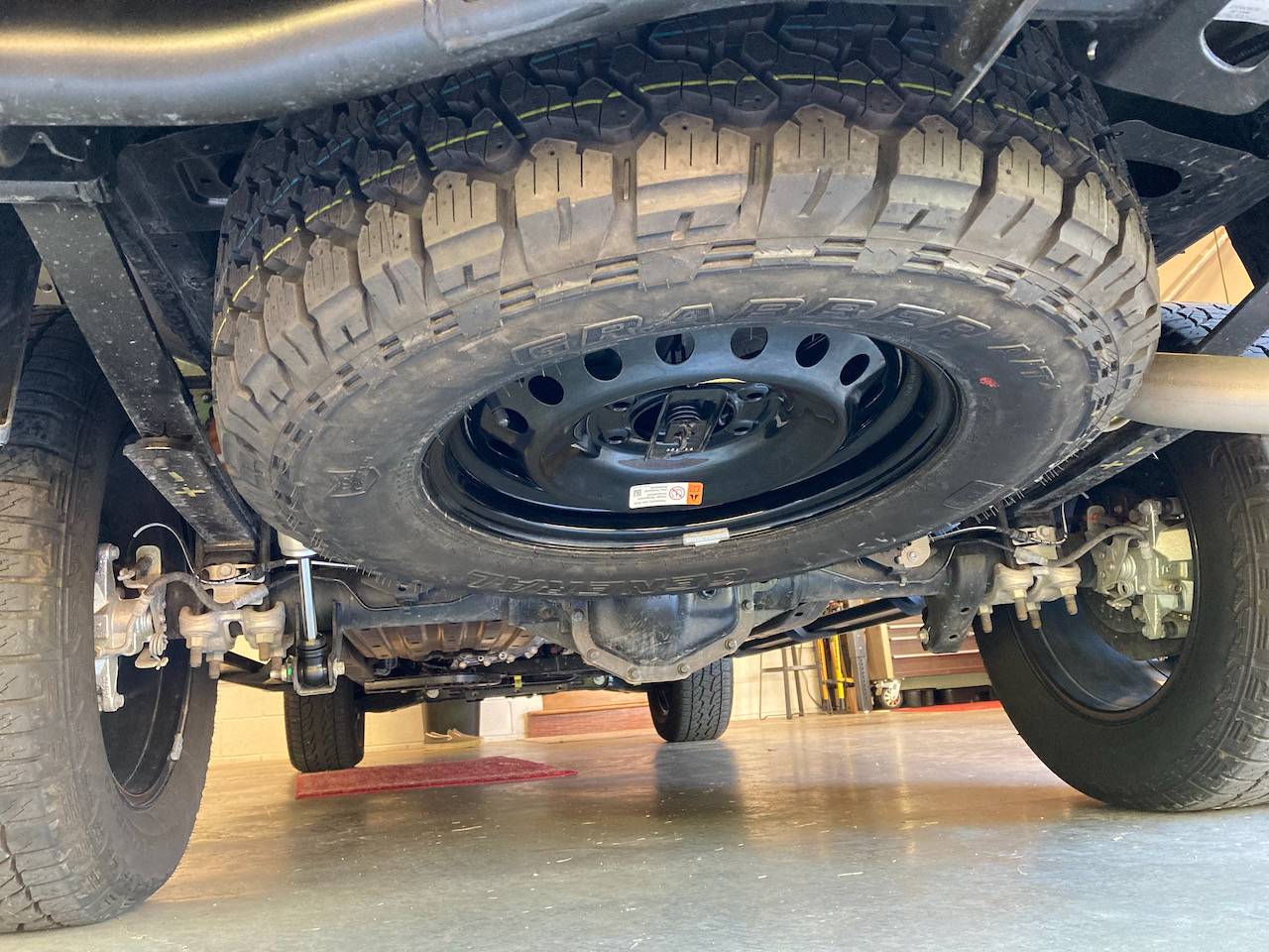

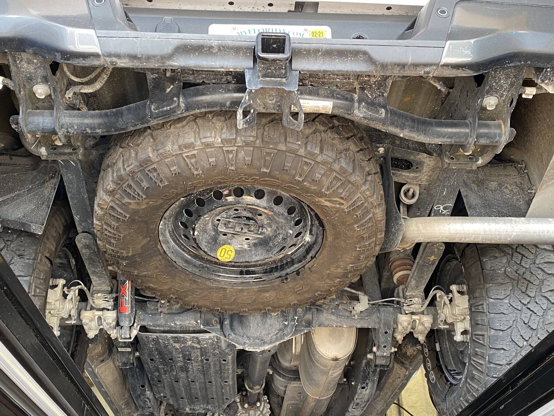

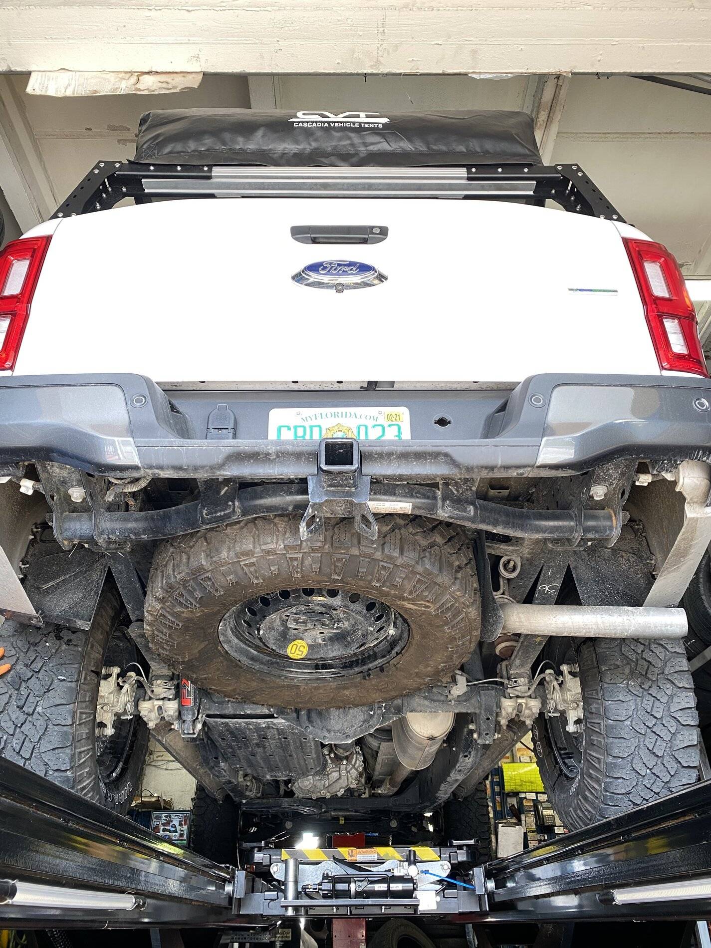

I can confirm it fits.
Currently have one on a Sport rim under the truck

Like the others have said it fits and remember to flip the valve stem so it's facing the outside.

You’ll have no problem. I currently have my spare with a 285/70/17 from my brothers Ram Power Wagon.
