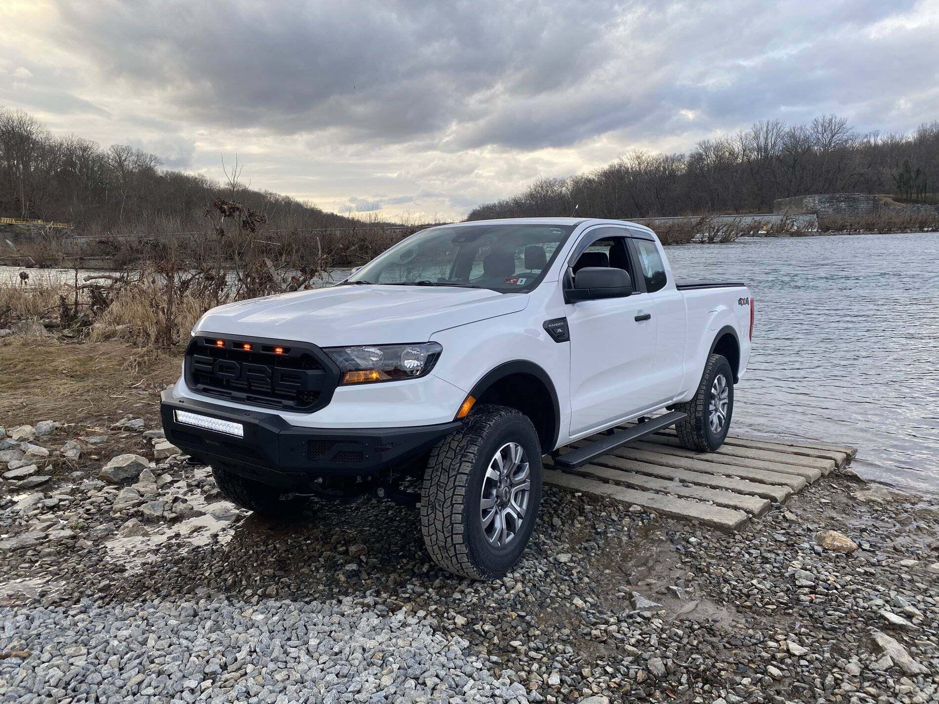

I ran 265/70r18 on the stock 18 wheels without spacers and had no issues with rubbing.

Is that the current setup in your profile pic??
