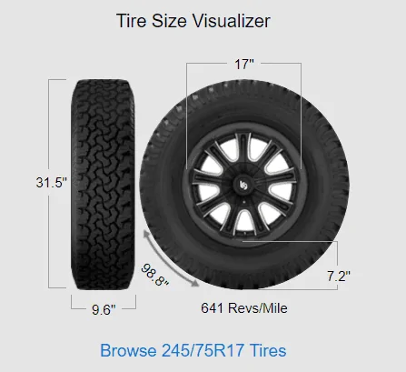

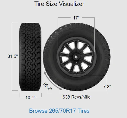

I alway's like comparing the perspective of the tires.

I see some things to think about tires are there weight and are they three ply or two ply for side wall strength if you are off roading.

Using the same diameter but taking 20 mm of the width will have little notable difference on performance given everything else equal.
Changing to a Wildpeak vs whatever tire you have now, will be more noticeable than 9% tread width change.
