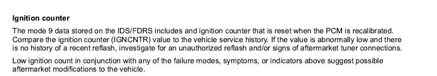

If you Google -GSB 22-7077, Published May 23, 2022
It provides a detailed direction for the Ford Technician, with regard to warranty issues and tunes.
This is the main clue that they will look at, if needed. The GSB does not direct any further except checking DTC codes on the software side of it.
The rest of the inspections are damage inspections of parts and visible install or modification of parts.
It is a very informative documentation.
If you read through the GSB, it is ALL about denying warranty.
So, this means that those who reflash back to stock prior to dealer visit, this will be seen.
They do not mention it here, but I am sure there are other ways to detect such as PCM flash counter.
I am sure if the dealer suspects a tune, and you are looking for it to be covered under warranty, they will dig deeper into the software programming and look for clues.
I view it this way, If the Tune caused the failure and it was not on the approved Tune list then the owner eats the cost.
However, proving the Tune caused it, is not something the Dealer and Or Ford is going to do, if there is evidence of a tune, they are going to take the easy way out and say unauthorized tune installed, warranty denied.
BUT this is all dependent on What Failed, The Tech, The Dealer and then Ford.

Almost sounds like you could get away with it if you tuned the truck right off the lot.
But when you remove the tune to claim warranty repair won't it reset the ignition counter?
The longer the tune was there before removal the more obvious it would be?
MountainGoat
Dec 5, 2020
2,346
7,065
Missouri
2020 Ranger XLT Sport 4x4
Don't remove it, just tell them it's the Ford Tune (Livernois), leave it in, fake some paperwork. Hell you can even make an entry in the Fordpass app. Not much chance of it actually working but it's worth a shot. Unless you actually feel bad for poor Ford and don't want to be dishonest with them getting the lemon transmission fixed.
