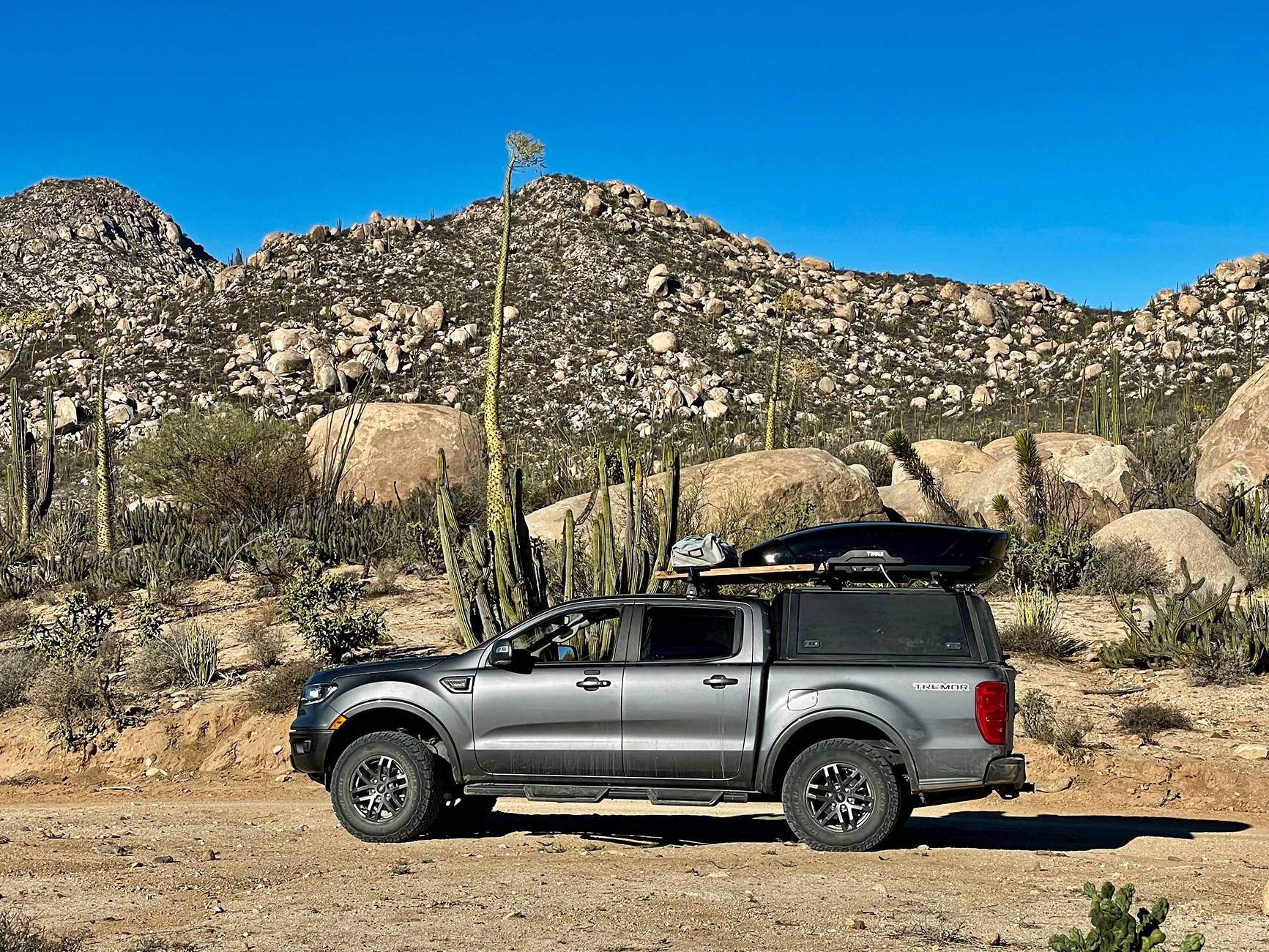

Happy new owner of a 2022 Tremor Ranger that carried me from MT to Baja as my main Baja vehicle because it's smaller, would haul a 23' dual axel Airstream occasionally AND get me deep into the back cactus forests and beaches I spend time searching for in Baja. Please understand that I am not a gear head and use my rig to get to places others can't but generally not just to see if I can do it... I am learning so be gentle...
I loaded it all up for the drive from MT and am sure it was overloaded (1885 payload?) Sold the trailer so no worries there.
I carried roughly 2000-2200 lbs counting: (could be 200lb low): RSI topper, (450lb) 1/2 bed slide (75 lb) camping equip for 2, (150lb). fishing and sports gear ( 200lb) tools/rescure/jack/ramps/additional fuel (400 LB). 65 ICECO solar cooler with food, battery, panels ( 150 lb) water for 2- 10 days (250Lb). misc gear 400. Never had power problem or breaking issues.
After traversing over 600+ miles on dirt/sand/rocks/wash boards... I never hit the underside on rocks but did have issues with surprise compression bumps at speed. The rear rubber shock tower bumper showed a bit of wear but No "damage" . I read in a post that the tower bumpers could be changed out for a stiffer one and that I could also add rear leaf spring. Will new rear leaf springs raise/level it more than the thickness of the leaf spring and cause me to do the whole leveling deal (remove crash bar, adjust electronic sensors, alignment, new shocks...) Is adding aher nnot
What is the best solution to increase Payload: air bags, a lift kit with stiffer shocks or rebuild suspension.
I don't feel like leveling is the answer (based on what I have read it's mostly for looks) so can I add leaf spring without "leveling" or doing a major suspension change? Thx. New Guy!

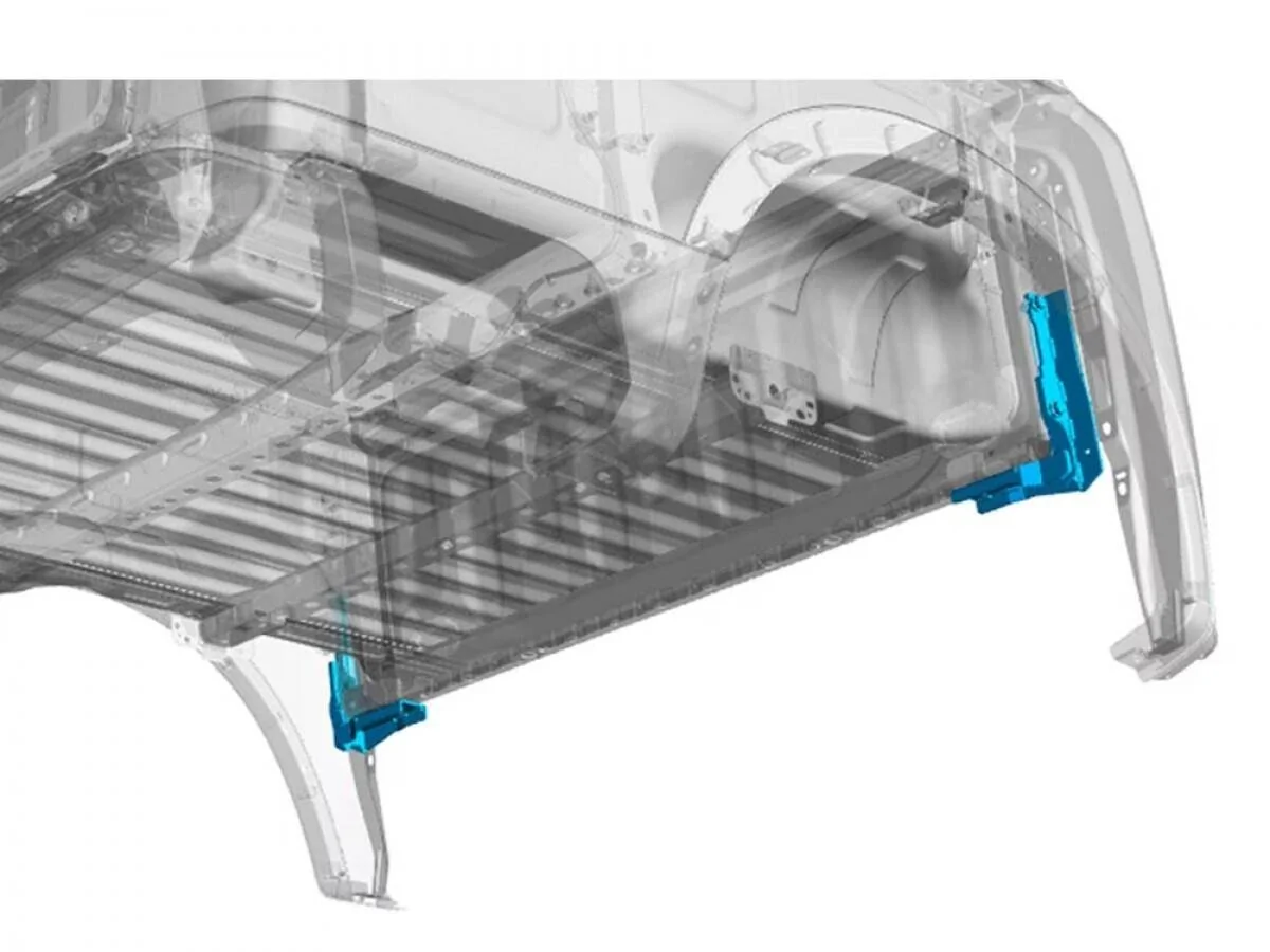

Others will have the answer to this, but would Footer benefit from those J-brace support things?
Not for added payload, but for potential issues with topper and above-rail weight?
Or do those only fit '24s and up?

thx for the feedback. I did her that the bed was slightly under conned for big loads on topper. I will check out the J brace. enjoy
